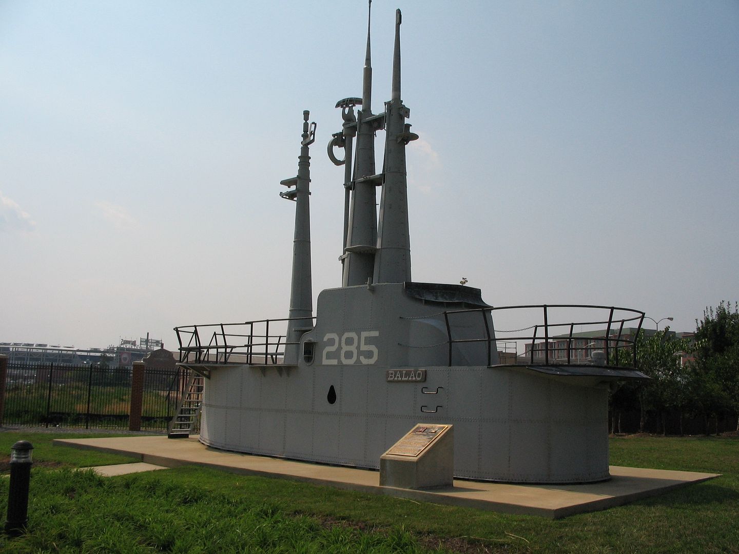

                  As for the current sail, I was thinking about making a small model out of it, similar to the Balao Memorial, that has the fairwater, bridge and masts on display (see below). That, I would definitely put in a small glass case, if I can find something that small.

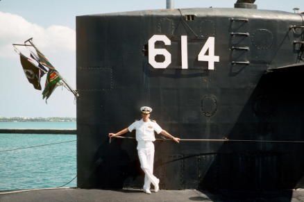

                              Ummmm, how to say this, after all of the work you have done...
                              I have never seen a hull number on a submarine sail in the upper location that you have on your model. Photos of that class show the number under the fairwater planes, more or less centered on the sail.
                              Below are some photos of Greenling when she had the sail number.

                                Well Tom, what can I say?
                                You scared me for a minute, and perhaps since I attached the number to the sail, I should have put it as you have shown. But you may recall the “Bermuda2” file that shows the removable numbers that I put on the detailed model shows the numbers in this location.
                                I just put them in the same location, not thinking that they would be in a different location when they were painted on. Oh well, I don’t think that I would have much luck removing them at this point since I already applied the Future. At least I have some justification for putting them where I did.
                                Thanks again for all of your help!
