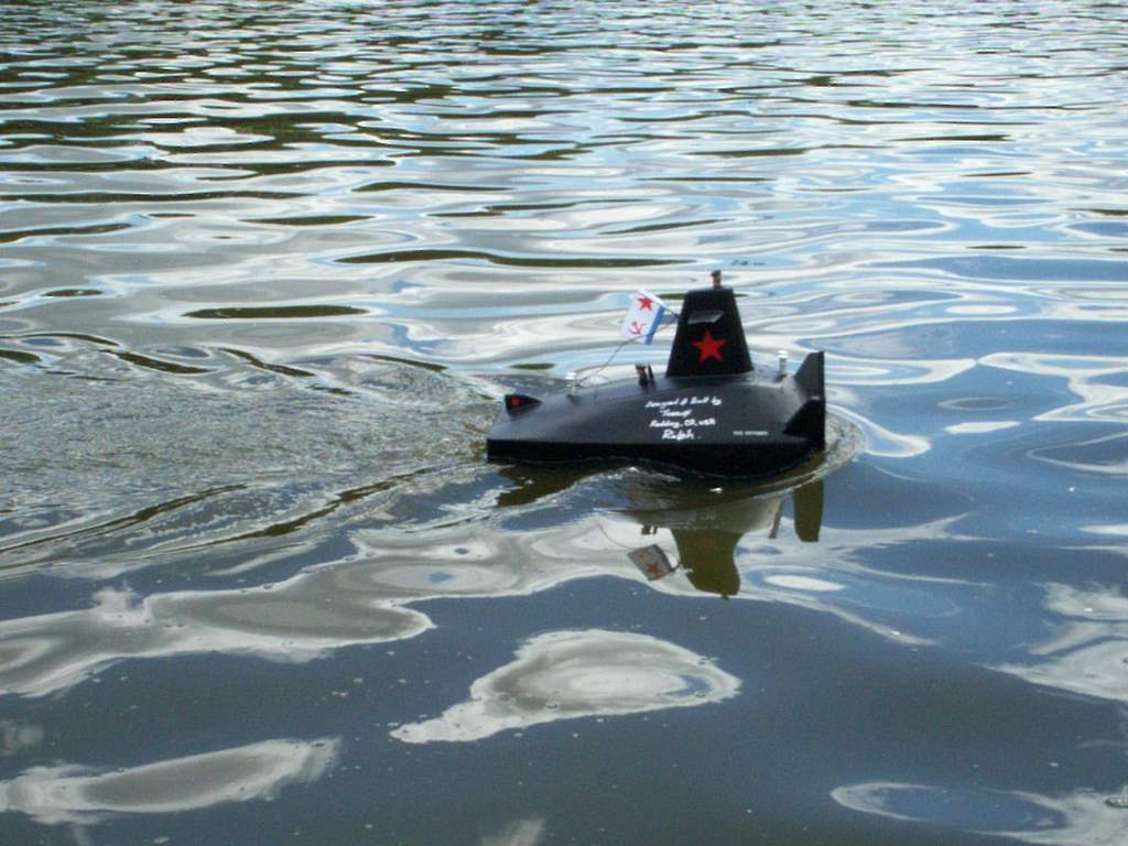

      Maybe a Springer would have
      Dave,
      Maybe a Springer would have been a better choice? We have the RED OKTOBER version next to a standard SPRINGER. The tow knees can be extended farther down and lined with rubber.
