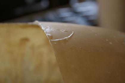

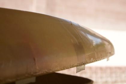

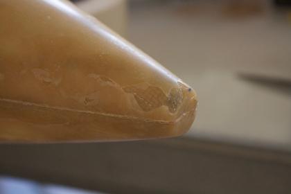

          Inspecting the hull There were many areas I would need to fix, but I consider this hull a learning hull. I never worked much with fiberglass and as I have hulls needed to be built that are, there is no better time than now to learn.

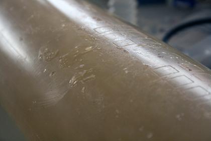

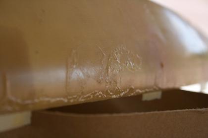

          Also there were pits and bubbles that will need to be addressed. As it is, I did not fill all the pits. It seemed every 100 I filled there were another 100 that popped up.
          The epoxy on the surface originally I tried sanding it out, but I found an edge of a file could knock off most of it.

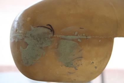

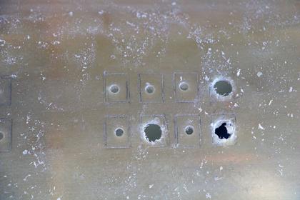

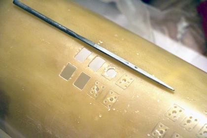

            Not different than most subs, it seems, there are a lot of flood holes. I have seen some just put a few big holes along the keel and be done with it (nothing wrong with it especially after working on this one). I choose not too. Again, learning as I go.
            I put several holes inside the squares that needed to be filed out Then began the process of filing.

            After I do not know how many I questioned my decision to file them out. So, I would work on 6 or so squares and take a break (like next day). Just small steps will eventually get me to the finish.

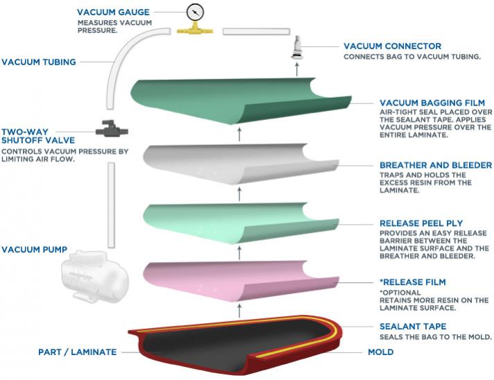

                      Ahhh, Ralph I know what you are talking about! (I think - is this it?)
                      From this site:
                      Fibre Glast is an AS9120B certified, leading supplier of fiberglass & composite materials. A source for Carbon Fiber, Kevlar, Fiberglass, Resin, Gel Coat & more
                        Ralph,
                        Ahh....I understand. It's a/the method for creating multiple lay-ups of glass cloth and epoxy. That's a technique worth remembering.
                        -many thanks,
                        Jeff
