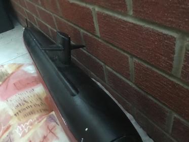

    Hi my name is PETER I am 15 years old and I have been into the hobby for 2 years I acquired this la submarine that I have half completed could any body give me a idea of what radio systems and dive systems to get

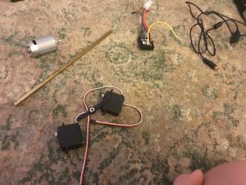

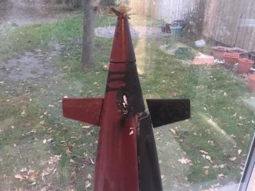

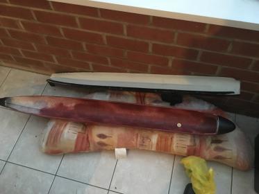

            Hi every one thanks for helping me
            I bought the sub from marks model bits http://www.modelboatbits.com/
            The sub is 53 long and 5 beam
            The dive planes on the sale are not functional

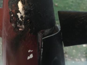

            The rear dive planes are in a mess after I tried my best to get them on with glue
            The propeller I was having a bit trouble with I will add some pictures in
            The top and bottom hull had a part I needed to saw which I got help of my grandad to do
            I’m not to sure how to fit the top hull with the bottom hull
            Also there is abit of a problem with the end of the top hull as it is slightly shorter than the bottom one
            I think I have put the Ruders in well but I’m still not sure I will also add photos of them
            I was able to get some radio gear that the man I bought the sub of said I should get
            Thank you for the advice

              Peter, Are you based in the USA or UK? I want to be sensitive to your location due to your age. However, there are groups across the world that we can get you in touch with. If you are in Europe or outside of the US, you have the benefit of 40MHz to use and they are still available!
              So, do not worry about a mess, that can be cleaned up later. Let us pick the first spot to work on, rudders.

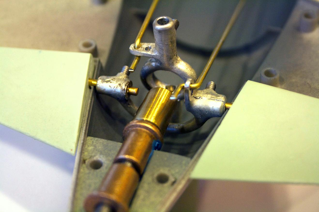

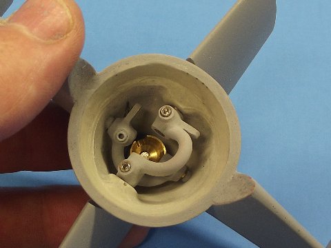

              Here is a picture of my Skipjack being built:
Name:	Skipjack aft workings.jpg

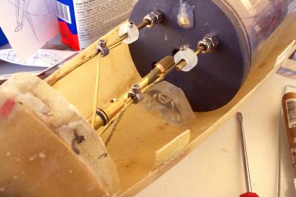

              or my Walrus:
Name:	Walrus Connectors.jpg

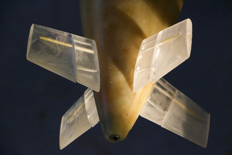

              or here is one, done by David Merriman for the Blueback:
              You might be seeing a pattern.....The shaft on most of these is 1/8" or about 3mm. A simple hole drilled through is sufficient (some may put a bearing in - could be as simple as a tube the shaft will slip into). My walrus is a x-tail, but an LA can be done the same where a horn is attached to each shaft and then a rod connects to it. The other examples show a different way (there is not a right way or wrong way). Now I have skipped a lot of information. Please tell us what you do not understand and we can further explain.
              Gluing parts on require some work, patience, and using the right glue. Do not use 5 minute epoxy. It will soften in use. CA (Cyanoacrylic) or super glue can be used, but the best is long curing epoxy of 1 hour or longer. You will need to prep the surface.
              If Sub-Driver forum was up I would point you to some of the builds there, but search here for LA builds or any sub. The planes, rudders, and prop are similar among the builds.

                  Looks like the dealer he got the boat from is UK based. I don't see it on their website; I was hoping to get some tech data from there.
                  It looks like the part of the hull that would cover the tail topside is missing?
