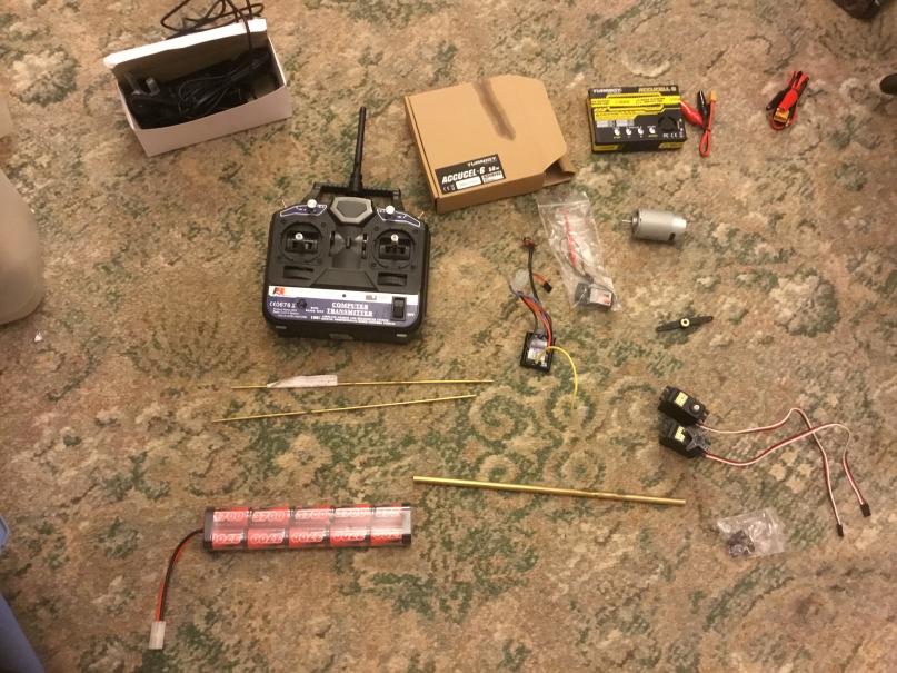

      How easy would it be to change from surface running to diving as maybe I could start of with a surface runner and then eventually get it to dive. What are the types of thing I need to make it run on the surface I have a few things already I will add a picture of them. Also what type of brass or metal should I use to get the connection to the rudder and to the prop
      Thank you

        These are the things I have

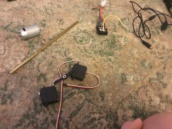

              Neither the rudder or planes are done how ever I do have some thing I believe are used for them I will add a picture Click image for larger version

ID:	132032. Also if I did decide to have it as a surface runner how easy would it be to eventually change it to a diving sub
              Thanks from PETER

                    Pete,
                    A couple of things:
                    • Can you confirm whether your radio is a 2.4GHz unit or something like a 40MHz unit? From the look of the antenna, it reminds me of a 2.4GHz radio....which would pose a bit of an issue for submerged operation.
                    • How many channels does your transmitter and receiver support?
                    • It looks like you have 2 servos. That would suffice for the rudder and the stern planes. Depending on what you choose to eventually use as a ballast system, you may need more.
                    • Whether you start as a surface runner or go straight into building a diving sub, you will need something to enclose the electronics, motor, and (preferably) the battery. There are two basic techniques to do this. The first is to build the waterproof area directly into the bottom hull. The other is to use a tube that sits inside the hull and is typically removable. The tube would have encapsulated that themselves removable.
                    • Can you tell us what kind of motor you have? It would be useful to know voltage rating and RPMs.
                    • You will need some sort of "shaft seals" that will allow you to run the servo pushrods and motor shaft out of the dry space and into the water.
                    This is sure to generate additional questions and dialogue, so please keep them coming and we'll continue to provide what help we can.
