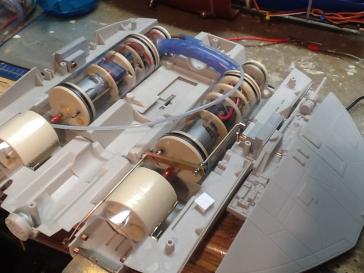

      As a matter of fact I got the linkages to work but not well.
      Too much slop. O well!
      More design changes. O boy!BDClick image for larger version

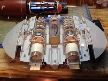

        #78
        I redisigned the linkages and added braces to fix the slop.
        I got rid of 80%.
        Enough to test the system at the fun run this month.
        I am uploading a video now of the system working. BDClick image for larger version
