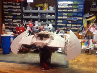

                            #73
                            I got the bearings in so the wings can swivel.
                            Just have to make the linkage.
                            They will not swivel this far but it gives you an idea of how it looks. BDClick image for larger version
                              #74
                              I see a question coming..........
                              With all that wing tip area pushing against the water while moving, will the main body have enough effective counter pressure to keep the main body from turning instead of the wing tips?
                                #75
                                Good question.
                                I don't know.
                                I guess we will find out. Lol BD
