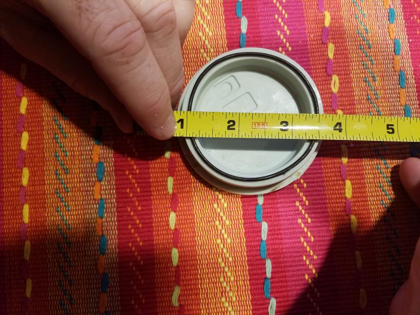

    As far as ordering new Buna-N O-rings, lets say the original sub-driver O-ring cross section ends up being say 1/16 of an inch in diameter, not sure if I should enlarge by a full or half 1/16th. So go with a cross section of 1/8th or 3/32. The other question is should I keep the original inner diameter or outer diameter? I am also wondering how much I should enlarge the grooves to accept the new rings. I imagine there would be manufacturer specifications listed with the rings that shoudl be followed.
    Mike,
    I would not double the diameter of the o-ring cross section....unless we're also talking about modifying the end cap. You also should try to keep the O.D. of the o-ring itself as close the that of the original o-ring.

      I believe I have narrowed the o-ring down to a 2 3/4" OD with 1/16" cross section. With that in mind, I would go with the same diameter and a 3/32 cross section which is listed as a #145 o-ring. If I want it by this Saturday, I might get lucky and find it at a Grainger, or similar place. Amazon only in 50 packs, with a 2 week shipping time... Click image for larger version

        Wow, I swear I am not an idiot. I am looking at my very own picture, and somehow got the size wrong. Clearly that is a 2 1/2" wide O-ring. So I need a number 141.
