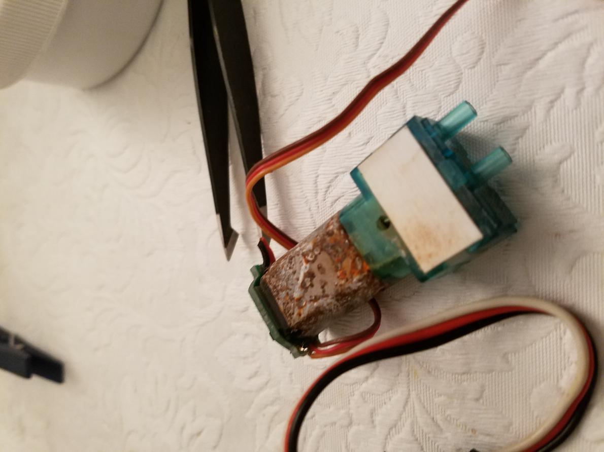

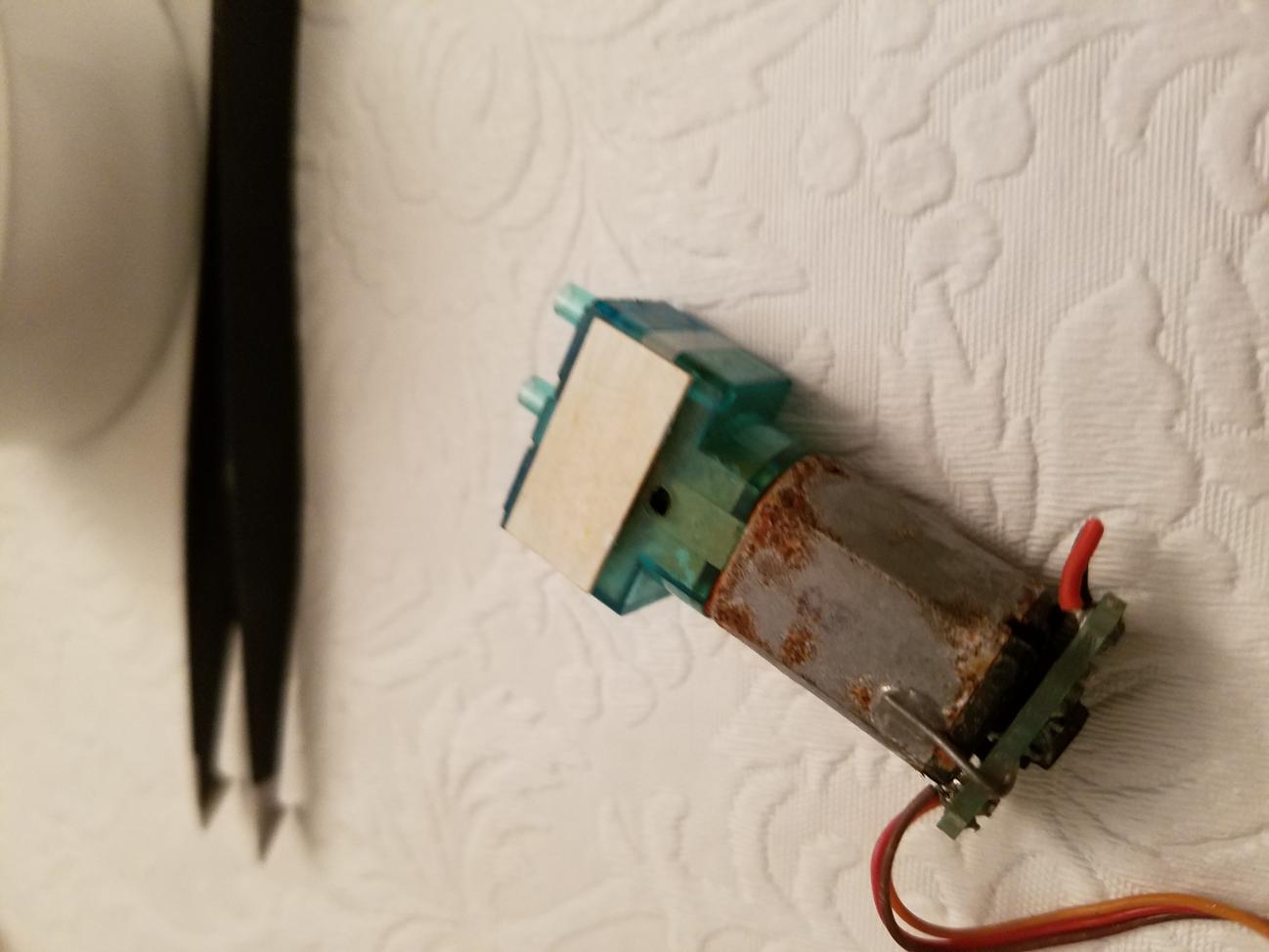

      I recently had my ballast pump burn out at a pool run in Shrewsberry. It looks like the cause is the repeated partial flooding in the WTC. I've had a lot of leak problems over the past few months, and while I am certain most of the issues are of my own making, I would like to move on to a new system.
      In the meantime, I would still like to use the sub. While talking with everyone at SubcomEast, the possibility of doing away with the snorkel system and retrofitting the WTC to a pure gas system was brought up. I feel like that might be a very good option, but I need to figure out a few things before I jump on the retro.
      I have never been able to 100 percent isolate the leaks. There was a leak coming from the forward end cap due to a weak seal, however using Teflon tape between the cap and the O-ring seems to have effectively stopped that. There had been a small leak coming through the port I ran the antenna through but that has been solved as well. I have done a bunch of leak testing, and I believe wherever it is leaking from is not repeatable with how I am doing the tests. It might be a depth issue, or odd angle, or even a combination of movements at the same time.
      So my current plan involves the following:
      Completely dissemble the unit, and replace all of the end cap and bulkhead O rings with wider ones, after having milled out the seats to accept larger seals.
      Check all servo seals and replace when necessary.
      Remove all of the snorkel system components and seal off the ports.
      Replace the emergency gas tank with a full sized tank.
      Pick up a bunch of fireworks on the way home from next build day.
      I will need to figure out what size O-rings to get for both the end caps as well as the servo seals. I also need to figure out where to get an older style gas tank as I know they have fallen out of favor with the community.Click image for larger version
