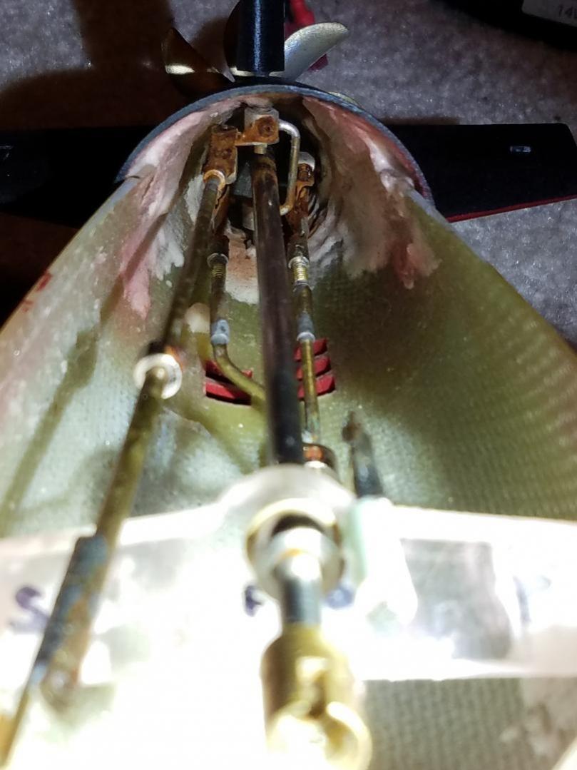

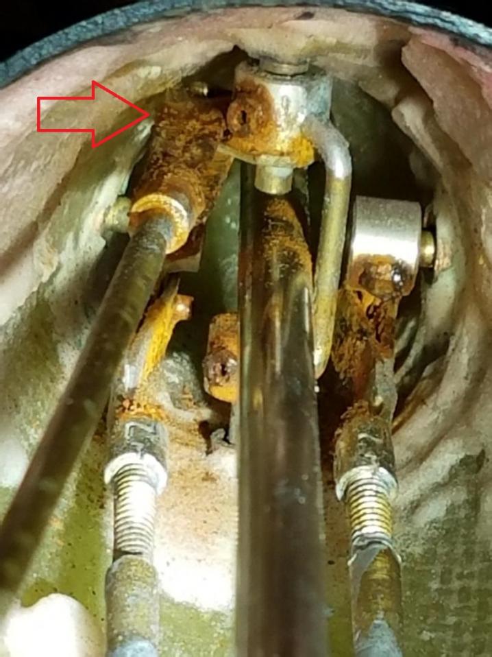

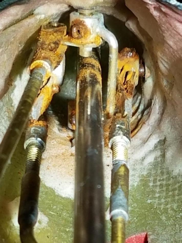

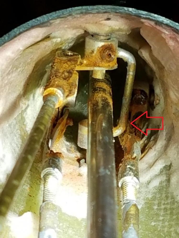

                      Can anyone offers suggestions about what I should do about the rudder and aft plane linkages? The are pretty rusty, and there is a lot of contact and binding going on back there. I have a feeling its going to require cutting into the hull or just learning to live with it. The biggest issues I am running into is the yoke controlling the rudder is constantly making contact with either the plane collar or connecting linkage. There is also a lot of binding in general going on with the planes. The rudder yoke is also making contact with the hull at certain angles. From what I can tell it looks like the collars are not stainless as well as the connections. Its very tight int there so I do not think I can out right replace anything without cutting into the hull

                        A bit of a mess you have, but most likely salvageable. Avoid hacking the parts, because you'll almost certainly damage the rest of the hull, and that will mean even more work Looks like the collars are brass, but the grub screws are steel. They will have expanded inside the threads, and will be difficult to remove as is.
                        If you have a dremel, I would use a very small rotary wire brush and tryb and clean as much of the rust off as possible, remove the linkage rods to assist with access.
                        You can then try applying some penetrating oil, but it may not be sufficient, and you may not be able to get an allen key in to get some crank on the grub screws. Do not be tempted to try and remove the grub screws as they are.
                        Another method to clean up rusty parts is to use electrolytic rust removal. Sounds very technical, but you only need basic stuff to do it, and it works very well. I tend to use it on old car parts that are difficult to de-rust using standard mechanical methods, and it is able to get inside threads, and delicate areas, without being destructive.

                              It's the phosphoric acid in coca-cola that de-rusts. I think in this instance the electrolytic technique will work faster and it's easy and cheap- you just need a small power supply and some washing soda and a sacrificial anode.
                              I agree that the hex sockets maybe too far gone to get any grip with a key, but you may be okay. Can only see once the rust has been cleaned back.
