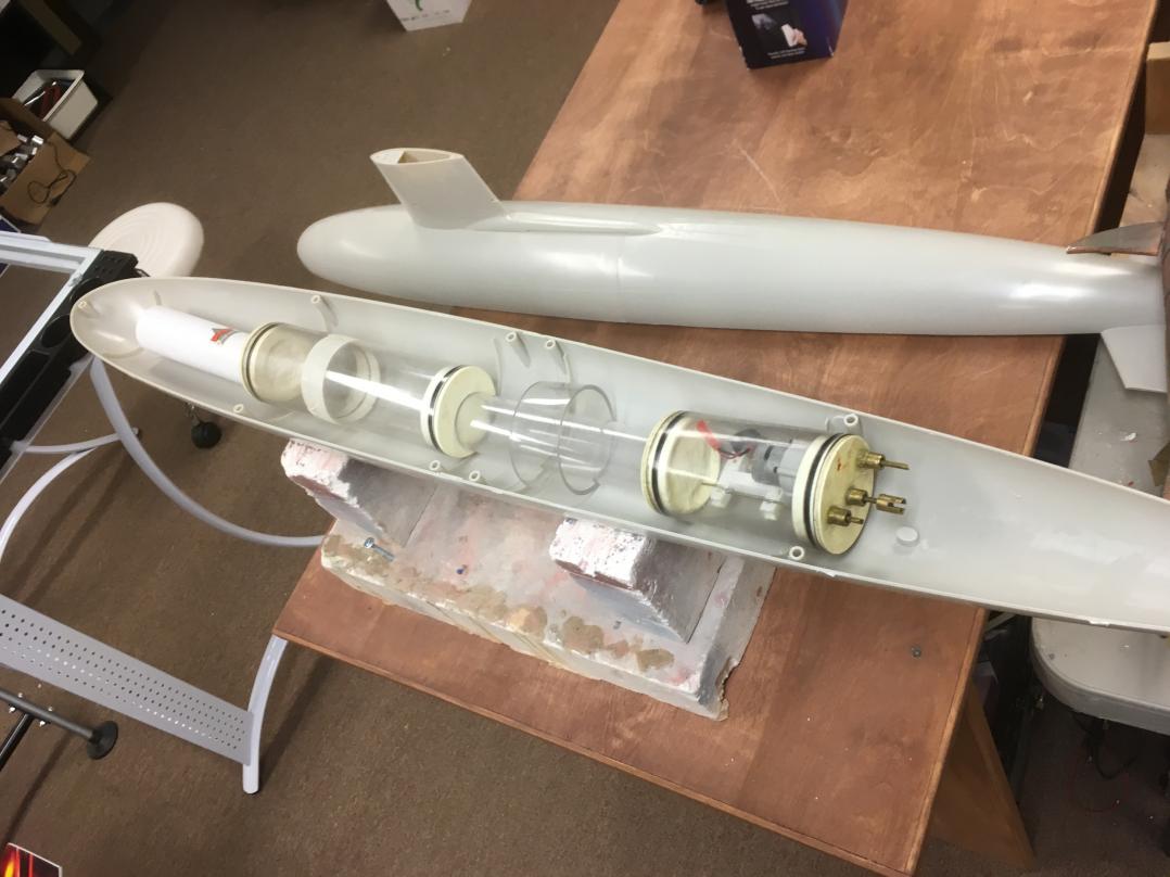

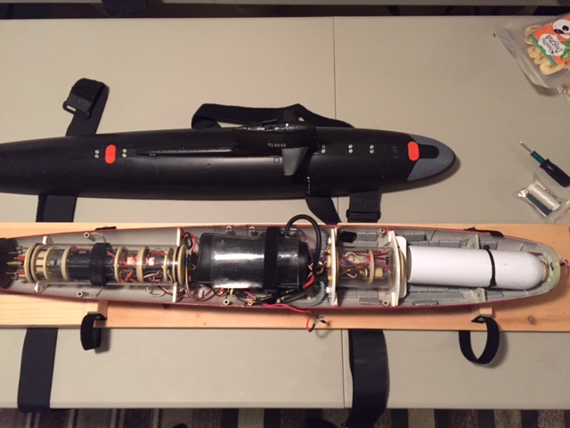

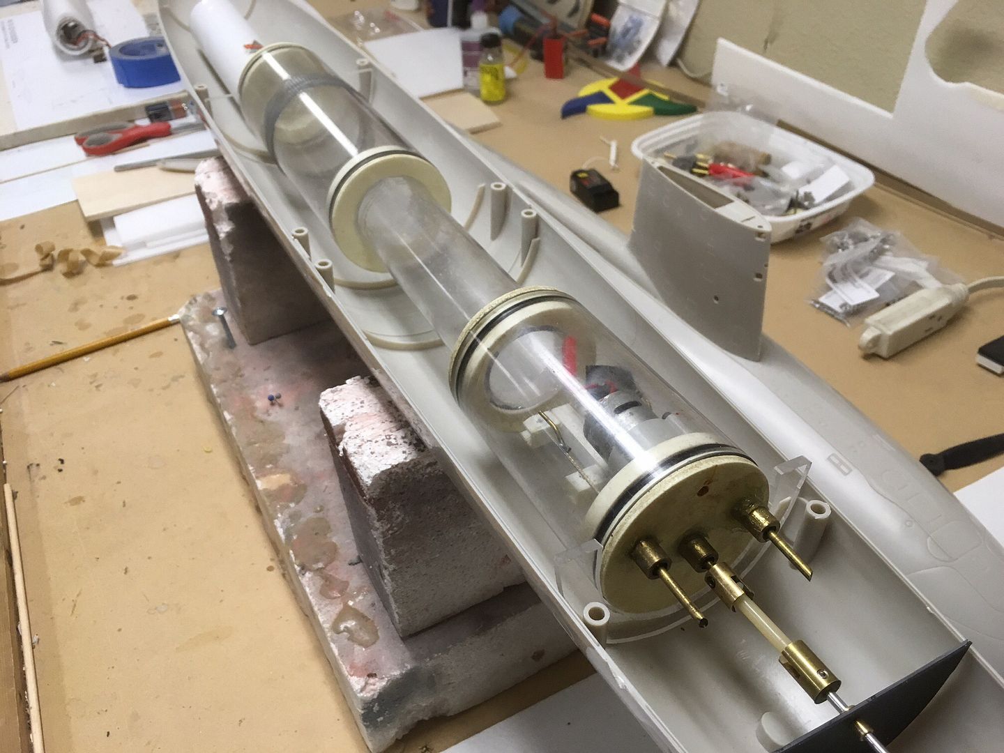

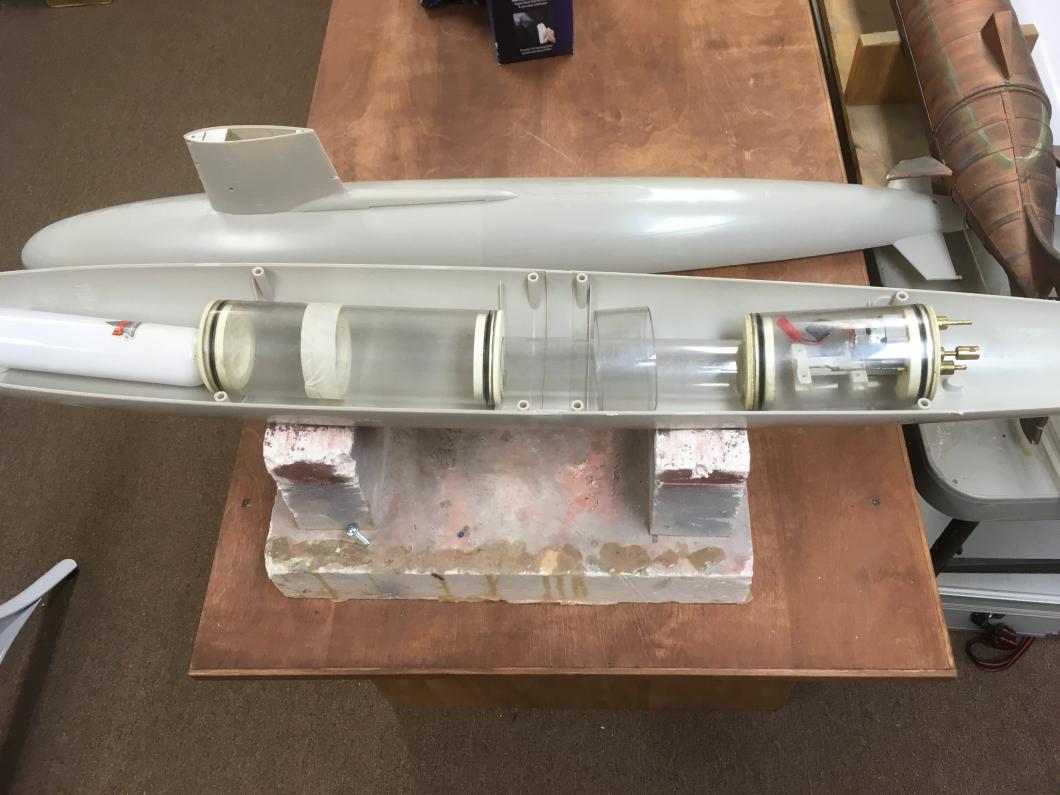

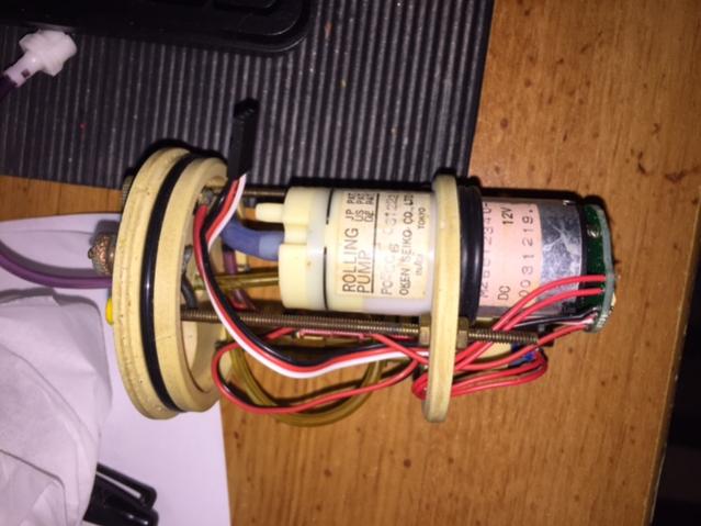

    Hi Steve. I have a skipjack and I was able to get Big Dave to make the internals for it. He just replaced my air pump last month. I don't know where he got the pump from but It is an Oken SEIKO Rolling Pump 12 VDC he used a pump controller from Kevin Mcleod (sorry if I spelled that wrong) I also do not know where he got the bladder but it measures 7" x 3 1/2"
      • 375
      Here are a couple of pictures to give you an idea how he had me do it. There is a lipo hardcase battery that has been waterproofed under the ballast bag. This was to be his new universal cylinder but he decided to focus on individual projects as I think he liked the challenges more than the production.
        Those pumps are all over E-bey from $7 to $50.
        Most are used and some ore new.
        They come in 12v and 6v.
          The mini air pumps that Bob Martin sells (ex-Caswell) work great too and Kevin Mcleod's controller fits it. The controller also operates a small solenoid valve (or servo) to release the air that Caswell used to sell. They are easily found on ebay also. Here is an example-

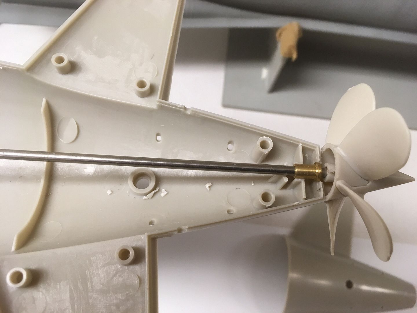

                        So the plan is to mold the prop in silicone and then cast them from two part resin. A grub screw to hold it on the shaft which is a stainless steel shaft.
                        I made some plex bulkheads. A prop bearing support from very thick styrene. Oilite bearings and a dog bone set up. I haven't glued anything in place yet you are just looking at a fitting.
                        Next up I'll make all the dive planes and rudders with stainless steel control shafts with control arms. Nice thing about this model is its open in the stern making it real easy to hook the business end up before you close it.
