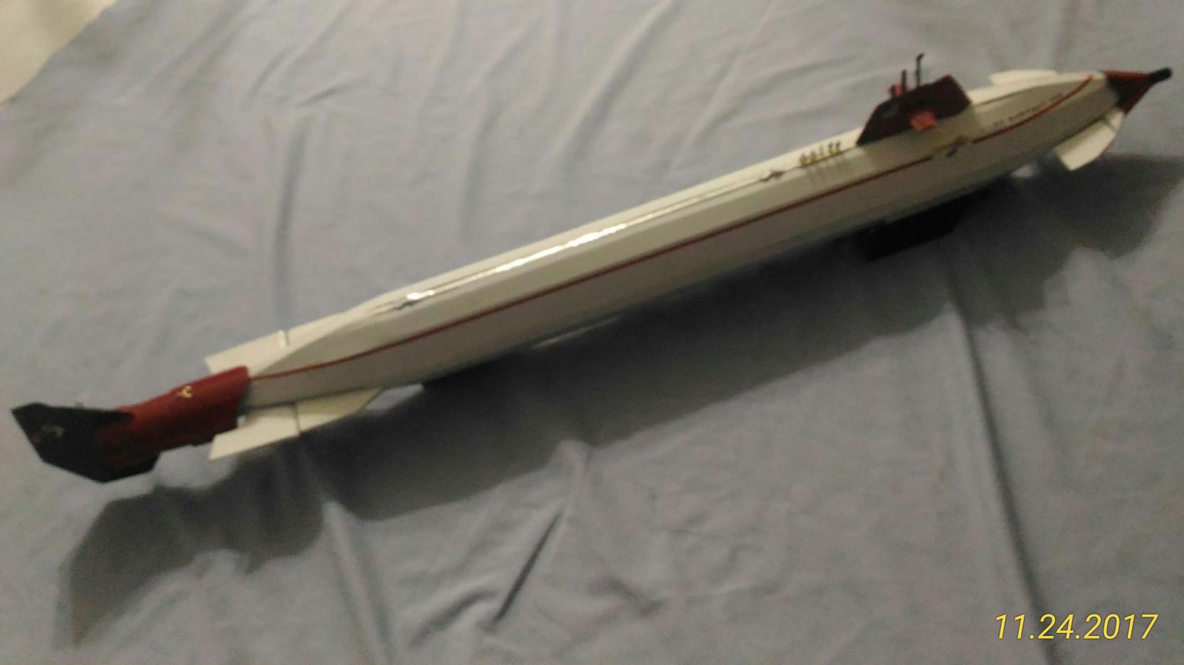

                                From gitgo I wanted a fantasy boat. Here's my boat "Harpoon SSXN 360". It's also a RECARB diver. Click image for larger version
