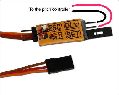

                Originally posted by Antoine View Post
                Nope, that's not correct if I understood correctly.
                Do not change anything to the UBEC connection. Just plug it to your Rx as it was a battery connection (+ and - wires).
                It might be a mistake from Engel, you should not have received a 8455 but a 8454 instead. Maybe you should contact Gregor about that.
                Anyway, if you decided to keep the 8455, you have to connect the two pins (where there should be the red and black power wires of the 8454) to the pitch controller and disconnect the red wire of the ESC plug that is connected to the RDD (use for example your extension cable between the two devices).
                OK, I got the 8454 but it doesn't seem to invert the direction of the dive planes and the end point on the servo in one direction is very small compered to the opposite direction.
                Both end points are set to 100% on the transmitter.
                Any ideas as to what is going on?

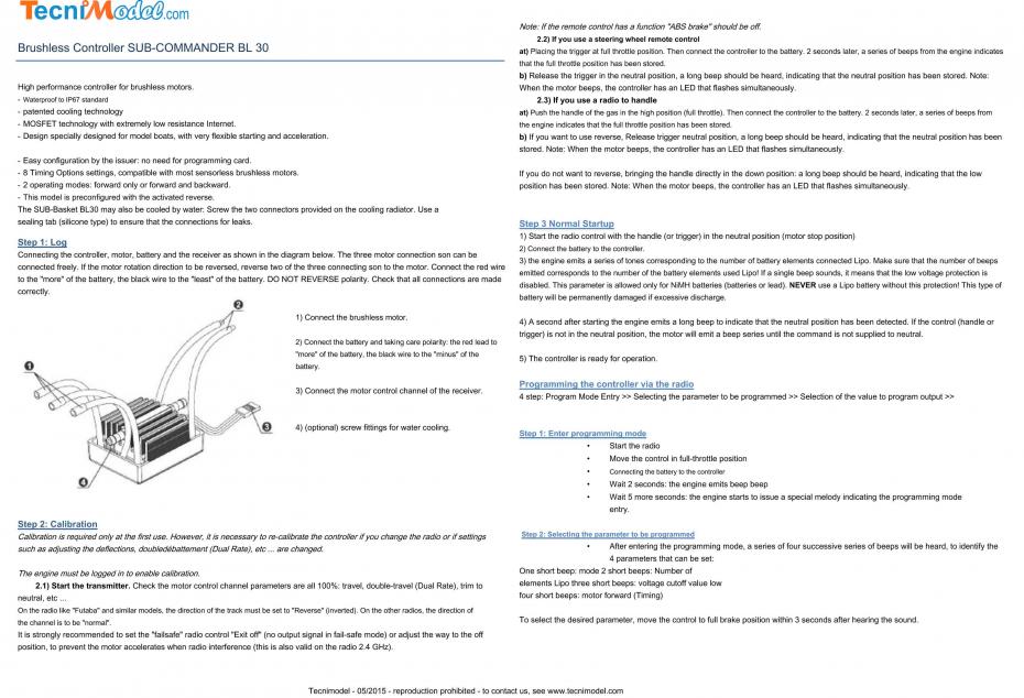

                        Hmmmm...the ESC will only program (red LED off) when the throttle is in the "0" or all the way down position.
                        If I start with the throttle stick the center position, the ESC red LED simply keeps blinking and never goes dark.

                            #43
                            That didn't work either.
                            Seems like I can only get the ESC to program "0" when the stick is in the lowest position.
                            This is the only stick position where the LED goes dark.
                            In all other positions the red LED is blinking until I move the stick to the lowest position.
                            Once programmed if I move the stick to full throttle the LED goes from red to green...not sure what's happening when that happens...the motor is transitioning from mid-range speed (LED is red) to high range speed (LED is green).
                            According to the Engel website the BL-30 controller can be programmed as Forward only or Forward-Reverse.
                            It looks like mine is programmed incorrectly.
                            So I went on line and found the supplier of the ESC (TecniModel) and downloaded the programming instructions (in French naturally).
                            Translated into English but still unable to change the Mode.
                            Still can't seem to get into Forward-Reverse Mode (not sure if it's 1 or 2)
                              • 364
                              #44
                              parameter 1 is the running mode and it's two short beeps for forward and reverse, I will attempt to scan the manual and post it shortly
