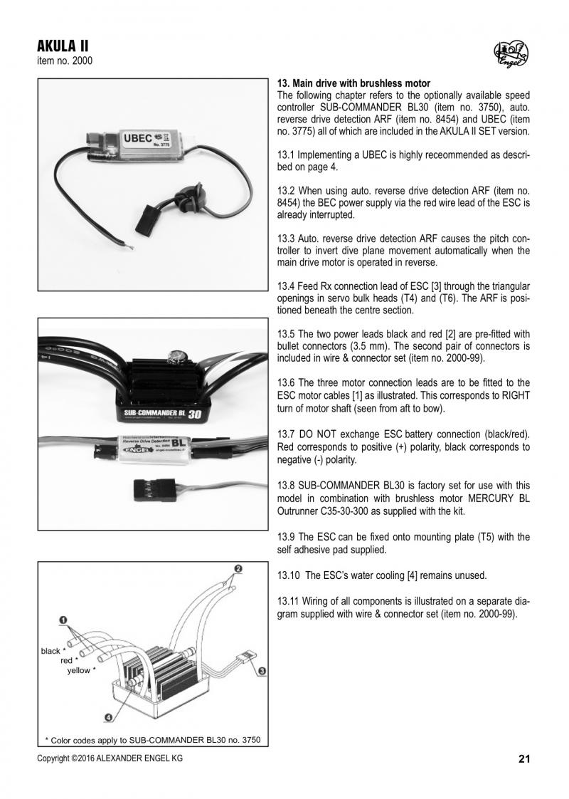

      The wiring diagram shows a power connection for #8454 (no BEC Version)
      Since there is no power wire on the #8455 (BEC Version) do you think it is powered from the ESC?
      Hi,
      To make simple, even if you use the UBEC, it is like if you did not use any BEC. It's the reason why the 8454 is included in the SET version.
      The BL30 ESC has a built in BEC, in the instructions Engel does not recommend using it (due to power stability). If you use the 8454 even without removing the power wire from the ESC, the receiver won't be powered by the ESC as the Reverse Drive Detection cuts this power line.
      The receiver gets its power from the UBEC that simulates the presence of a RX battery (UBEC is connected to the batt. socket of the RX, like a conventional setup), therefore the RDD is powered by the RX.
      The UBEC uses the main battery power to convert it for the Rx.

        Engel sent me a Reverse Drive Detection #8455.
        There are no red/black power wires on the RDD #8455, (only on the #8454)
        If I use the UBEC wired as above, it looks like the RDD #8455 would then be powered by the receiver buss.
        Correct?
        • Antoine
          • 447
          Nope, that's not correct if I understood correctly.
          Do not change anything to the UBEC connection. Just plug it to your Rx as it was a battery connection (+ and - wires).
          It might be a mistake from Engel, you should not have received a 8455 but a 8454 instead. Maybe you should contact Gregor about that.
          Anyway, if you decided to keep the 8455, you have to connect the two pins (where there should be the red and black power wires of the 8454) to the pitch controller and disconnect the red wire of the ESC plug that is connected to the RDD (use for example your extension cable between the two devices).
