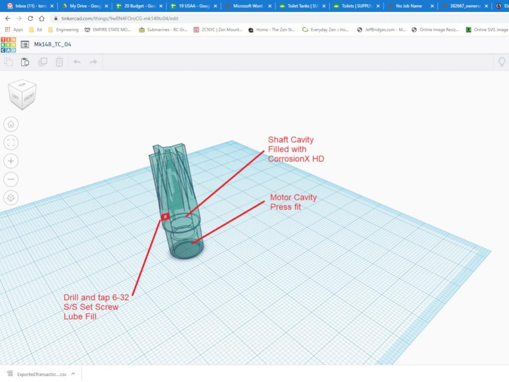

      Bob, Thank you! I am working on a 1/72ish torpedo.
      Scott,
      No real seal. Tubing that will fit .8 mm (shaft size of motor) I did not find. So, I needed to solder.
      Any kind of seal seems to cause a lot of friction. Keep your ideas coming you brilliant cyclist.
      I was planning to forego any seal and rely on good old CorrosionX to keep things running "back there". I went as far as 3D printing the prototypes.
      My BIG issue is in finding a commercially available 2/3 bladed propeller less than 7/16" OD.
