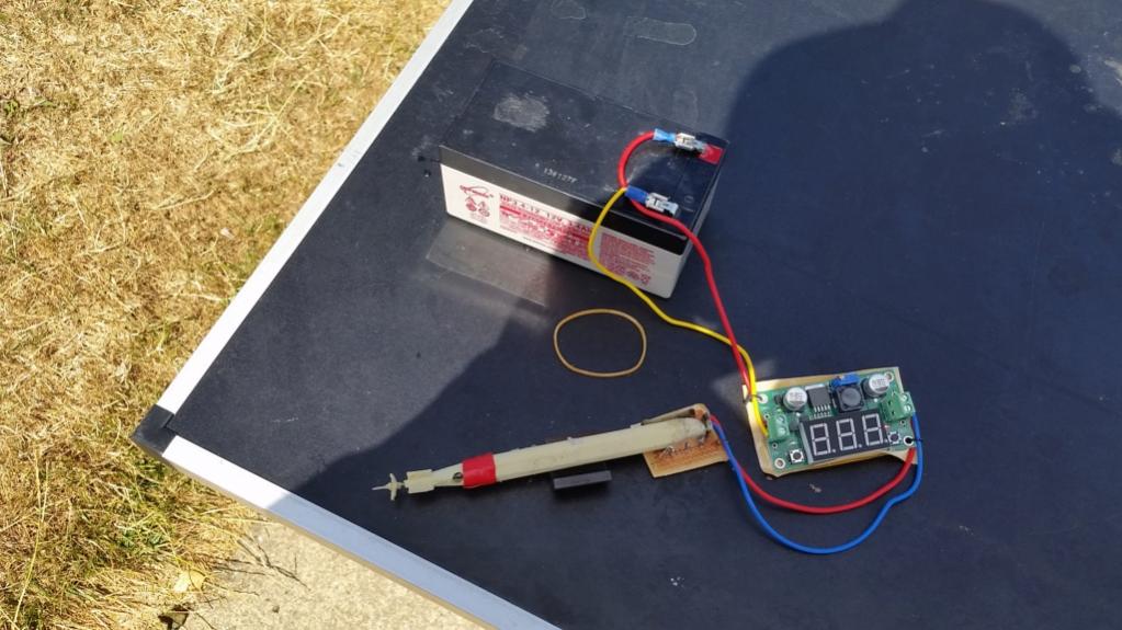

    A photo showing my charging setup (The digital display is helpful because it shows the charging process - only takes a few seconds.)

      Nice charging station! Brilliant.

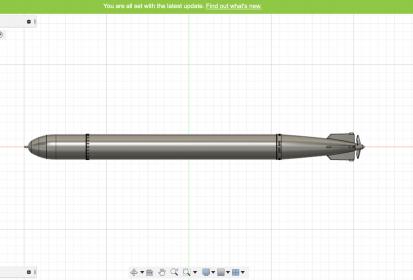

                          New update. This is torpedo ver. 2

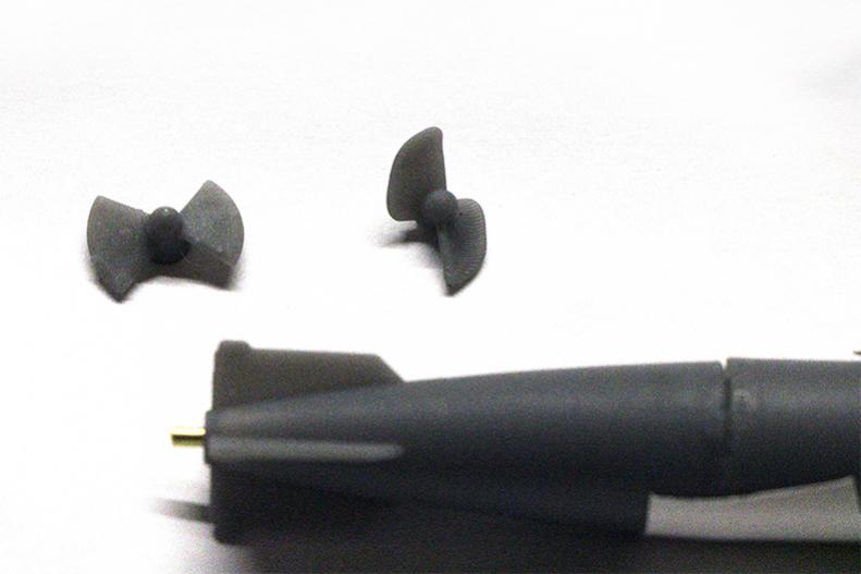

                          When testing it, it rolled a lot (which makes sense since everything is mounted along the center longitudinal plane. So, to give a little metacentric height added a weight (seen in picture above).
                          I made a prop that had a very slight angle in the prop (compared to version 1), but had a larger surface. It still made the torpedo spin. Then tried it with Version one prop

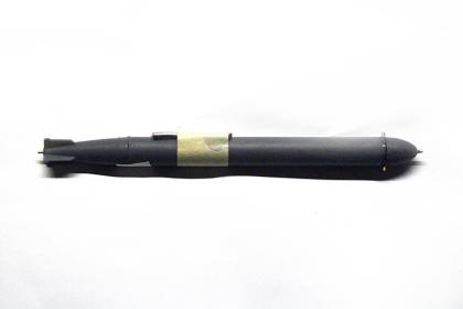

                          and it did not spin..... I may have found the combination.
                          More testing being done.
