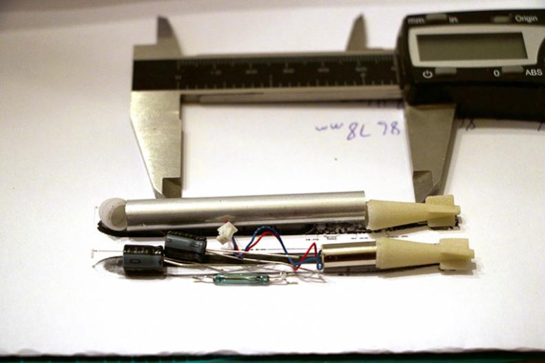

        First test in making a 1/72 torpedo using a 6mm careless motor.
        It looks like all would fit, tight, but fit non-the-less.
        It sank. Not sank like it could float, more like a rock in a pond sank.
        So, scrap the 6mm motor. I will have to go for the 3mm and see how that does. I may also cast the nose and tail in resin with buoyant filler to lighten it if needed.
        I could lighten it up a little by using one capacitor, but run time would suffer. I will try with two to begin with.....We're having fun right? More to come.

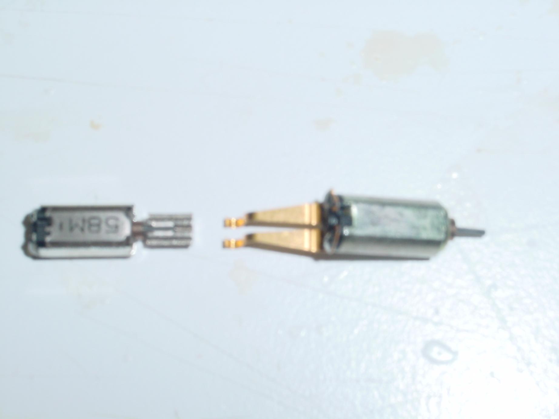

            How about trying a pager motor? They are SMALL and VERY light weight. As for RPM on that single capacitor, should be pretty high. The ONLY problem would be to figure out a small jig to hold the weight that creates the vibration, usually it is pressed fit on with a small punch point to hold it to the shaft.
            Don`t try to forcefully pull the weight off, did that bend the shaft and damaged the motor. You have to drill the small punch point out then the weight comes off. Then you can either turn a disc or 3D print a small round disc with the center hole the same diameter as the pager motor and you have a holder for the motor as well as some water proofing for the main torp. body cavity.
            Some pager motors I have their case sizes in mm:5.47 x 4.28 x 0.05oz Other one:6.0 x 5.06 x 0.05oz
            Let us know if you tried this and what happened.

                George,
                Coreless motors are pager motors. Like you said, the shaft of the motor has a weight on it that is offset causing the vibration. I need to shave a lot of weight.

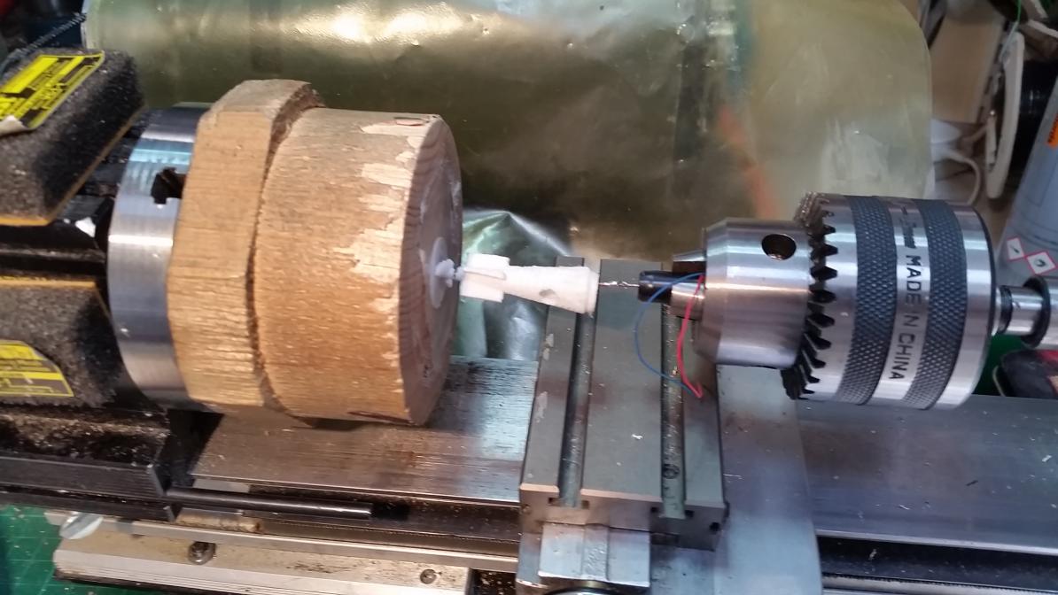

                            Moving on to assembling some of these clever little torpedoes. (Thanks Tom!)
                            The photo shows the propeller and motor being lined up in my Taig lathe. I found this made it much easier to get the prop lined up and to solder the 1mm diameter brass wire on to the motor shaft. The motor is a 6mm diameter one which was amazingly cheap on eBay. Rather than use the motor mount I have wound several turns of PVC tape round it. I stick the motor in with silicone.
                            I have tried several tests in the home test tank and I am now waiting to see how the motor and electrics cope with the repeated "dunking."

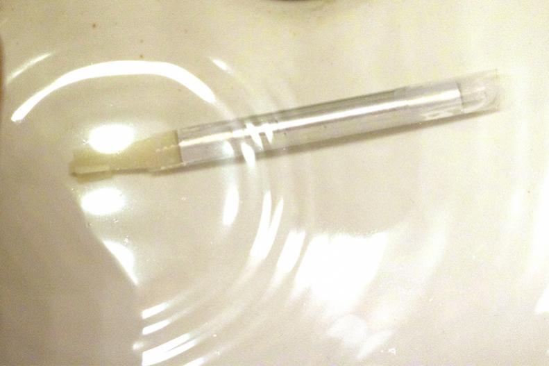

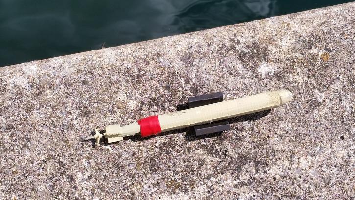

                              A photo and a couple of videos of Tom's clever torpedo design at the Norwich MBC model sub weekend here in the UK.
                              (I have used the simple design with a 6mm diameter motor and a single 1F capacitor. The end caps are stuck on with silicone rubber to provide a reasonably watertight compartment - the torpedo just floats. I remove the caps after use to let things dry out.)
                              A very good, simple and very cheap to construct design.
                              Improvements? Stop torpedo body spin so much? Straighter running?
                              Kids of all ages liked it!

                                #30
                                I see yours likes to turn. I had that with one of the test props I had until I changed the prop. Not sure I remember which one caused it, but when I put the speed boat prop in it stopped doing that. Are you using the 2 blade prop?
                                Body spin, I get that as well. When I designed the torpedo body I put a ~7 degree on each fin to counter the prop and try to get a slow roll. The roll is to, in theory, get a straight run.
                                I am open to ideas.
