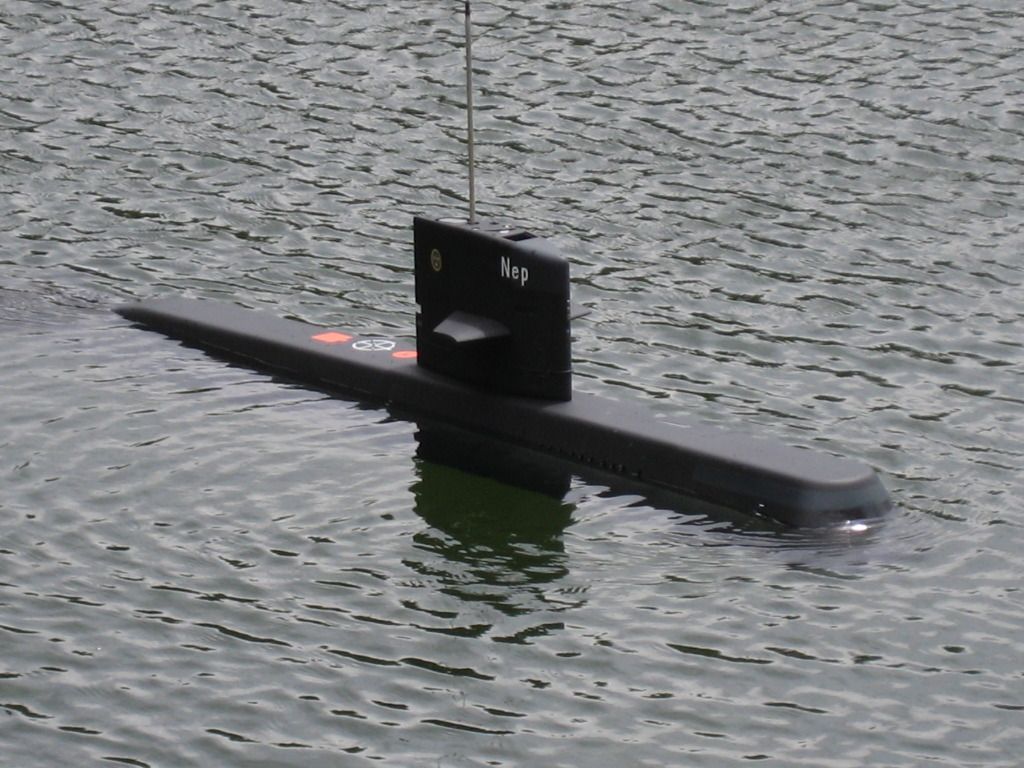

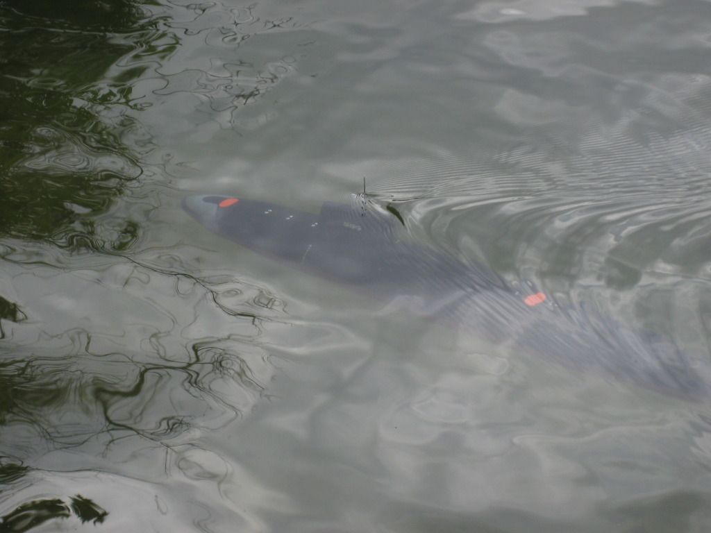

    Those posting above have covered most of the news. A day high in fun quotient and camaraderie but low on boat performance—at least for some of us. As always, Oudmayer's and Dory's boats ran flawlessly, though a couple of pronounced radio "dead spots" out in the water were noted and reported. The rest of us all had various issues of assorted hindrance. As for myself, I got one decent run out of Seaview early in the morning before her rudders locked up (somehow binding or the result of a failed servo]Blueback[/i] couldn't run at all because I couldn't get any gas into her blow tank]Nautilus[/i] consult), and of course more still and further details in the next SCR's Fox Report.
    TIll then,
    JeffP
    P.S. Note water clarity in the first shot]http://i1143.photobucket.com/albums/n637/jefftytoo/IMG_6791.jpg[/img]

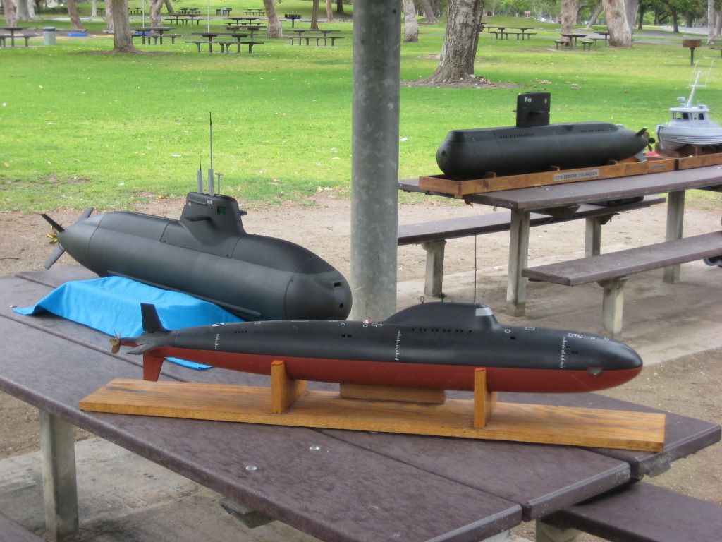

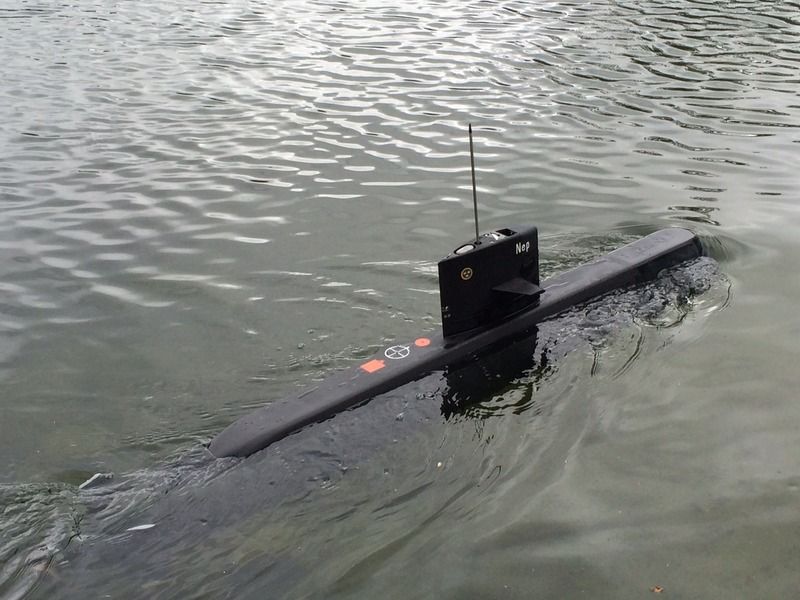

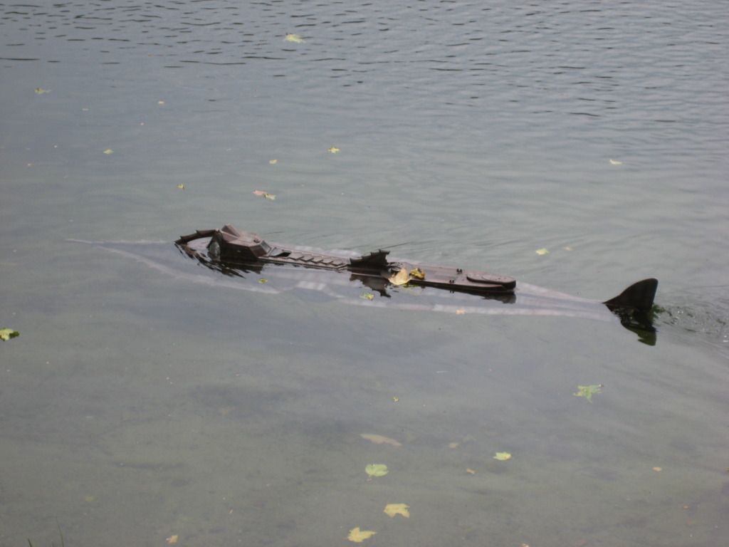

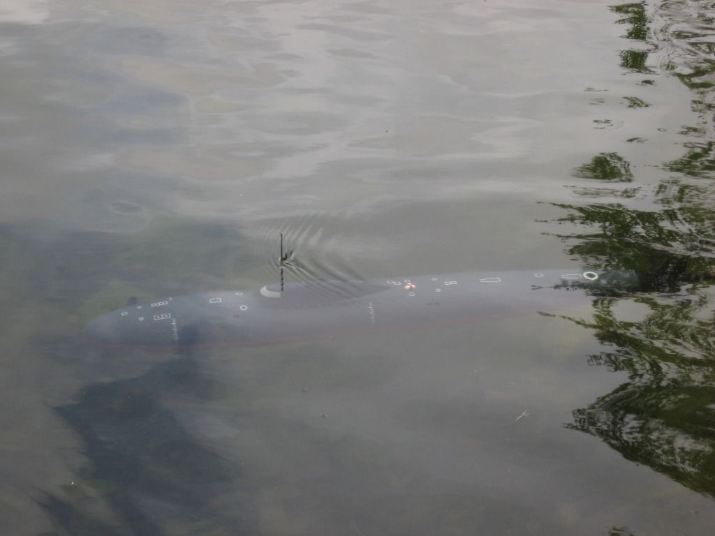

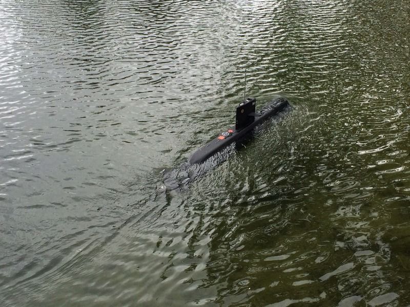

      While looking at the photos of the boats, something came to my attention.
      The boats that run at the lake regularly and have no issues when running all have their Rx antenna sticking out of the top of the sail as as a mast.
      When running they spend a lot of time at periscope depth and this antenna has at least 1/2" out of the water.
      Now I am not saying this is why these boats run so well, I did not see the boats running with the antenna below the water surface.
      Just wasn't something I was thinking about at the time.
      Will be looking for more photos and Steve's video to see if I can find these boats running completely submerged.
      Antenna completely under.
      This is just a thought I need to look in to.
      My antenna is completely inside the cylinders.
      I remember talking with Darrin and his seeing antenna is completely inside the cylinder.
      One more thing to check in to.

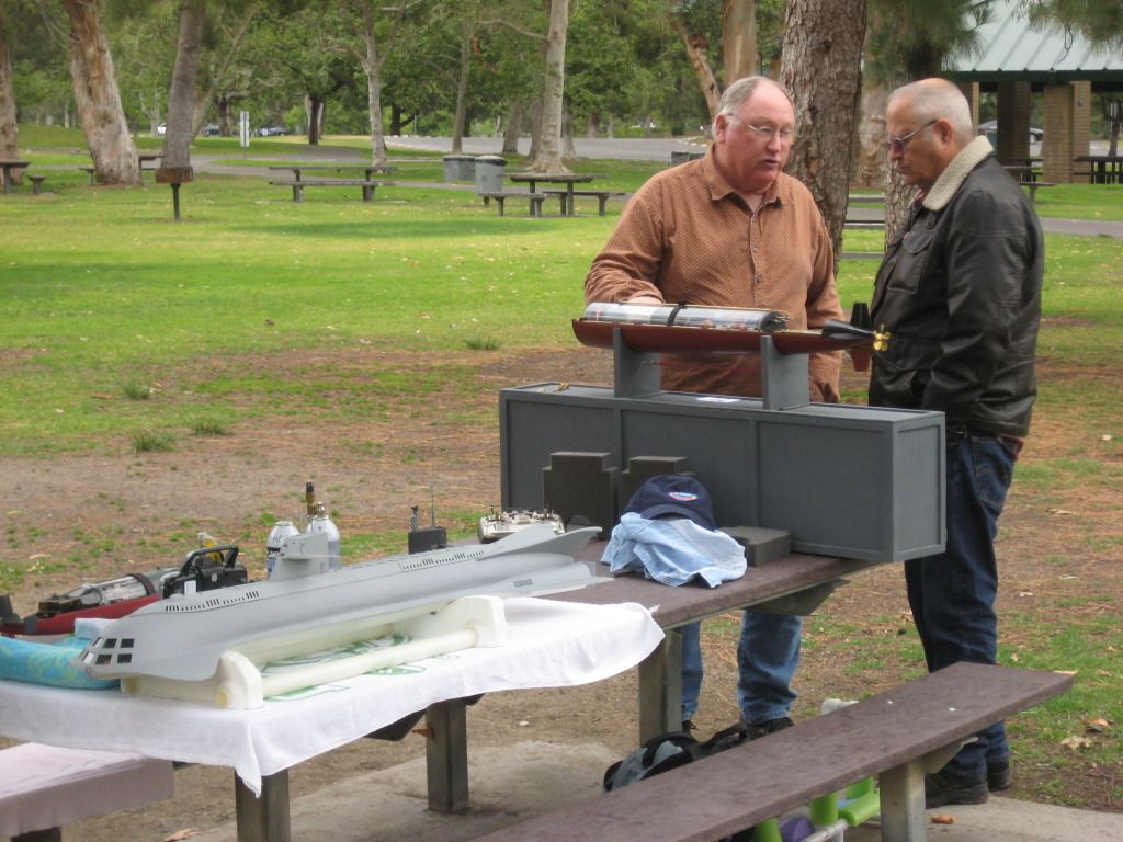

          1) two gentlemen i don't recognize... the man in straw/cowboy hat and shorts... and the gentleman carrying Steve's Nautilus in the blue shirt... do you have names for those two?

              The Straw Hat Man is a longtime SC member, a buddy of mine named Neil Schmidt. He's an engineer for Honda. He's got a 32nd Parallel Ohio class (impressive when running!) and some other ongoing r/c sub projects, including an Alvin like yours. Currently he's working on that little Delta you see in the photo where he's consulting with Will, who's got and runs the larger version. Both those two are key figures in our group 66" Nautilus build (same kit as Steve Neill's, only older). The other gentlemen is Alan Haskell, a static boat modeler—one of Steve's posse, like the rest of us—who's also into r/c subs.
