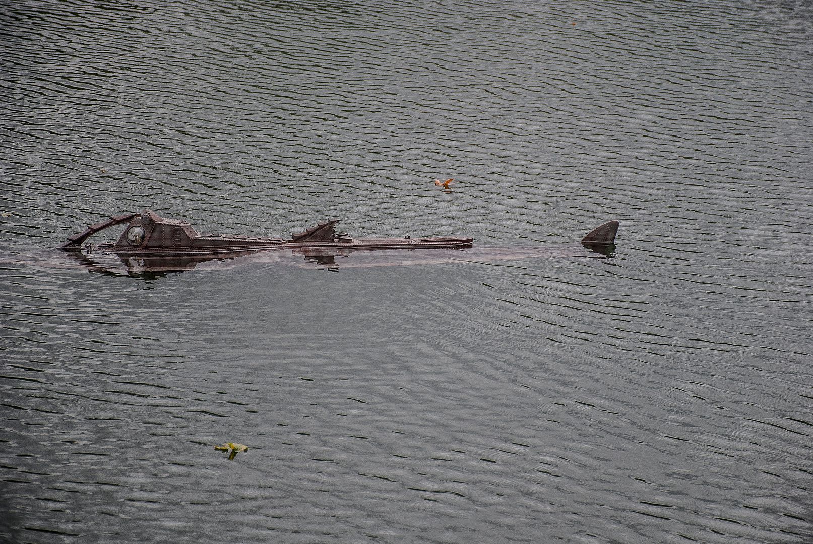

                      We had a great time. Travel time there and back was interesting. About 2 hours to get there, three to get back. Traffic was awful but it was all worth it to see my friends and spend time with them playing with our favorite past times. I had my fair share of problems but what would be a model submarine without the occasional problem, especially with two new boats in my case.
                      The Nautilus had never been in the lake and performed well. Trim was perfect but I couldn’t dive deeper than my frog eyes. She did in the test pool but that was different water than the lake and she was more buoyant in the lake. Two pieces of lead fore and aft would have done the trick.
