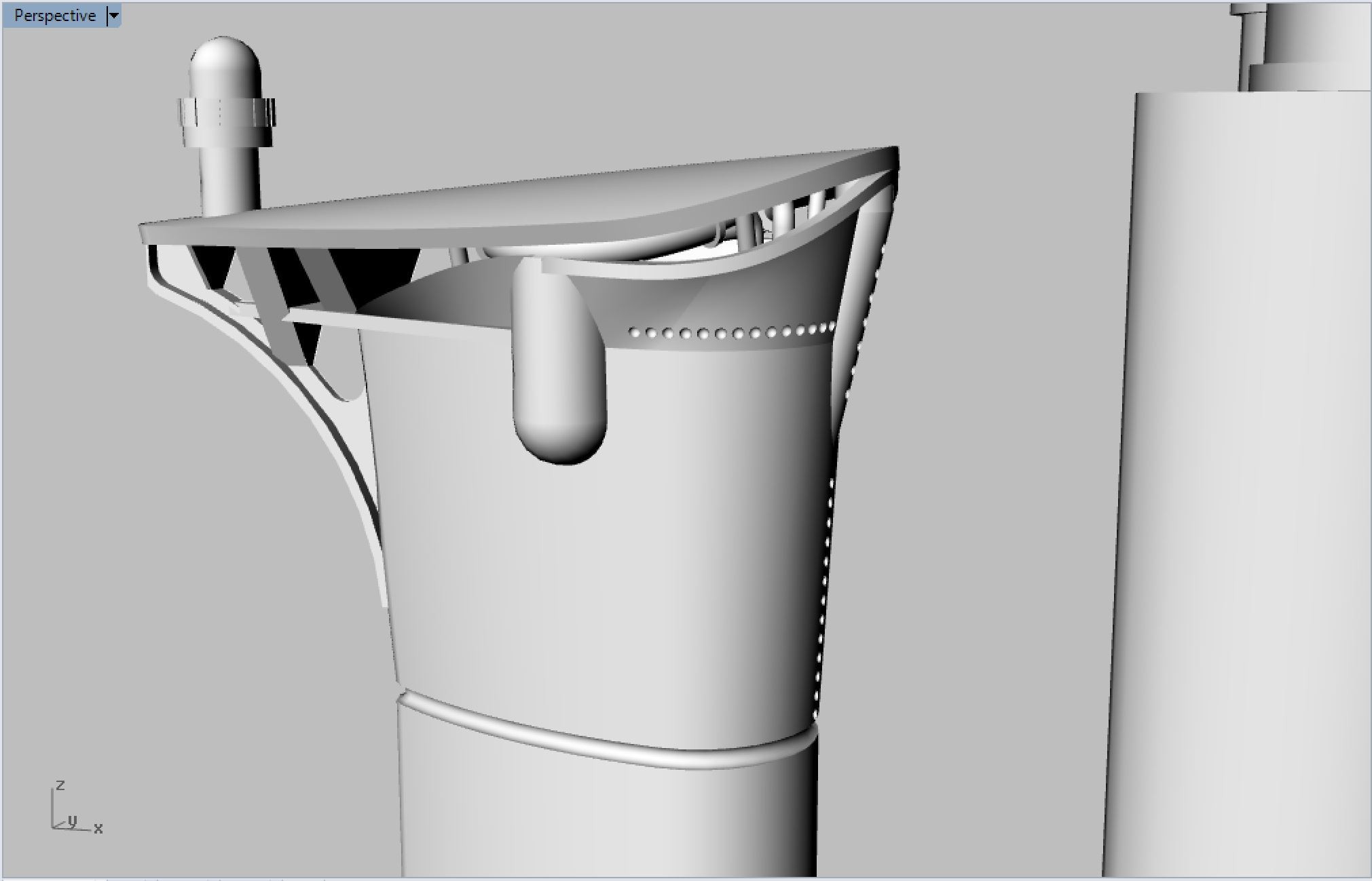

    Here is a photo of the first print of the snorkel. All the the masts plug into an internal plate for mounting. The entire sail is hollow and printed in one-piece including the vented mounting plate inside the sail.
    The second photo is of the very first print of the Blueback sail with some of the masts/scopes mounted. You can see the new 1/96th scale SSN-637 Sturgeon sail behind the Blueback sail. Both prints were the first test shots and still need some adjustment but they look good for a first print. The bridge of the Blueback sail has been revised since this image was taken to add more detail.
