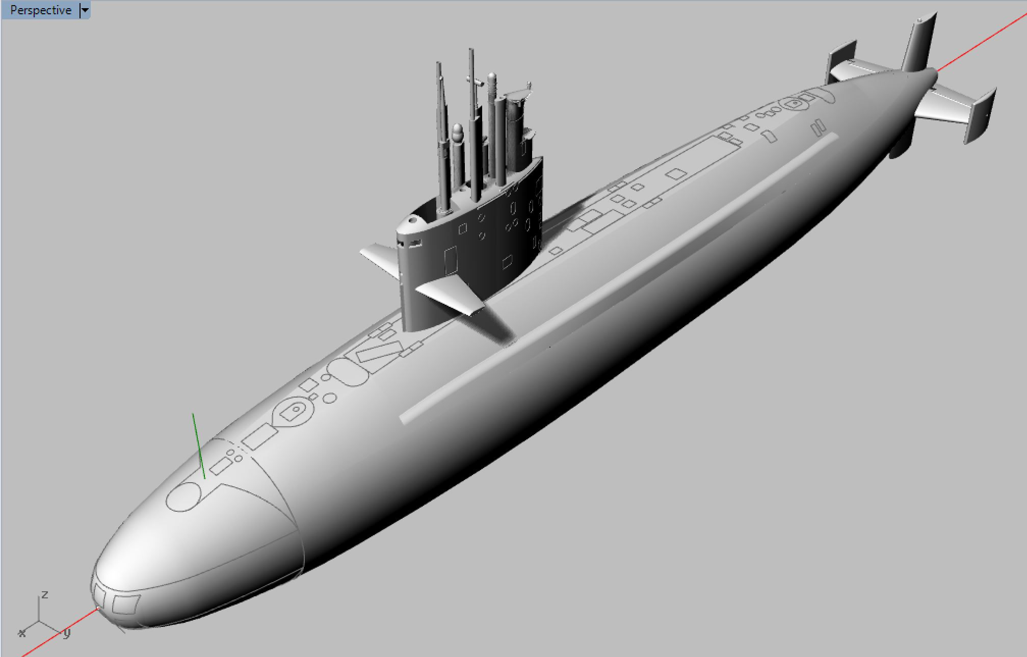

    After a few delays, the Small World Models 1/96th scale USS Blueback has been completely reworked and is nearly ready to mold up. The only item requiring molding is the hull. All of the other components are 3D resin printed out in extra strength resin. There is still a small amount of cleanup to do but it is very nearly done. Here are a few photos for you to review.

    The first half completed printing overnight. Here it is hanging over the resin bath ready to be removed from the build plate. The second half will be loaded up today and should complete in around 33 hours of printing.

    Here are a few photos of the hull master printing on the resin printer. The hull master has been split in half into sections approximately 13" long. The two halves will be joined to form a single master.

    Here are a few more model shots from the 3D CAD.
    We will be adding a beautifully crafted 5 bladed brass propeller to this kit. It will come standard with a 1/8" bore with set screw.

    Here is another update and a huge milestone was reached with this project. All of the 3D CAD work is complete. The sail, scope, shears, and appendages have all been printed out and fit tested. I am very happy with the results, although there were many failures along the way. The hull will go into the 3D resin printer next week leading to the final step of pulling the epoxy mold off of the 3D pattern for the production of kit parts.
    My thanks go out to Bob Martin for his very kind patience with me on this kit, as well as the many folks waiting for its release. I think you will be very happy with the end result and how fast this kit will go together.
    More to come on the assembly methods we came up with to make this kit go together very fast and accurately.

    I worked on the bow and upper deck scribing a bit this morning. Here is where it is as of today, March 18th, 2024. I should have all of the scribing wrapped up by the weekend so the hull can be split into a bow and stern section for 3D Resin Printing. These will then be joined to form an all-new master pattern for molding to produce the epoxy glass kit hulls from.
