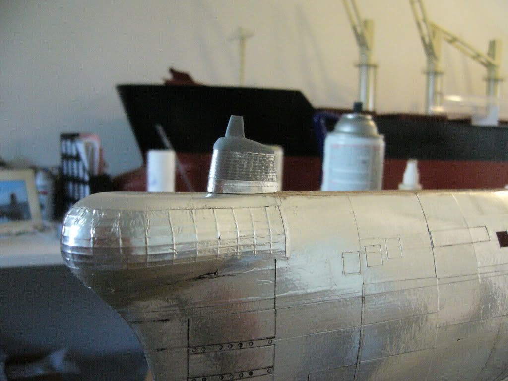

                          Here are some new photos showing recent progress on the Foxtrot. More detailing remains to be done including seams, rivits & oil canning.

                            Here is the tower with the exhaust and running lights added; sonar dome on the bow.
