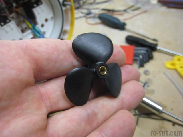

            So, it blew a fuse......but after running for 45 minutes.
            I did the initial trial, but shortly after running it (it ran so well and behaved so nicely) I handed the controls for Sam to run.
            He and I both were able to get a pseudo neutral buoyant (well close enough) attitude with the Neptune.
            So I went to go sit with grandma and Tina and a little while later, the sub was on the surface and Sam yelled it stopped. We figured it ran out of battery. Although that was pretty harsh not to let us have any throttle to guide it in.
            When I got home, I put the battery on the charger and it had about 11.7 volts on it, I thought that should be more than adequate to run. Checked the fuse and that is when we discovered the fuse was blown. The internals were dry (yeah!) and I did not smell any electronic burning smell. So gurus of the Neptune, is the prop too much for this boat? It is a three blade, 40 mm outside diameter with a 41 mm pitch (do not know for sure what that means or if that is a steep pitch). How does the Raboesch prop compare to that?

              This is the boat with the aftermarket gearbox installed? Did you receive the standard kit-supplied parts that were removed during the 'conversion'?
              Okay, that aside...it would be good to know what the amp draw is when under full throttle (and even better the prop is in water). We'd then need to check the ESC to see what it's rating is. I don't recall from looking at mine...perhaps BD could chime in on this?
              One other thought - you could consider replacing the fuse with a fuse that resets automatically after a period of time. That would get you back to 'shore' in the event of future problems.

                  Thank you. The planetary gear drive was removed, it is back to stock (purchased replacement parts). Andy also suggested testing with the prop in water, I guess I better do that. Now for the dummy question....I have never tested the amps drawn from a motor is that a measurement between pos. and neg. or is that an inline test negative passing through the meter?

                      I would just add the next size larger fuse.
                      The ESC in the sub is actually quite robust and has built in over current protection.
                      I am sure you are drawing more amps than the stock prop at full throttle but the motor will be fine with it.

                        40mm dia by 41mm pitch is the standard size of the original Neptune prop. The replacement may have more blade area though.
                        A low revving high torque 550 should easily be able to turn that without pulling much current.

                          Which prop are you now using? The stock prop of the TT 'power' prop? I'm using the TT power prop and have not had any problems with the fuse kicking out. If yours is the same, then this might be useful comparative information to help track down the problem.

                            It is a prop that Bob from rc-sub.com put on when he owned it.
                            here is a photo from his site:
                            So, should I back this prop off and get a 6 blade prop that TT sells?

                              The scimitar props doesn't make a huge difference. Unless you are unhappy with the speed of the boat, leave the prop as is.
