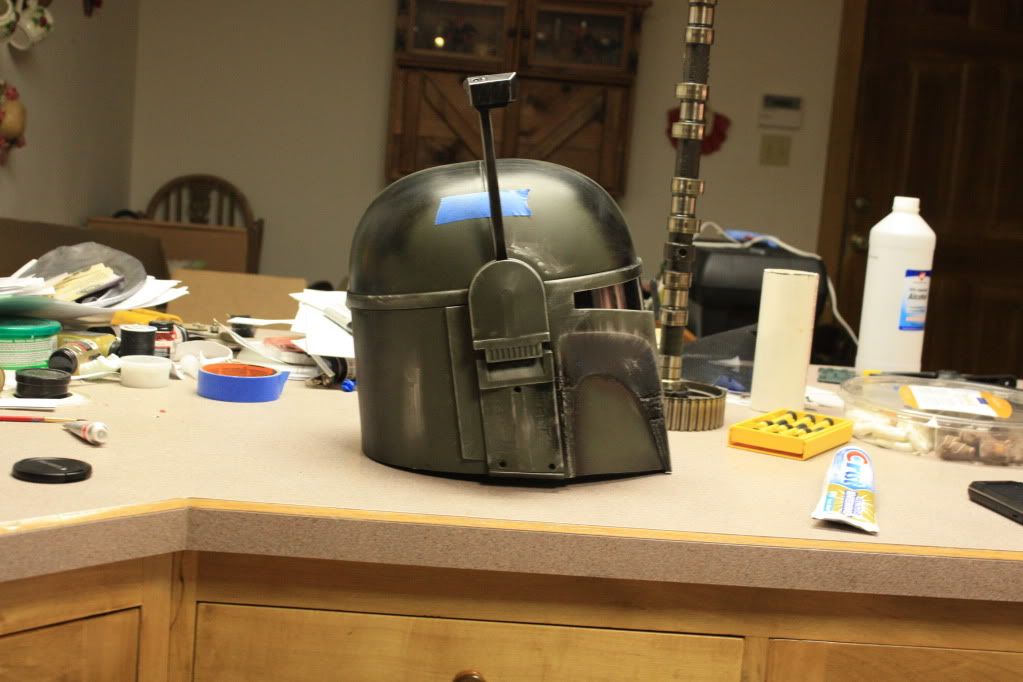

            i will have to give it a try! well, i got distracted again. my buddy asked me to build a boba fett style helmet for his oldest son since i did a commander cody helmet for his youngest. finished it yesterday, so im back to alfa.
            and here is the Cody helmet i did last summer
            back to work!
            Jon
