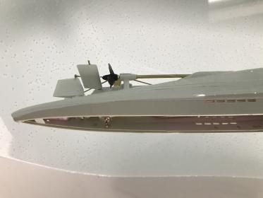

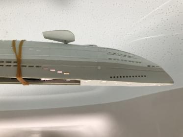

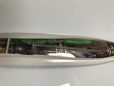

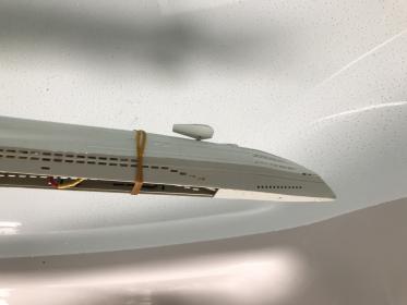

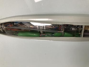

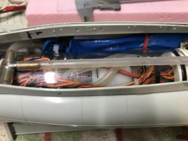

                              An update on my conversion. I placed the punch balloons according to the instructions. I reached close to the CWL but without a deck and a tower if I place the deck with a tower no chance to get the waterline.
                              It is very difficult to pinch the foil without squeezing the balloons. I spent many hours testing without success, to be honest with the system it is not possible to reach the waterline.
                              I spent many hours testing without success, to be honest with the system it is not possible to reach the correct waterline.
                              I would not dare to drive in a pond only in the swimming pool. I may be doing something wrong —conclusion project is now taking a break. I’m waiting for my Seawolf WTC this is a working system and easy to assembling.

                                #45
                                How about reducing the weight of the internal components? Maybe swap out the big airpump for a smaller one. You'll surface slower but the less weight may help you reach CWL.
