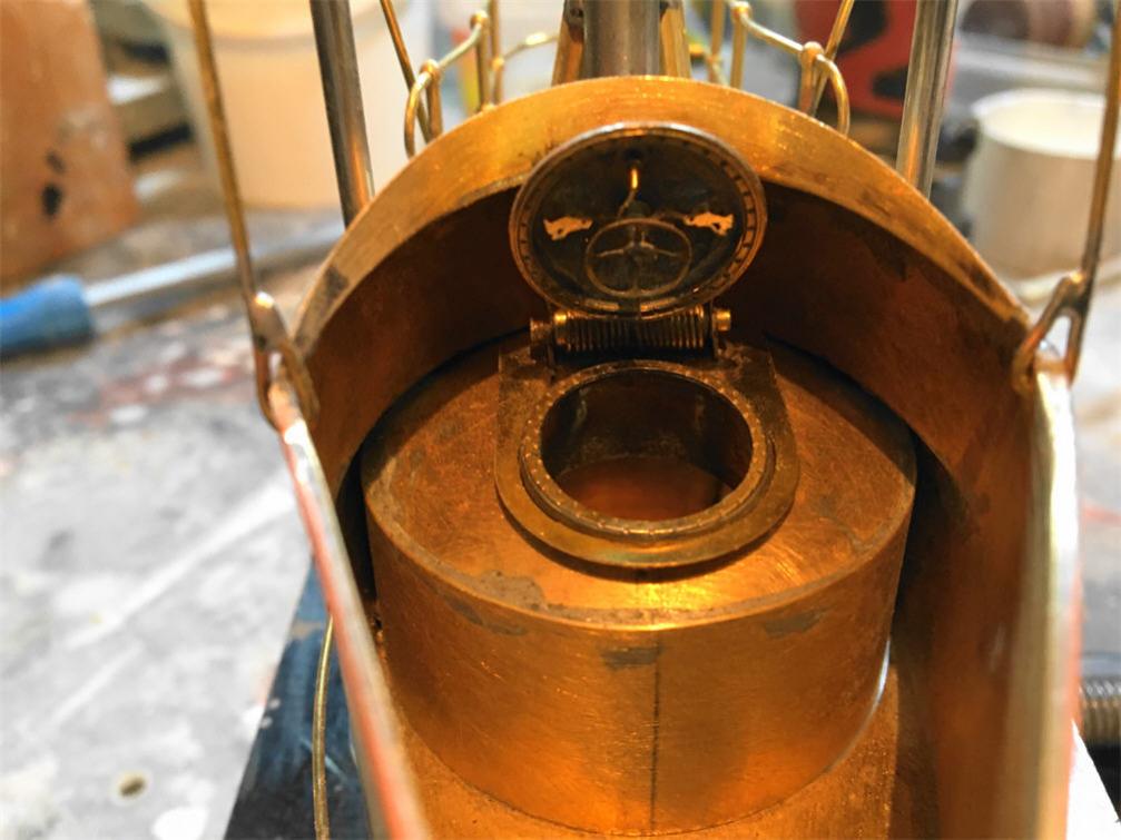

    #61

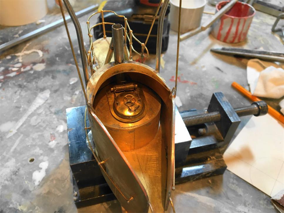

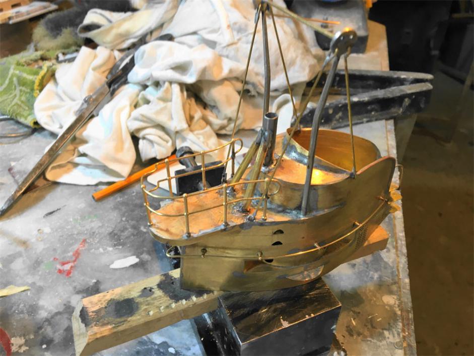

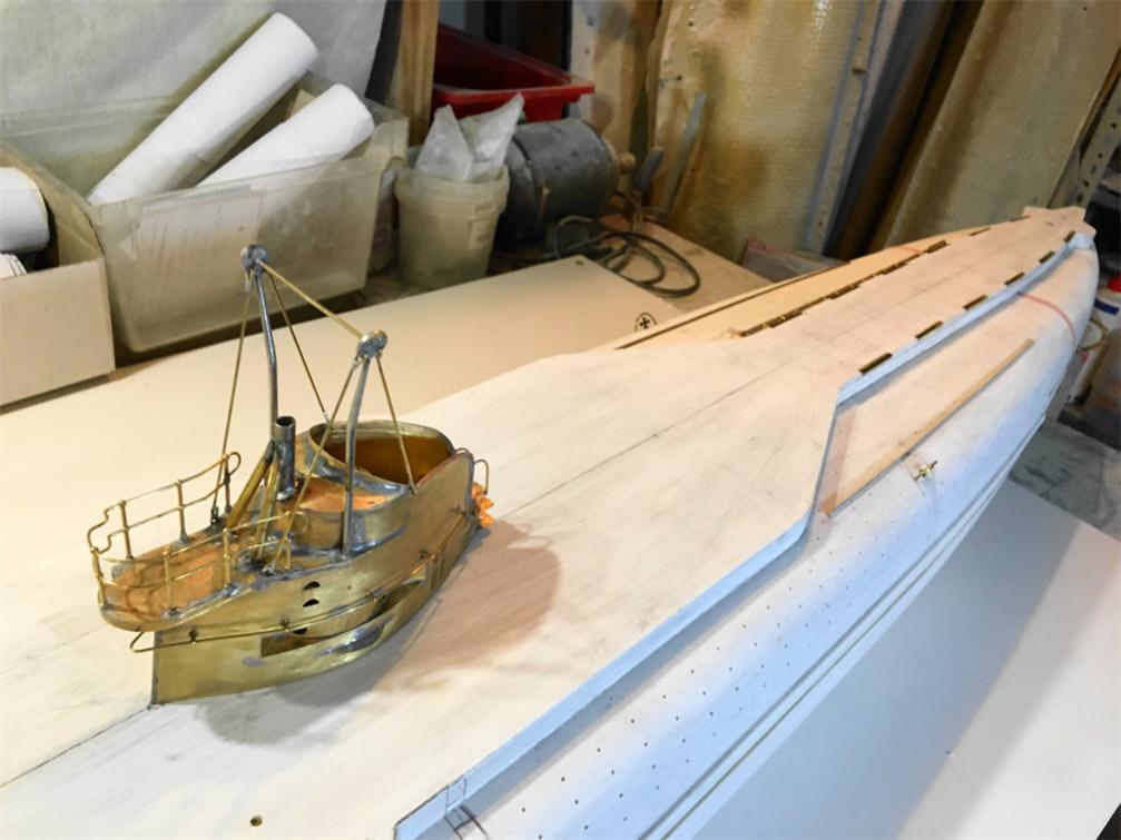

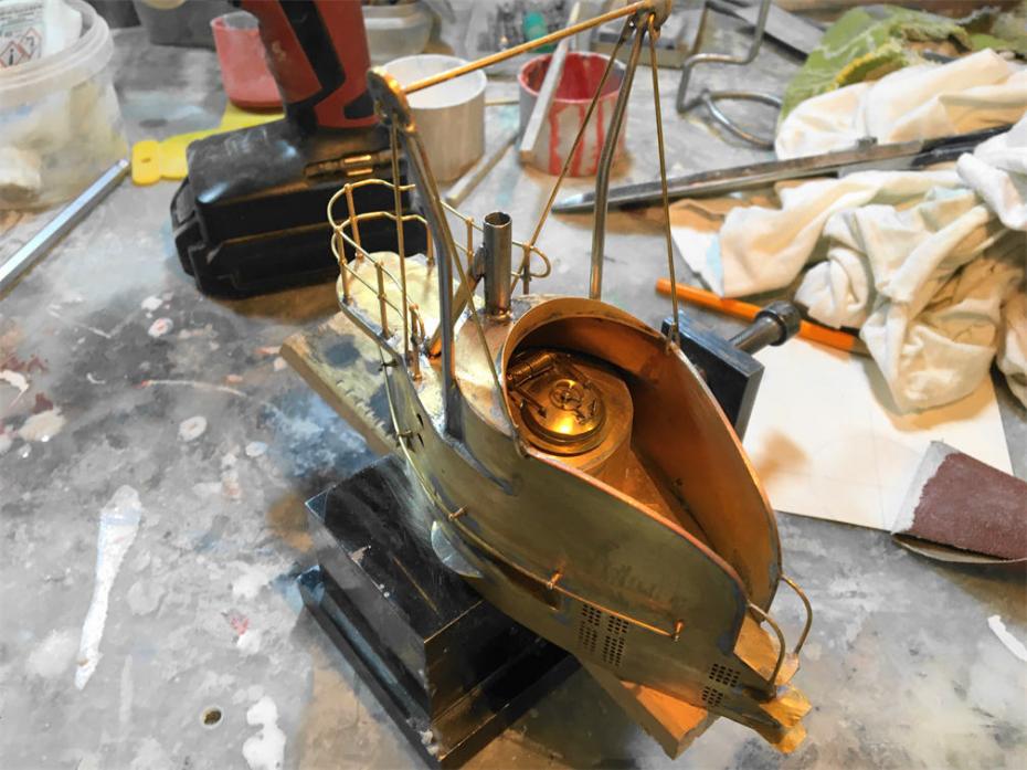

    The cabin is almost ready. It remains only to install running lights.
ID:	134629 Click image for larger version
ID:	134630 Click image for larger version
ID:	134631 Click image for larger version

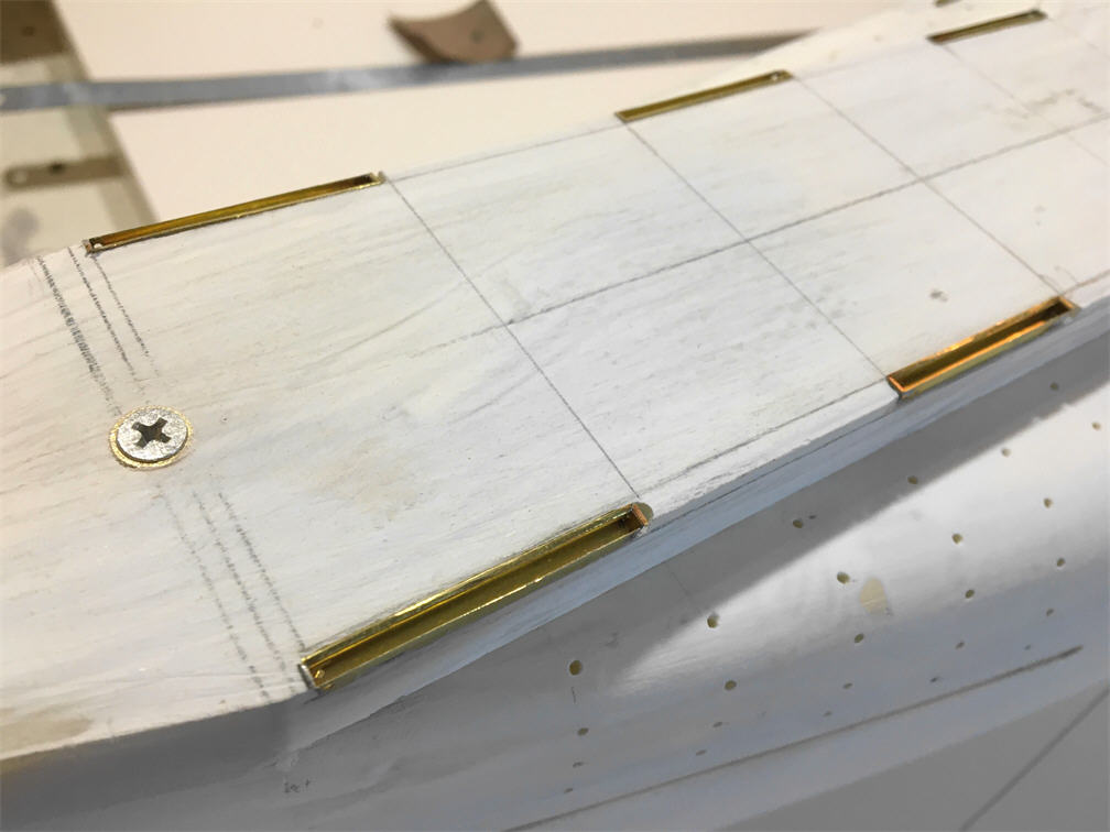

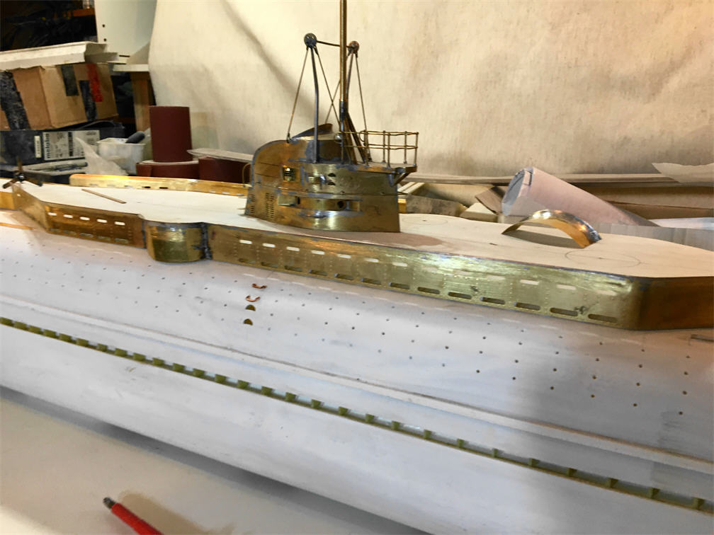

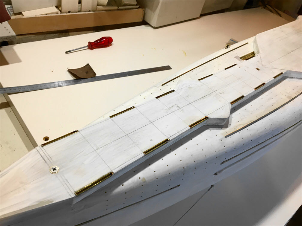

      Preparation of niches for racks
ID:	134633 Click image for larger version
ID:	134634 Click image for larger version
ID:	134635 Click image for larger version
ID:	134636 Click image for larger version
        • 880
        #63
        Looking good FIRMA555. Very nice detail on the underside of the hatch. Quite a difference between this boat
        and WWII boats as this was probably riveted and later boats welded.
          • 2349
          #64
          You continue to make it look easy. That sail is in itself a work of art! Thank you for sharing!

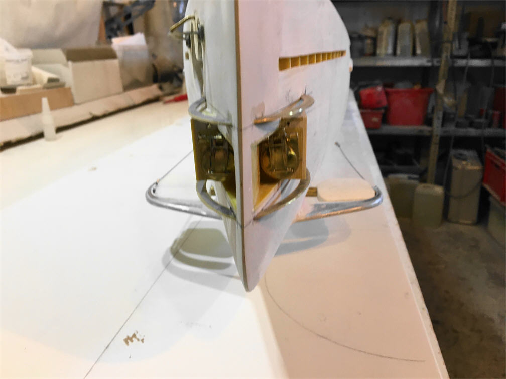

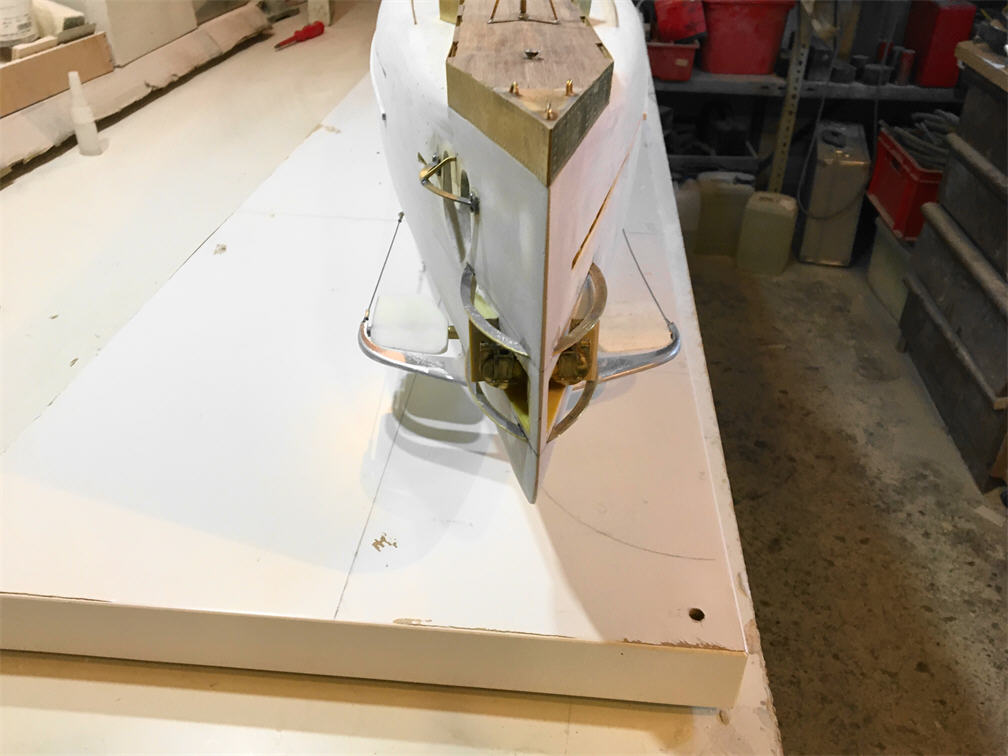

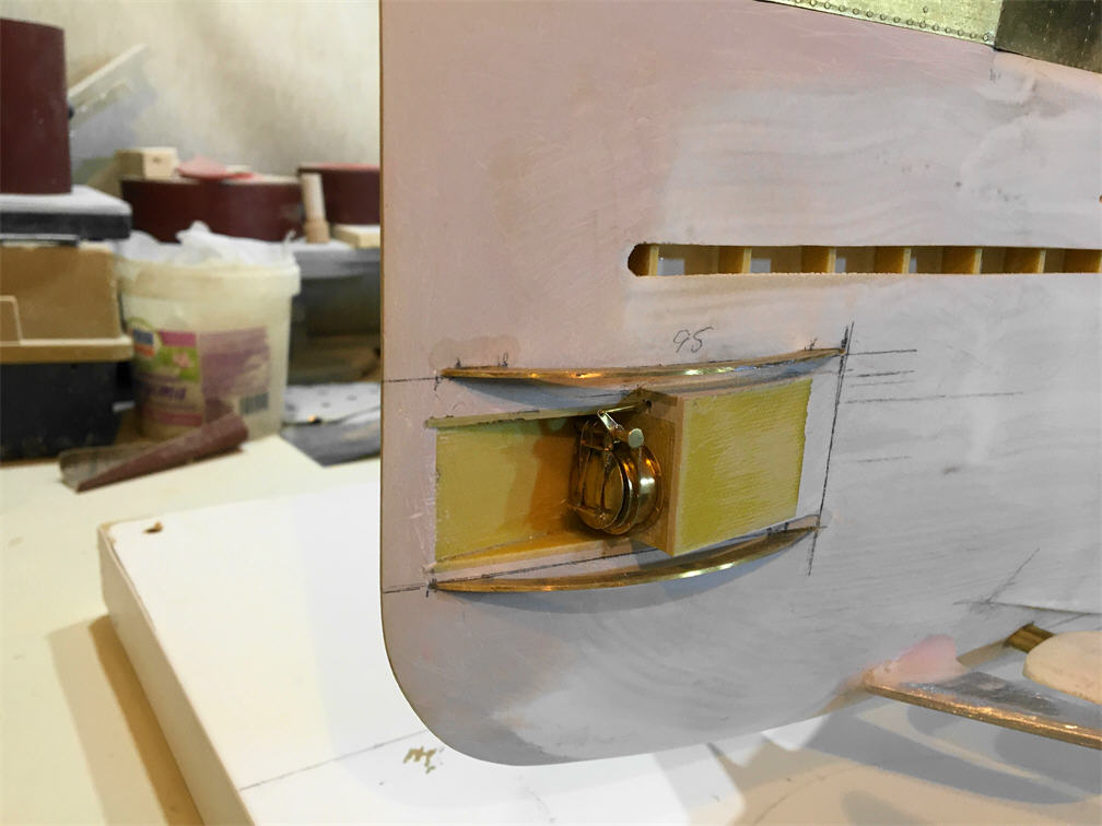

            #65

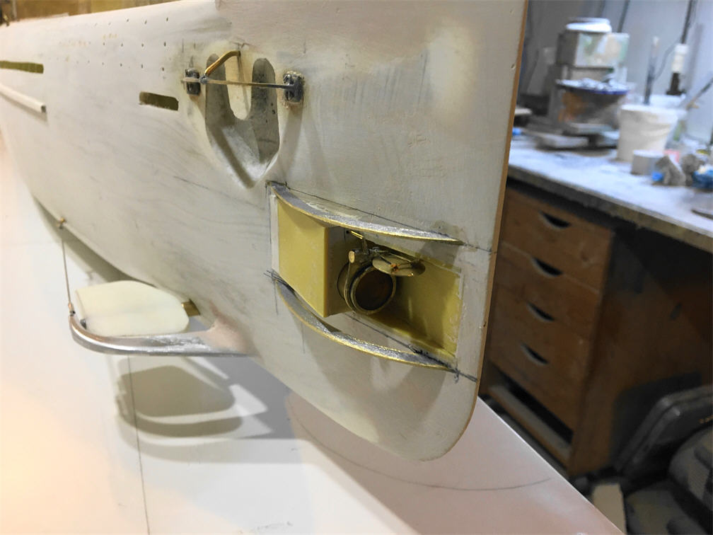

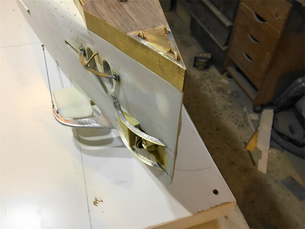

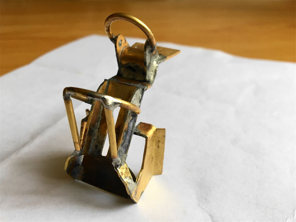

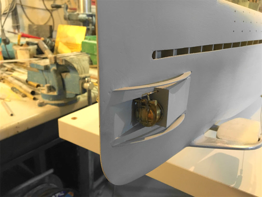

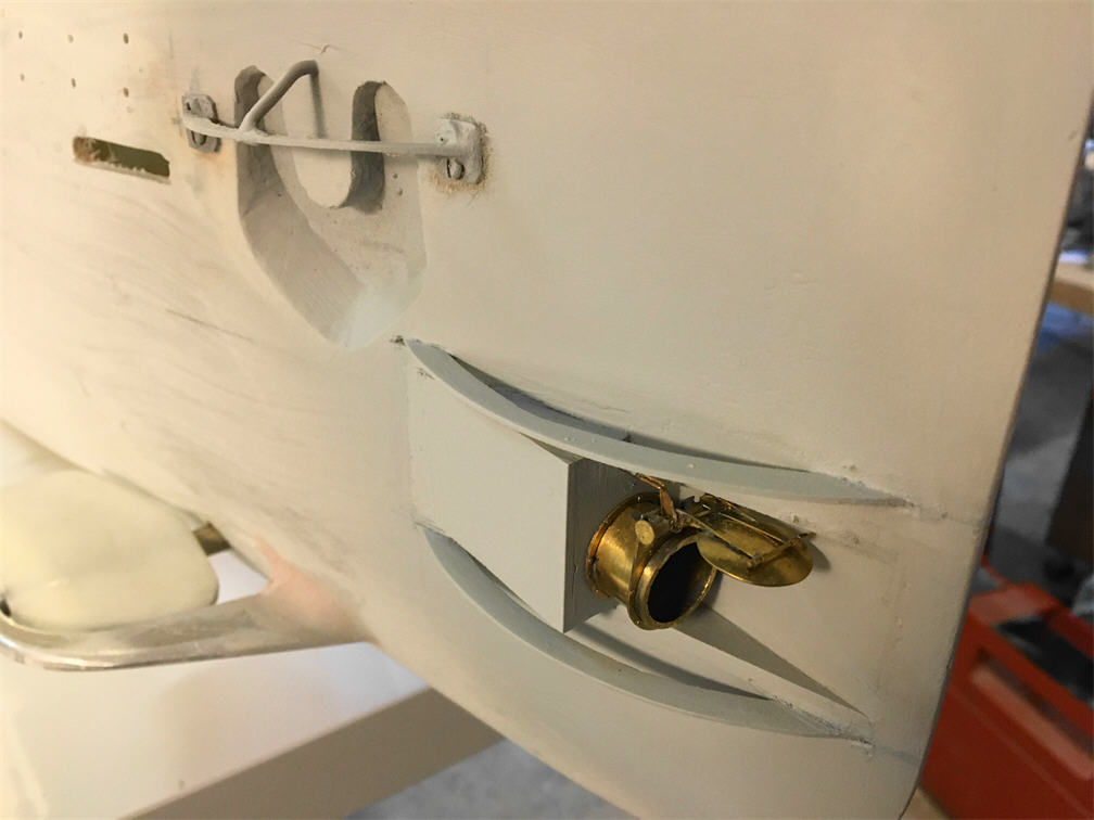

            stern anchor clue
ID:	134653 Click image for larger version
ID:	134654 Click image for larger version

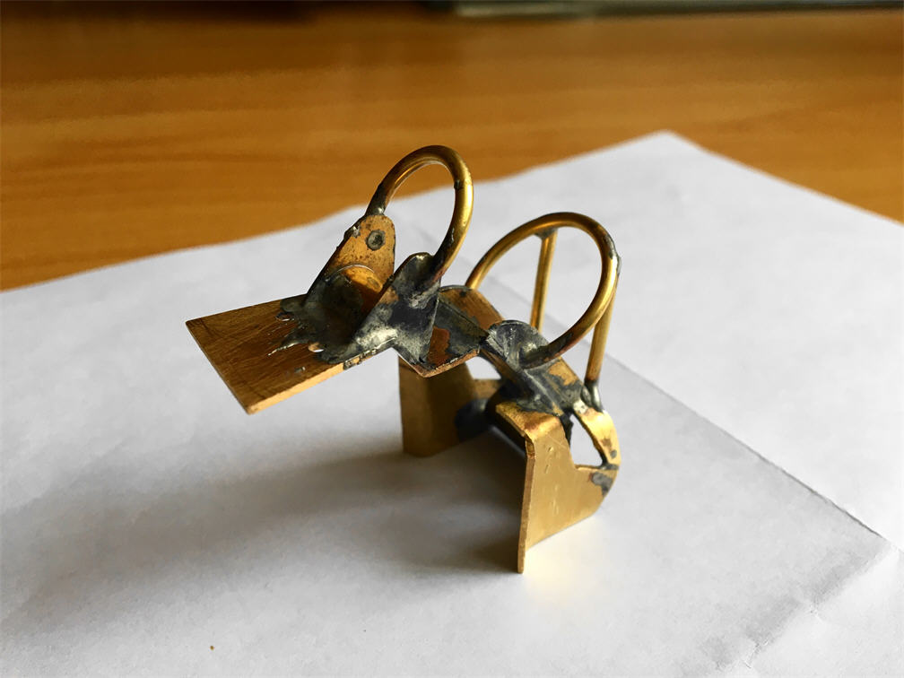

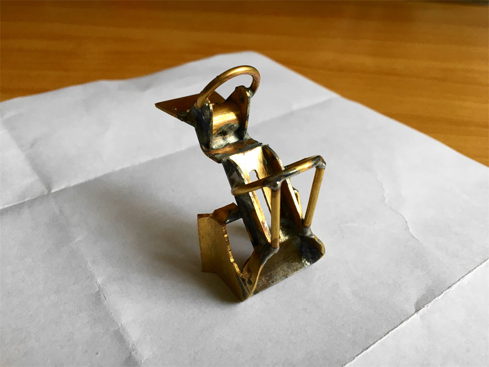

                #67
                Yep, the metalwork on this model is amazing. Thanks for continuing to share it with us.
                Yes, I also had to rack my brains to figure out how to make this.Click image for larger version

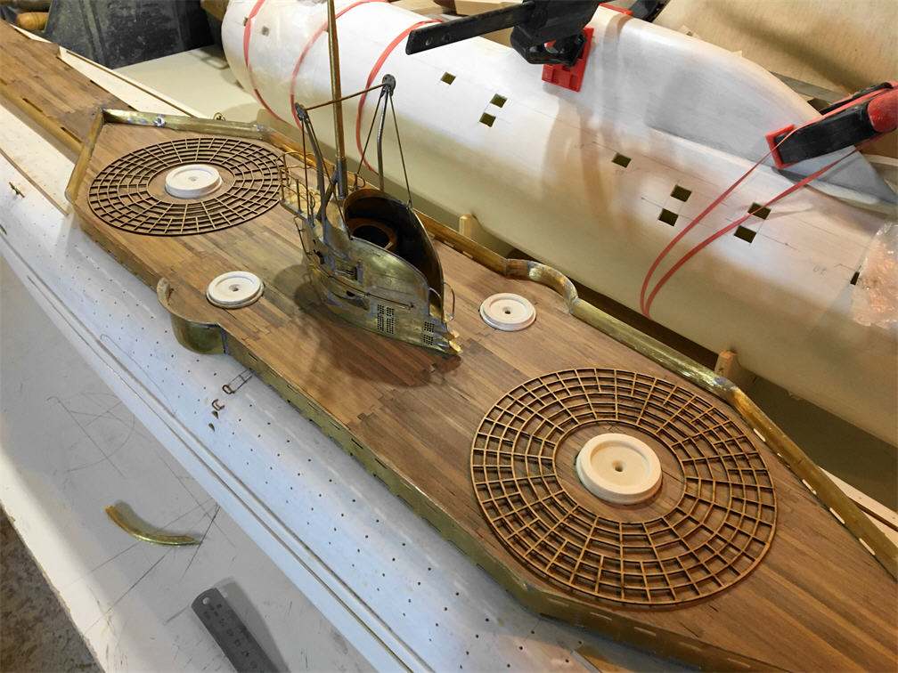

                      • 179
                      #70

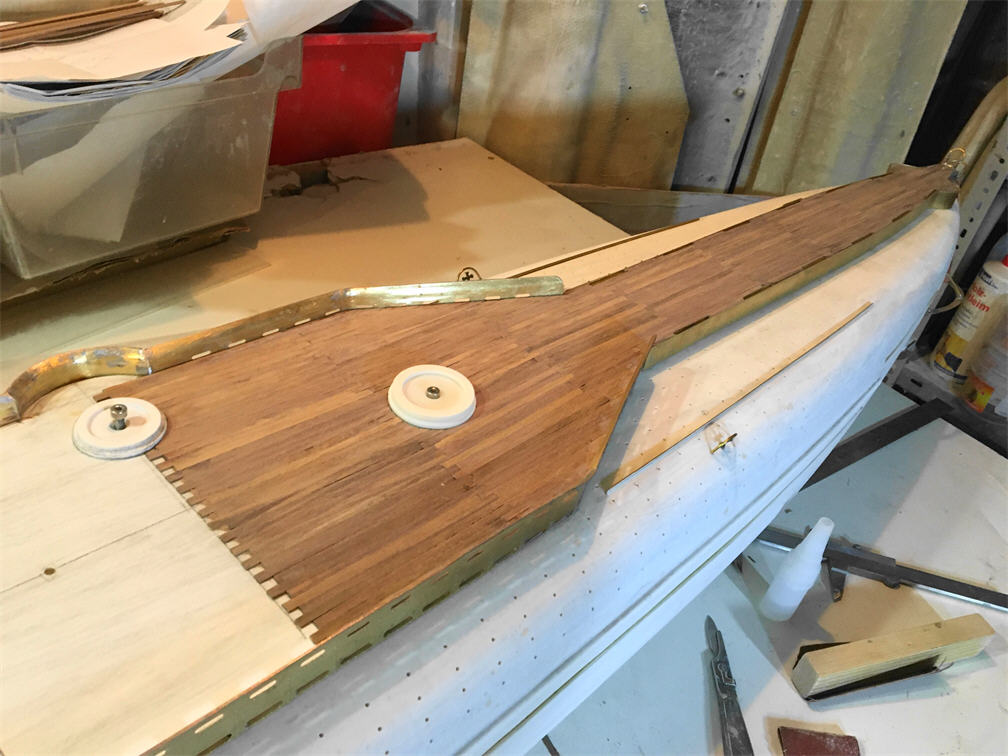

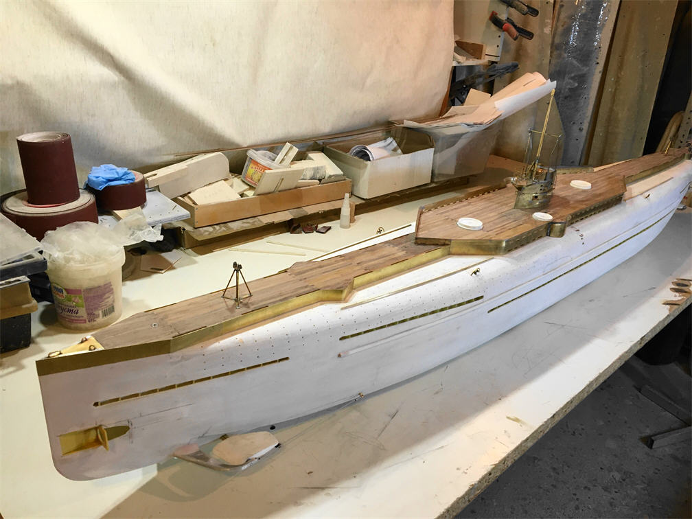

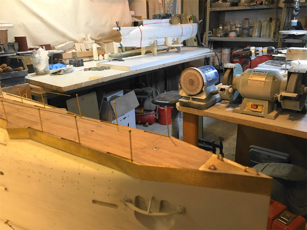

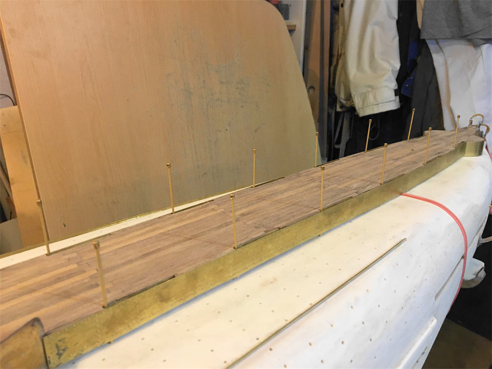

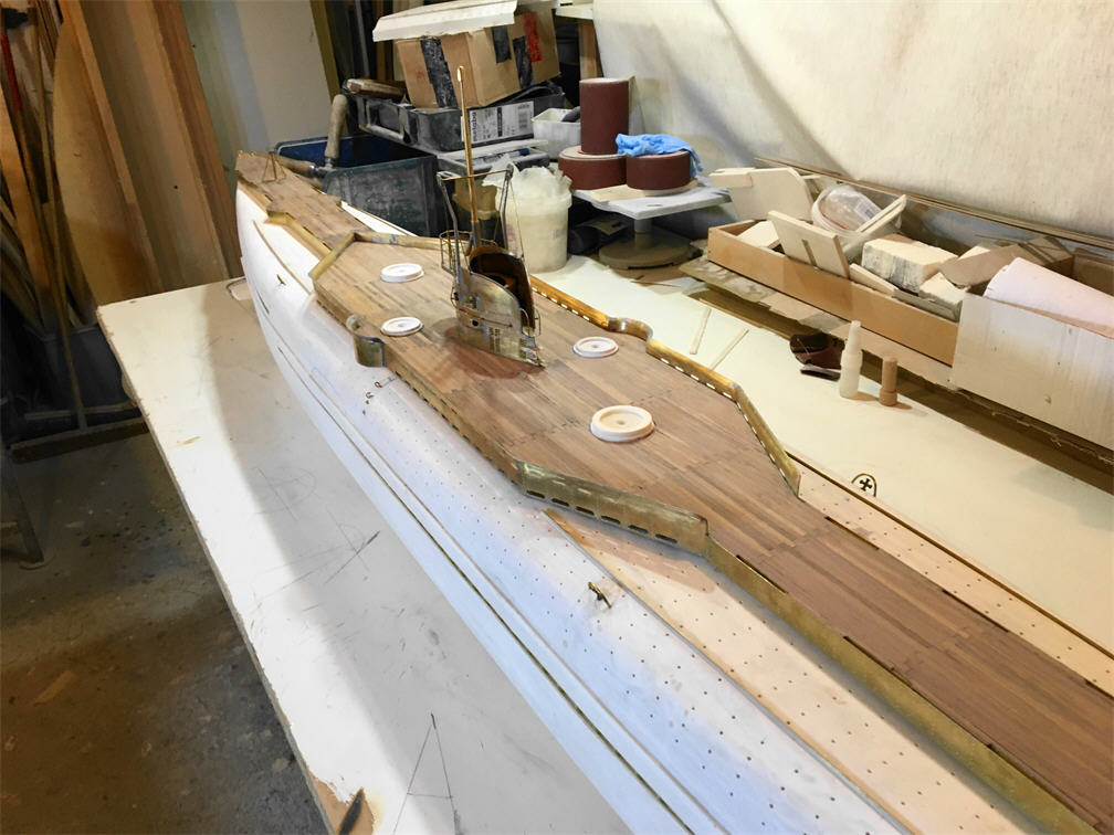

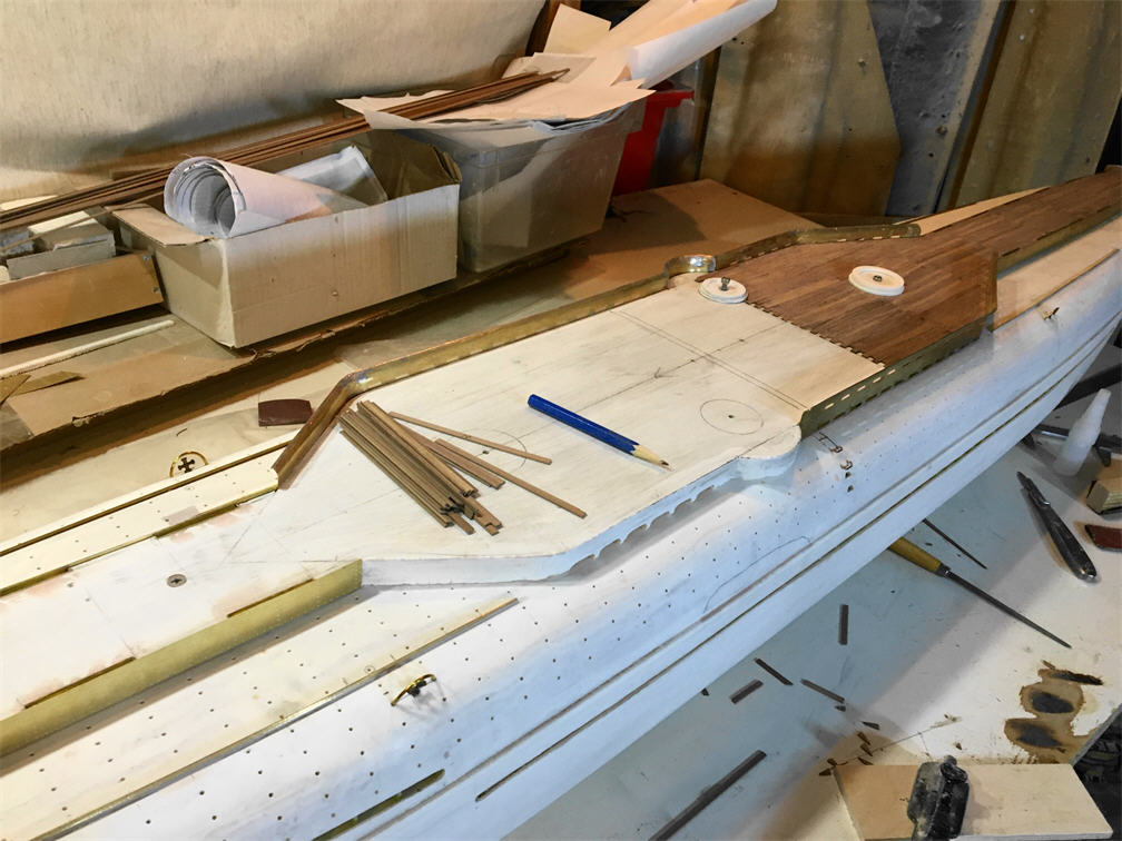

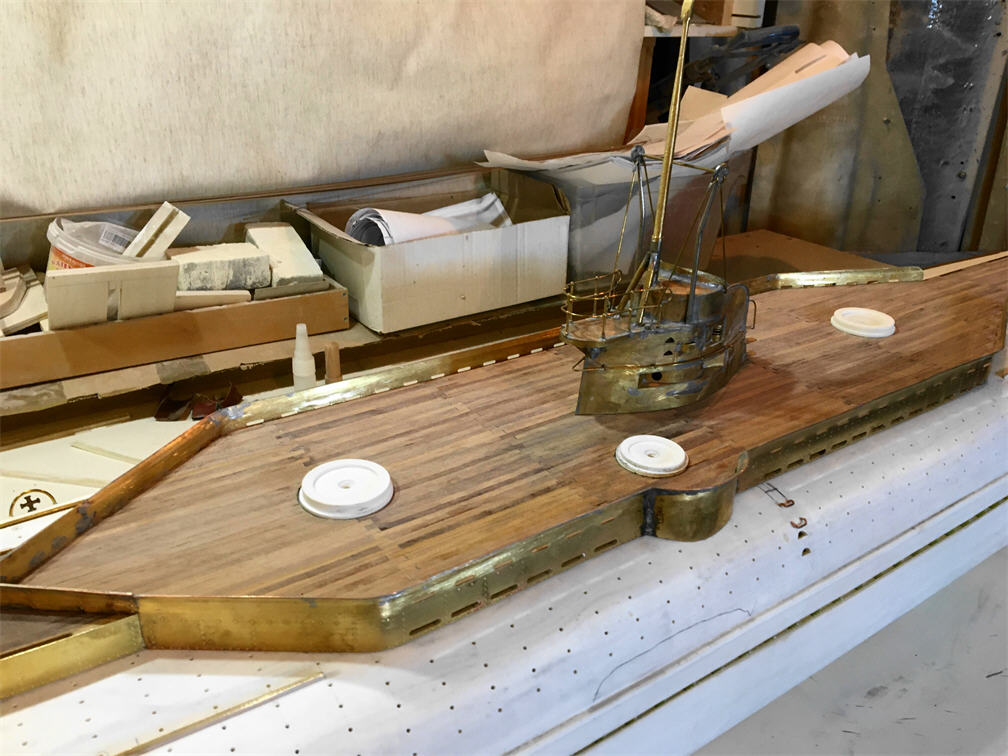

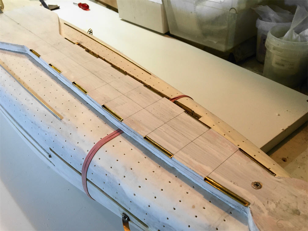

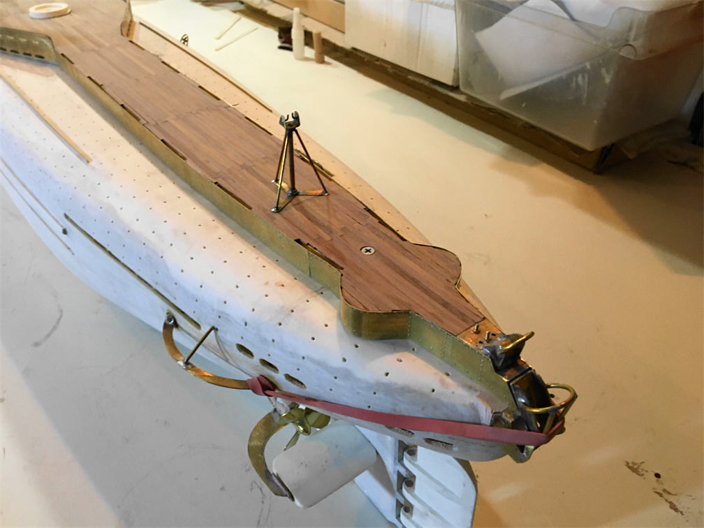

                      I got some details for the boat and continued to work. I installed the bulwarks (unfortunately not all) and began to lay the deck flooring. After examining many of the available photos, we determined for ourselves the dimensions of the deck board. Length -3.5 m, width - 14 cm.
                      Based on this, I cut 4 mm veneer. I chose the color - walnut, because it is most suitable for a tick.Click image for larger version
ID:	134806 Click image for larger version
ID:	134807 Click image for larger version
ID:	134808 Click image for larger version

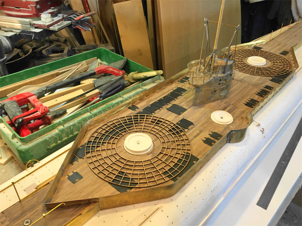

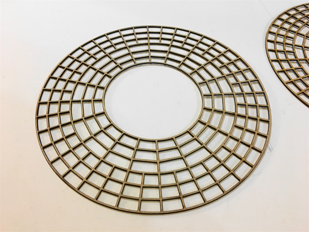

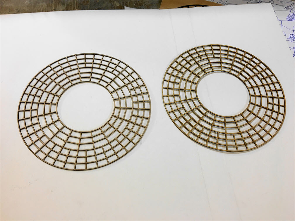

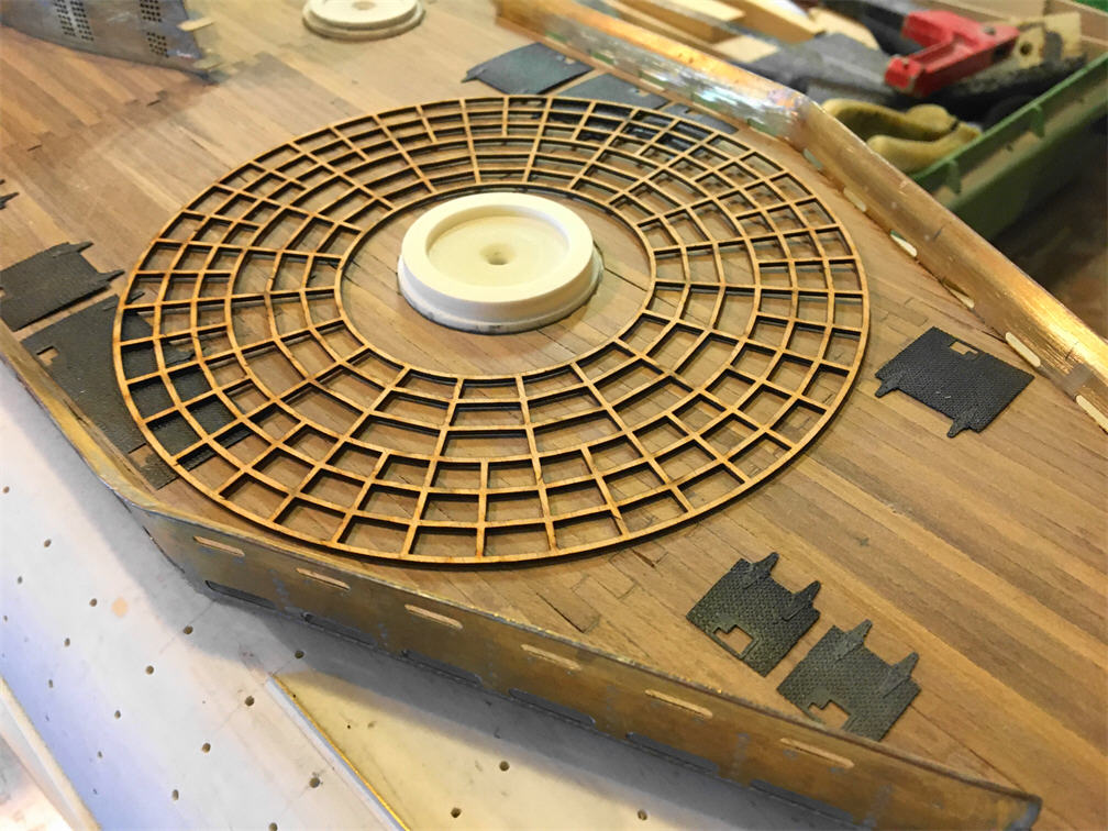

                          Using a laser, anti-slip gretings are made, which are located around the main battery guns. Click image for larger version
ID:	134867 Click image for larger version
ID:	134868 Click image for larger version
                            • 2349
                            #73
                            That brass work is wonderful.

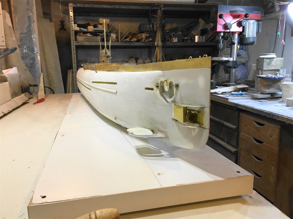

                              installed torpedo tubes Click image for larger version

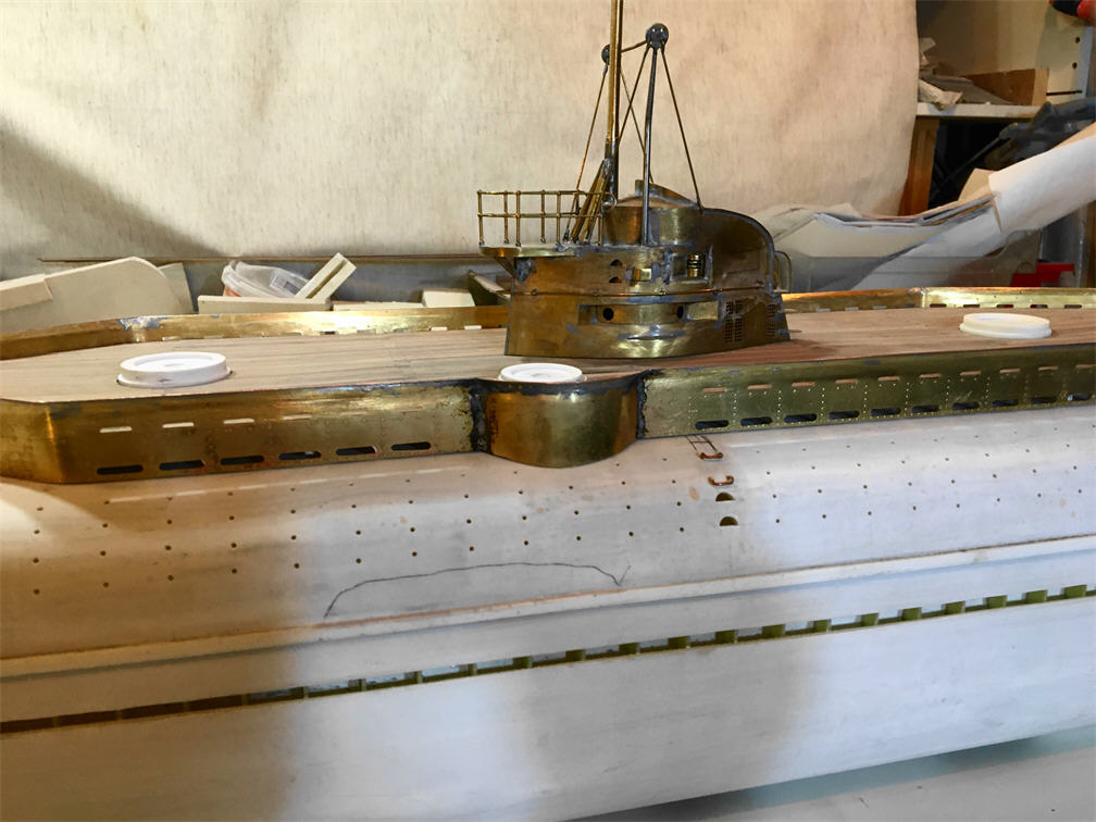

                                #75

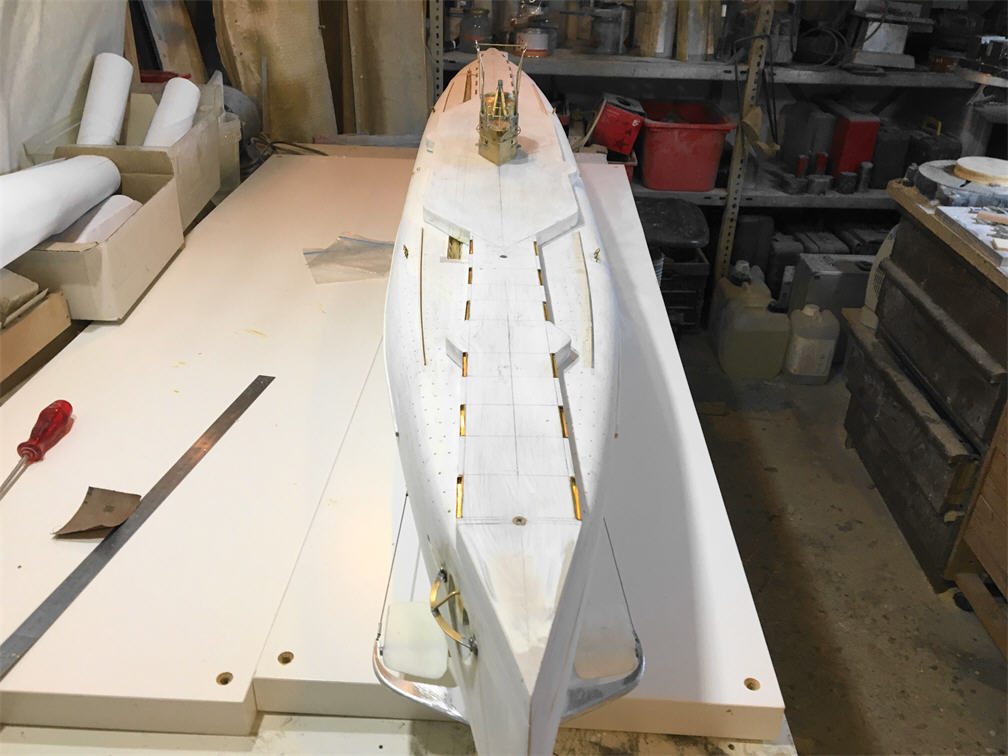

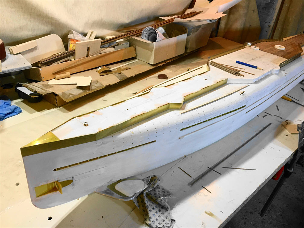

                                Placed technological hatches in place and installed railing racks (temporarily for now) Click image for larger version
ID:	134887 Click image for larger version
ID:	134888 Click image for larger version
ID:	134889 Click image for larger version
ID:	134890 Click image for larger version
ID:	134891 Click image for larger version
