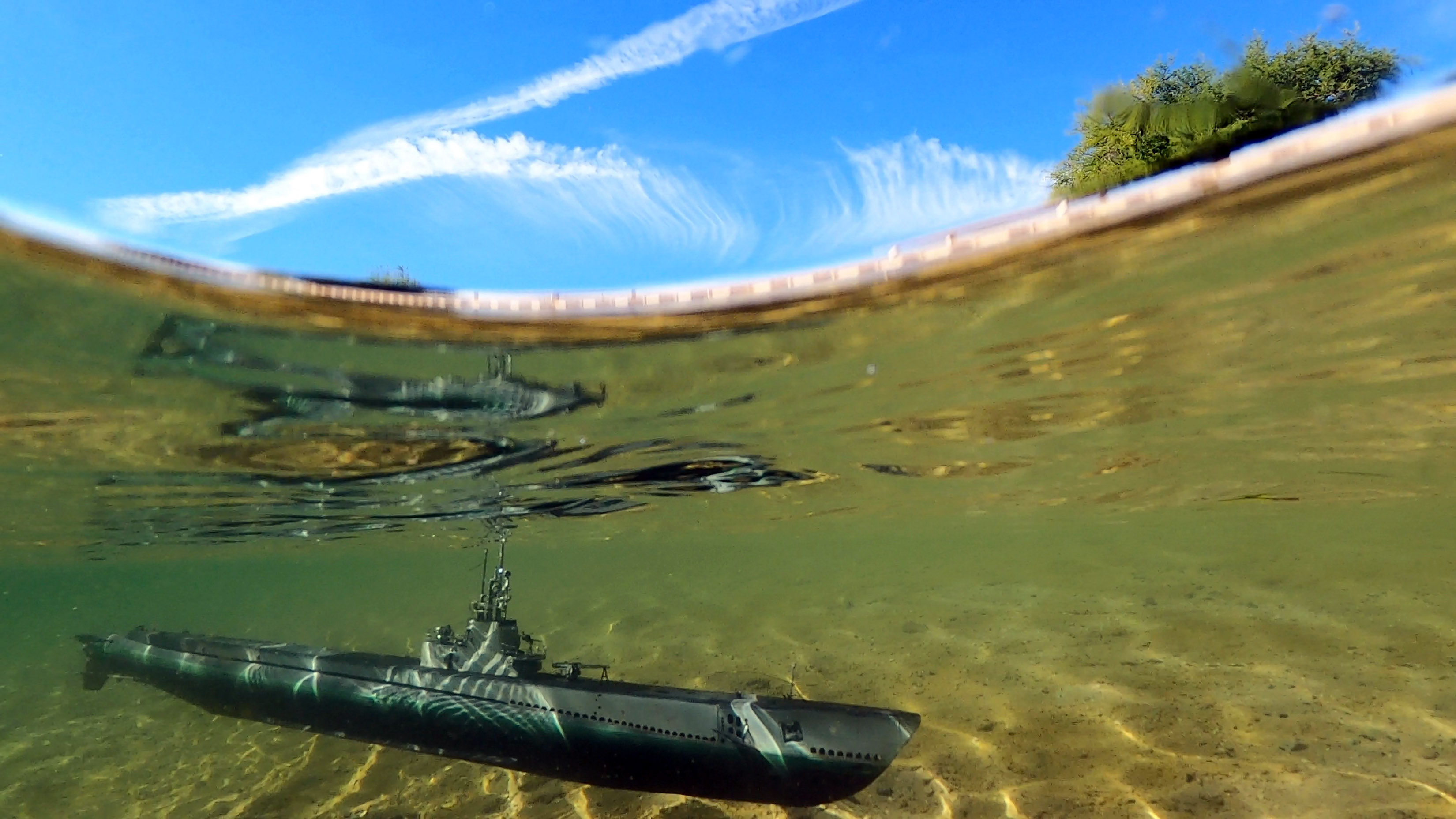

    This Photo is several weeks old, it was taken at a Nevada state park called the Big Bend of the Colorado. There is a lagoon off the river that is fantastic to run subs in. ESPECIALLY since it has cooled down and the park is empty. Had to do some tweaking on the sub the ballast blow and vent needed adjustment, but once that was done the Gato ran great.

      Looks great Tom. Nice and clear water. This a very in depth Gato thread. I must study this more when I come to build mine. Great info.
