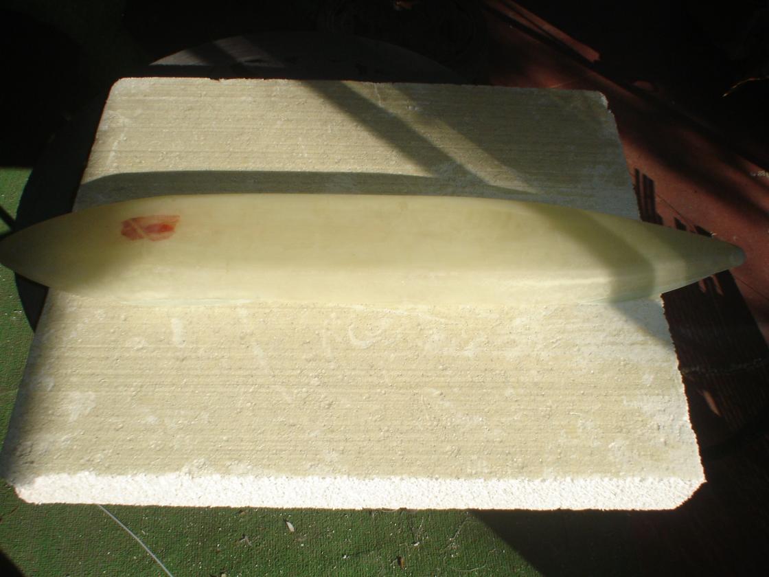

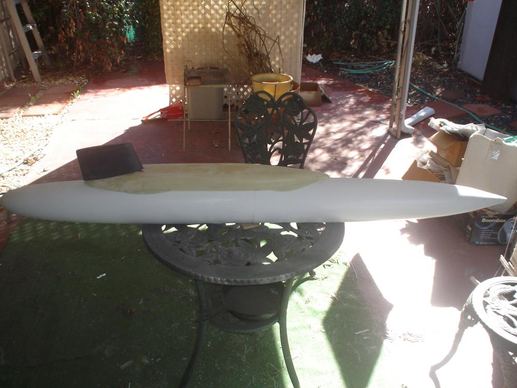

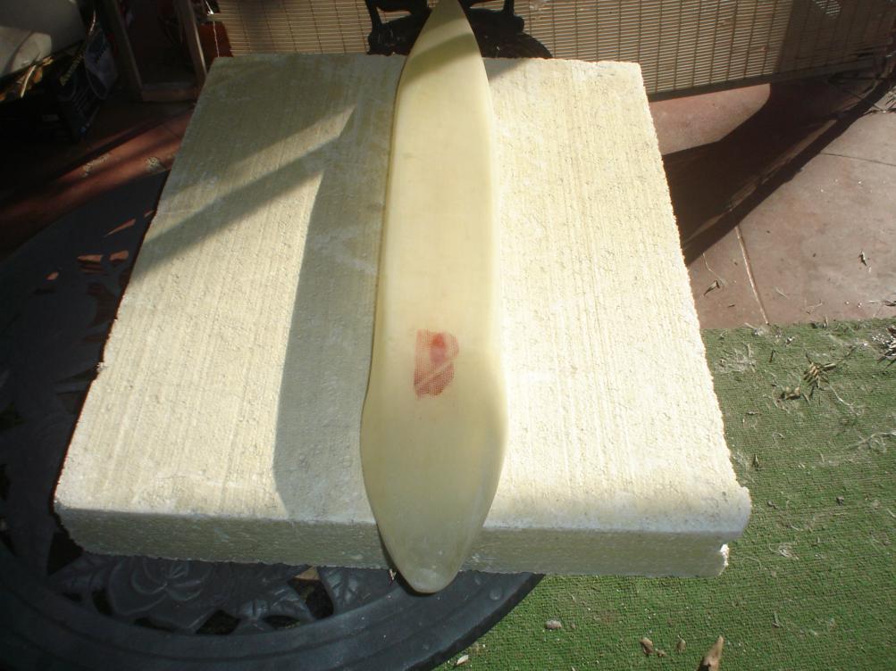

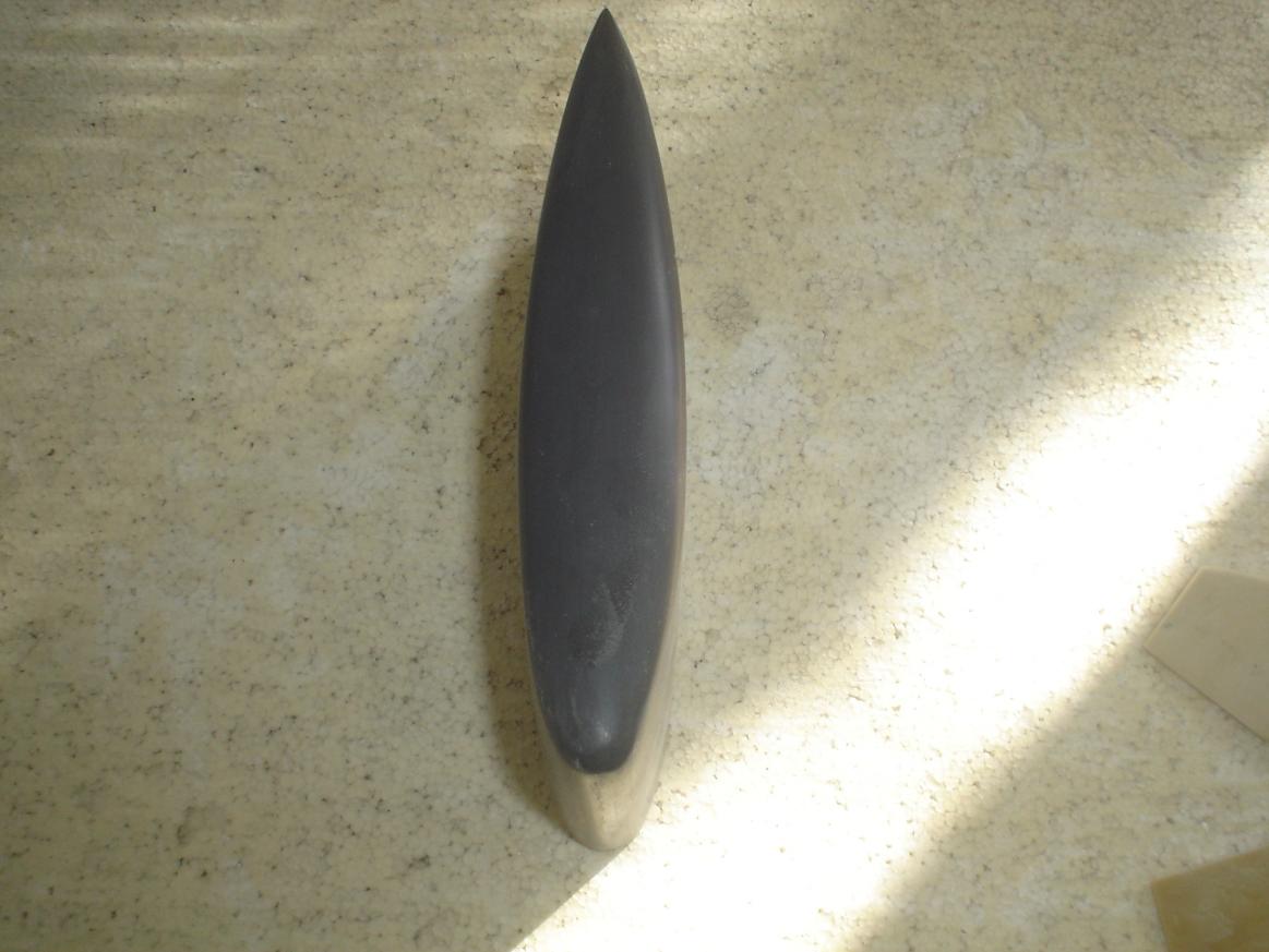

    OK guys first time on here. Tim Cobb here. Been working on plugs/molds for a 1/72 598 SSBN. I was on the Abraham Lincoln SSBN 602G. Sail is done except for scribe detail. Appendage molds done. Resin cast some parts. Hull plug just have to glass it and scribe detail. Turtle deck have to scribe details in it. Should have molds done in less then a month. Almost done with plugs for a 1/72 Thresher. After those are done my next builds will be a 1/72 Victor III, 1/72 Yankee II and a 1/72 Charlie II.

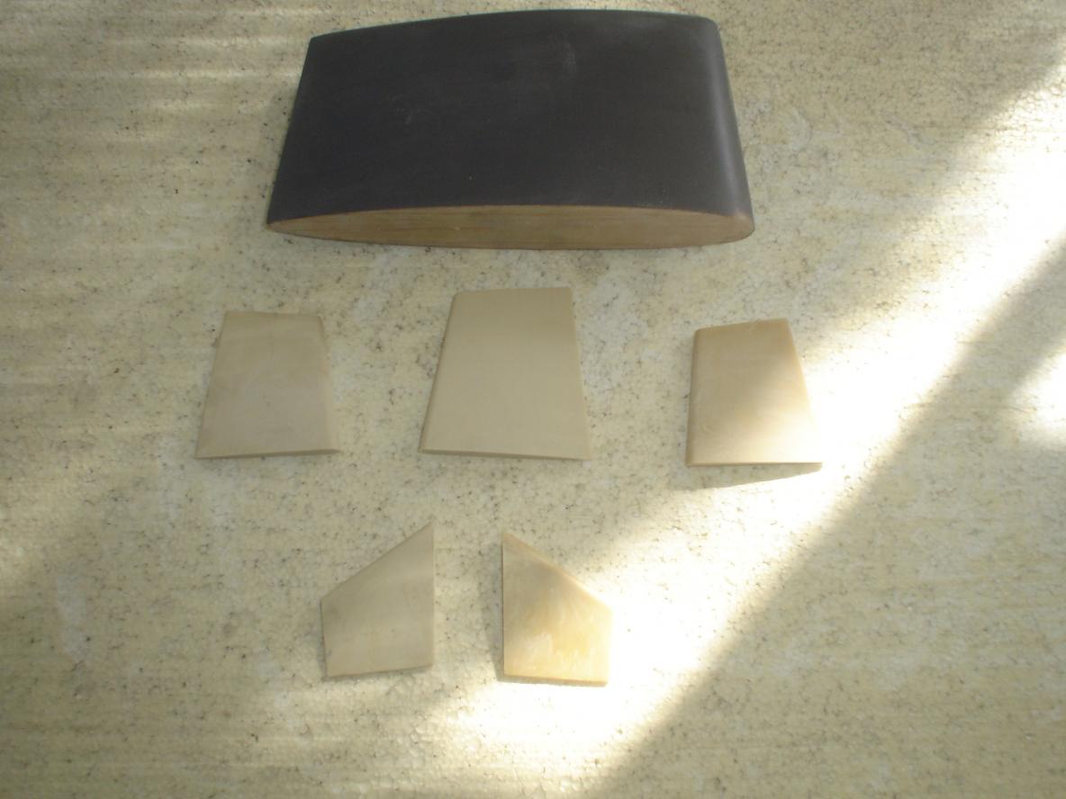

      1/72 Abraham Lincoln SSBN 602 build

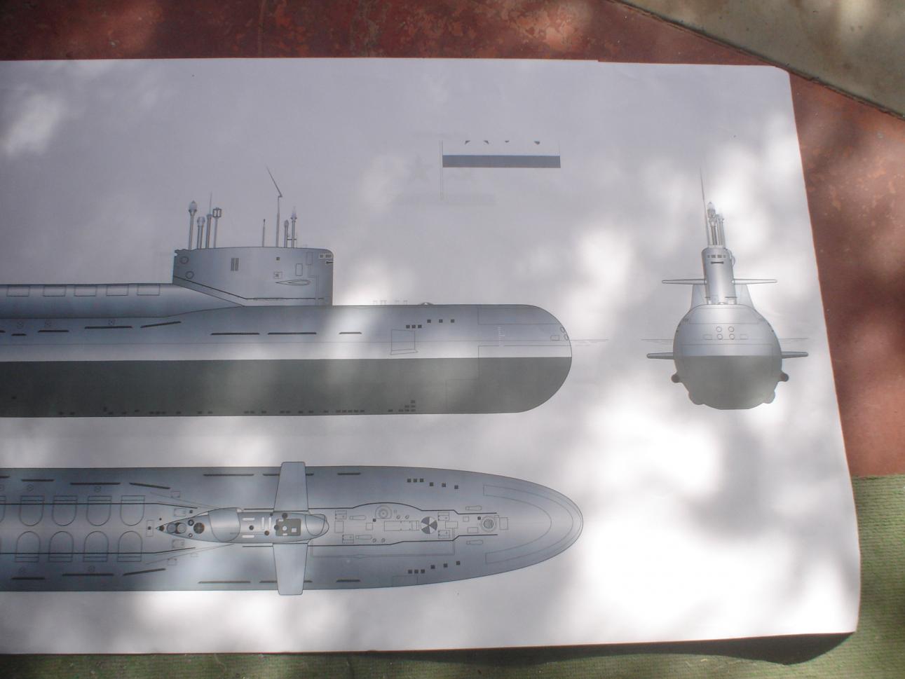

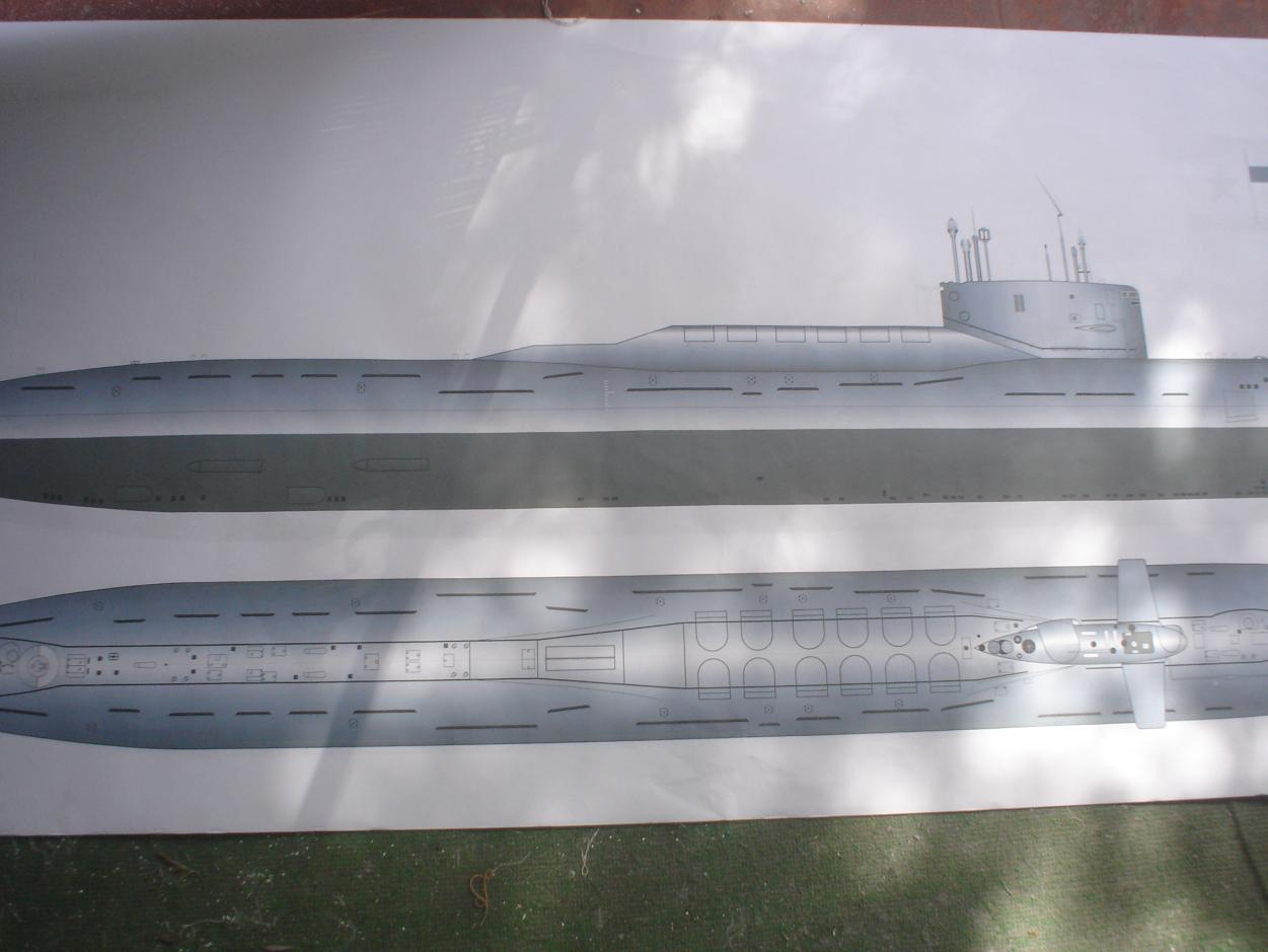

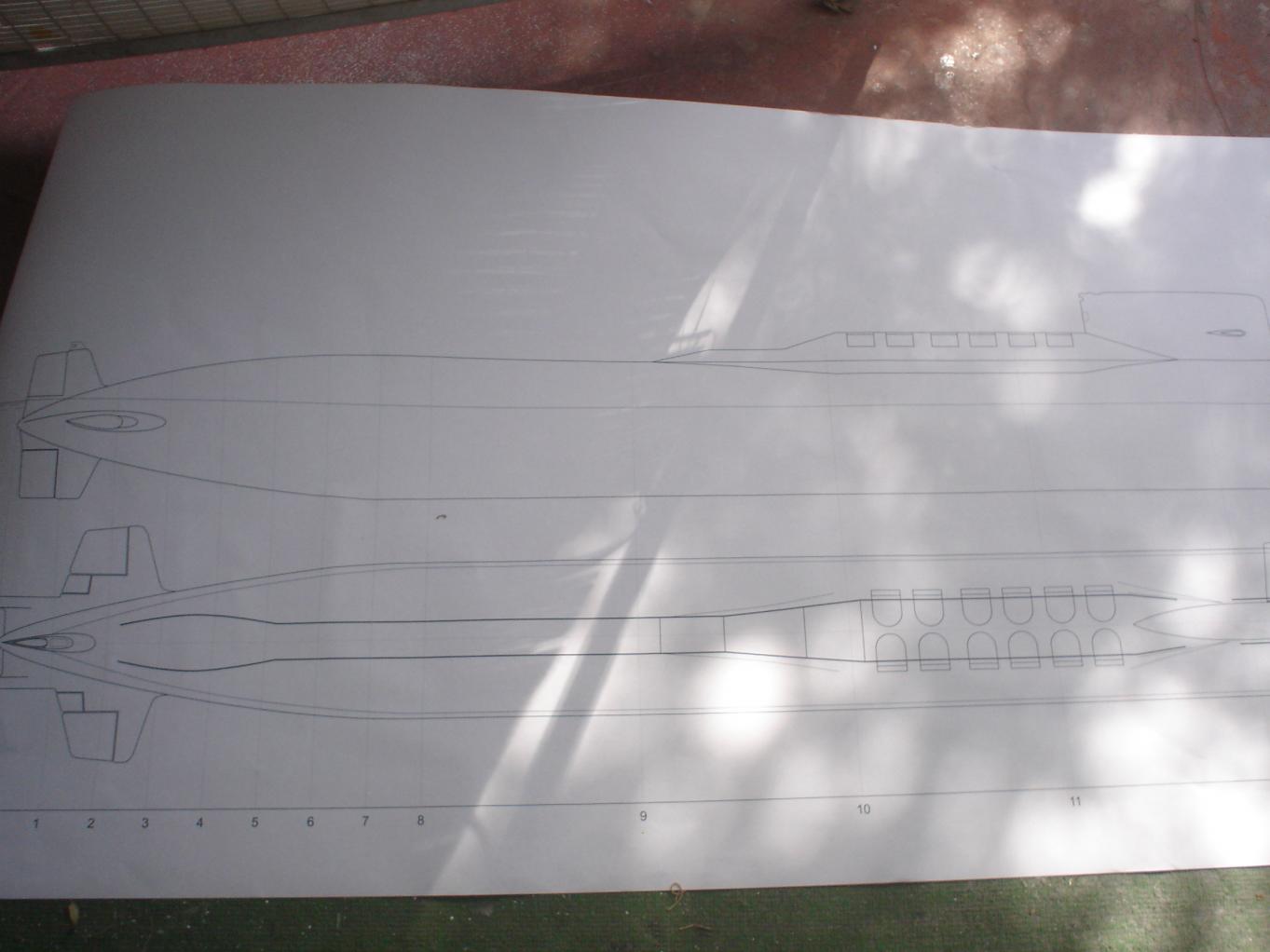

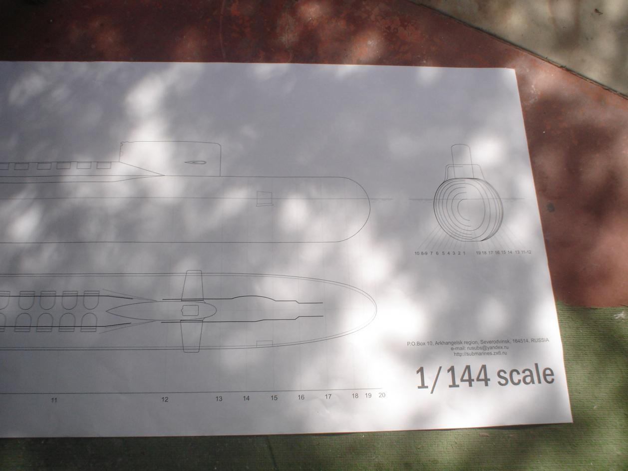

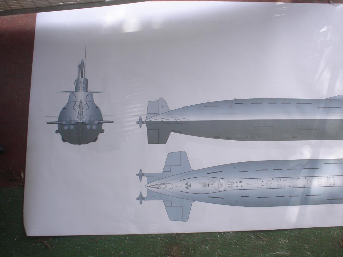

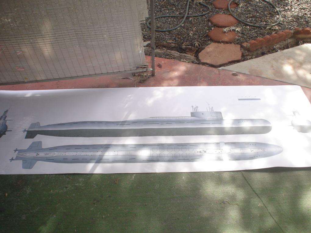

      I make the hull plugs out of styro foam. Use 2lb+ foam about 3" thick. Sail and appendages I shape out of hard balsa. Glass over the all balsa parts. I use RTV silicone mold stuff I get off ebay. I figured out how to make the appendage molds from one mold instead of split molds. I will post pics of those molds tomorrow as it got too dark in my work area and I normally only work in sunlight for best results. I make my own scribe tools using old needle files. Molds I made in past are 1/72 Alfa, 1/72 Golf II, 1/72 Charlie I and the 1/96 Delta III. I think Bob Martin has some of those kits for sale. Dob Spielberger of Loyalhanna owns the molds to those. Here are some pics of my enlarged Yankee II vector drawings. Behemoth at 72.5" long.

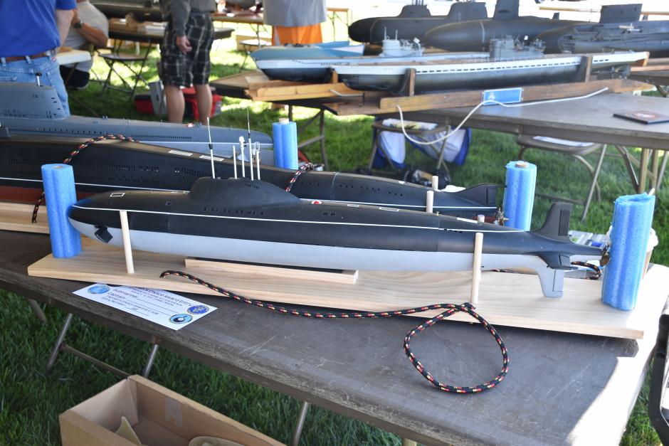

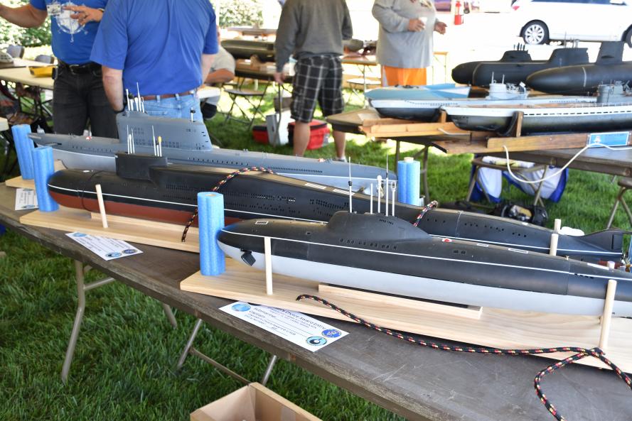

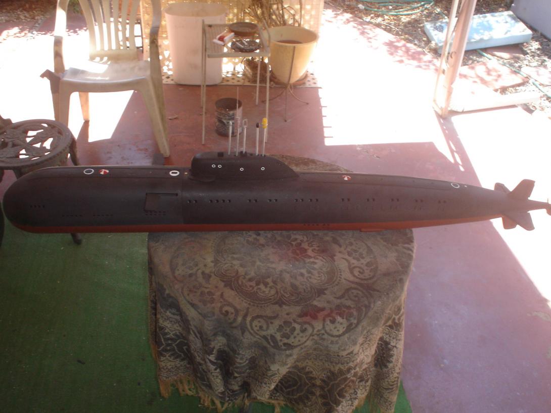

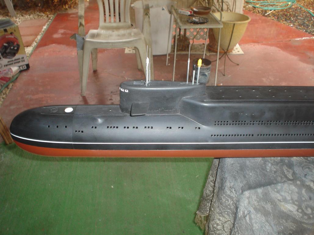

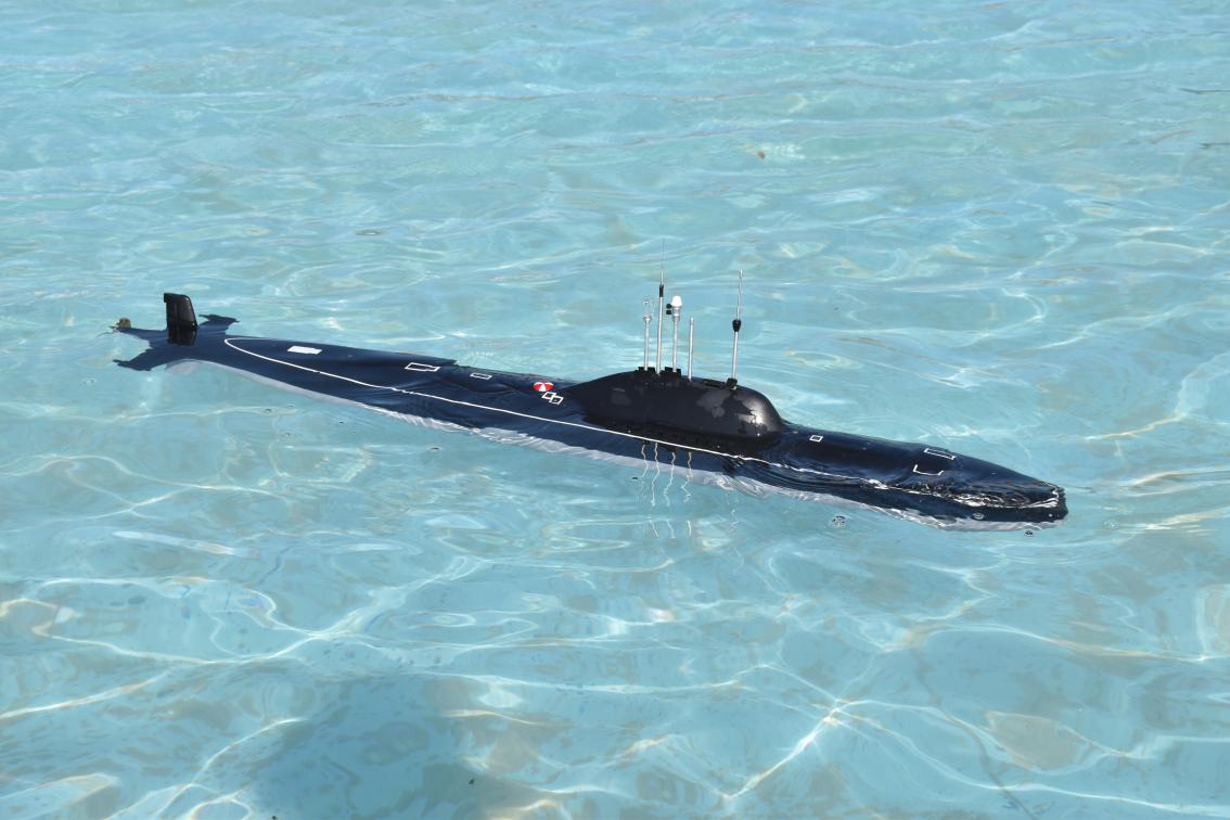

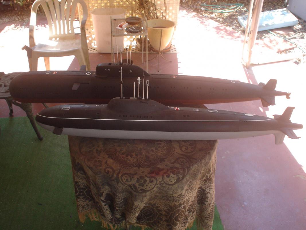

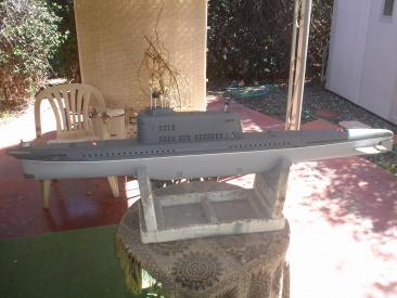

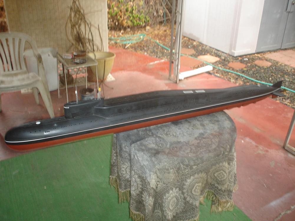

        Pics of the boats I made from my molds.
          Ohhhhh.....I like that Delta! What scale is she?
          • 598602G
            • Mar 2018
            • 71
            That is 1/96. My favorite is either the Charlie I or the Golf II.
              Some more pictures of Tim's work.
                I always wanted to build a Golf. So Type XXI-ish, yet so ugly...
                beautiful models.

                  Bob pics look great. Makes me sick I sold the boats. Trying to get Don to make me those boats from the molds. I still think the Golf II is my favorite. I will post some more pics today of the 598 and the Thresher plugs.

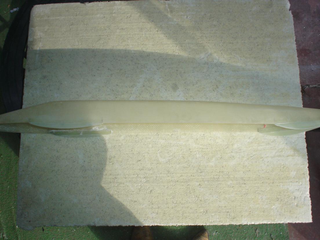

                        Don thanks. Hope your health gets better. My breathing has gotten worse so I am really going to start getting this house sold and move to Dallas. Have to order another gallon of resin so I can finish up 598

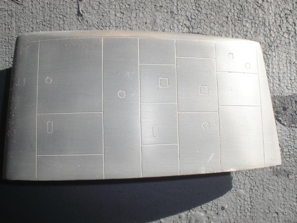

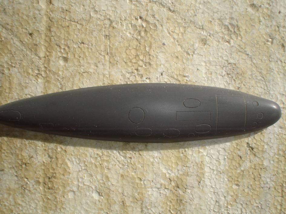

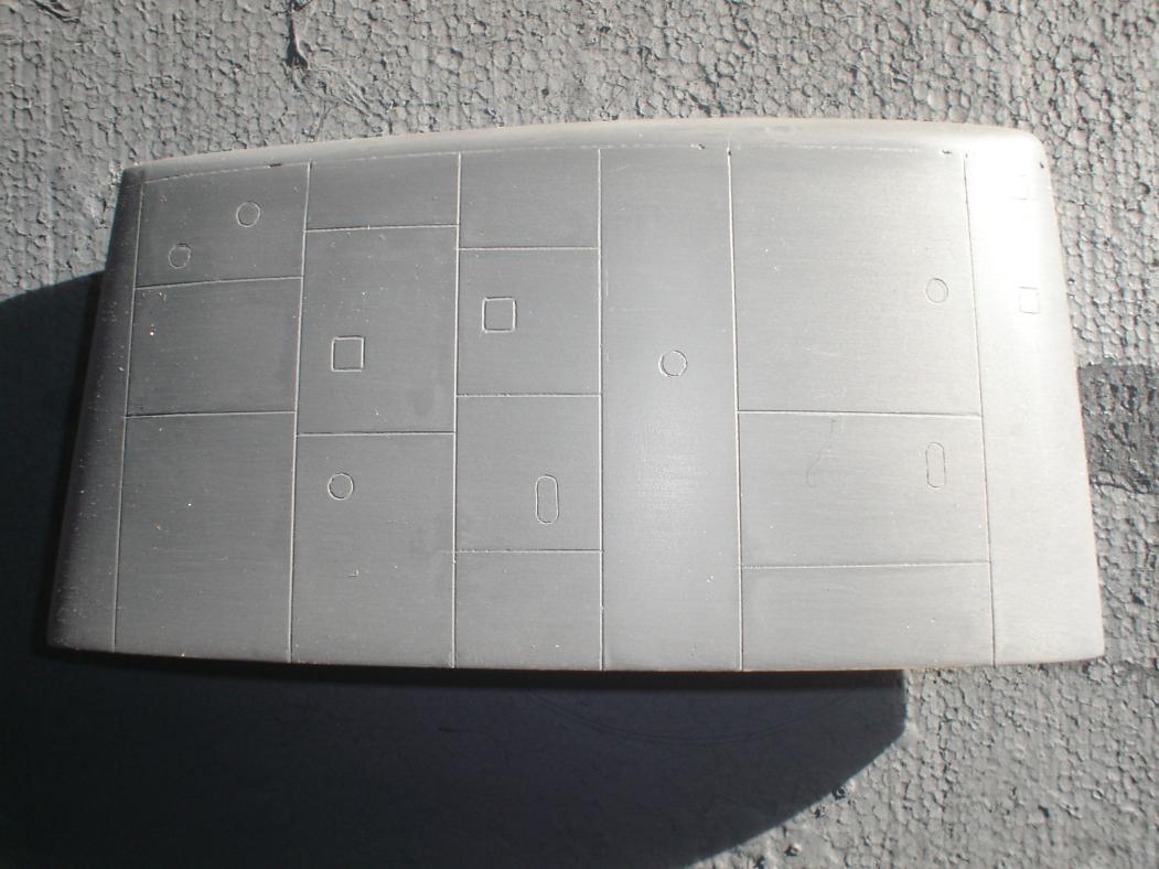

                          Pics of the sail. Top of the sail I am going to resin cast that as much easier to manufacture. Forgot about the access door into the sail so will scribe that tomorrow then it is ready for molding. Click image for larger version
