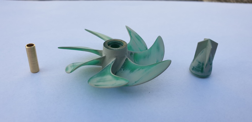

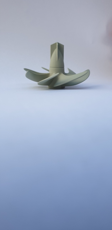

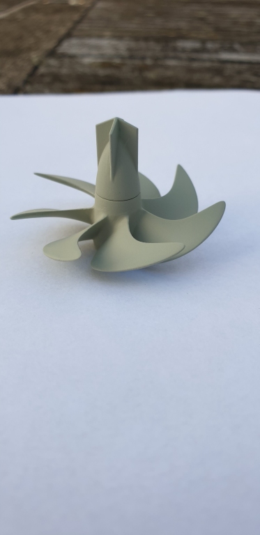

    Torque will be ok, the pitch and projected blade area are proven, even the developed area of the blade is not so large as the blades themselves are quite narrow.
    Meanwhile I made also the high skewed prop.

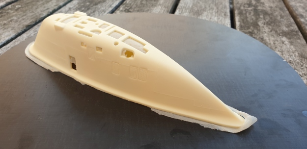

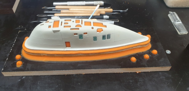

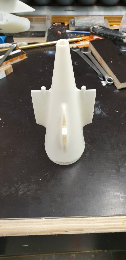

            just some progress pics
            Sail tooling and casting

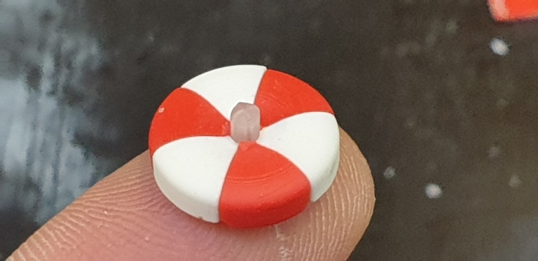

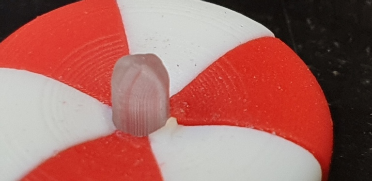

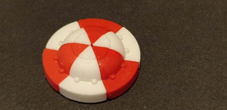

            Escape module hatch and locator buoy

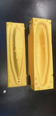

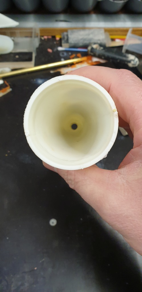

            Hard shell for the hull tooling

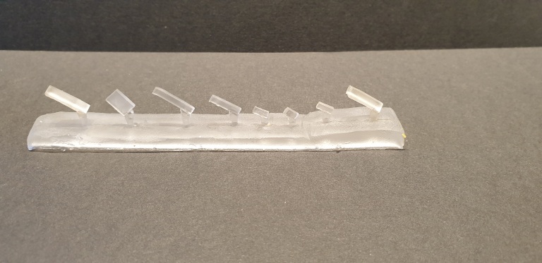

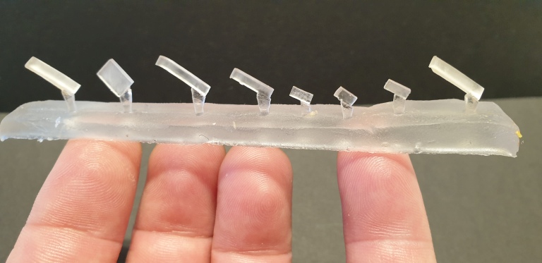

            Camera enclosures and windows of the bridge wind deflector casted in clear resin

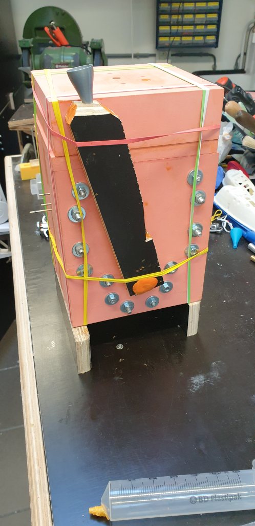

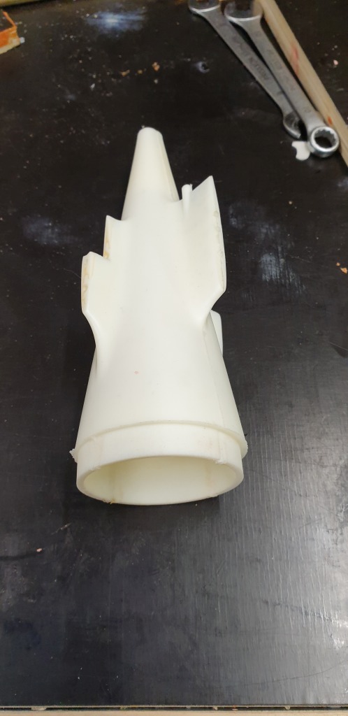

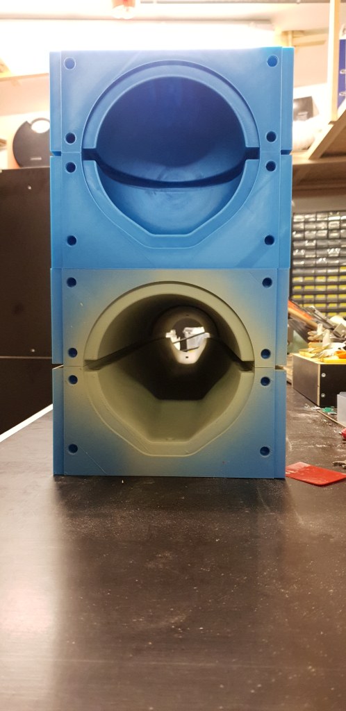

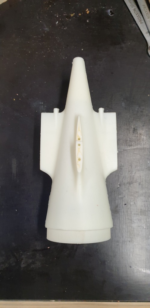

              The most complicated resin cast I ever did worked out beautiful. 13 cores were inserted.
              1 x propshaft, 8 x dowel pins for rudder and planes, 4 x rudder and planes stock,
              Pictures right after demolding.
              Grtz,
              Bart

              The tooling ready to take the resin

                • 1325
                #52
                holy crap, that's a complicated tool. the part looks awesome Bart!

                    That is very nice. Did you take any pictures disassembling the part from the mold?
                        I made a video for you, hope this helps, here is the link https://fb.watch/2KO3ft8_Ih/

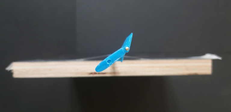

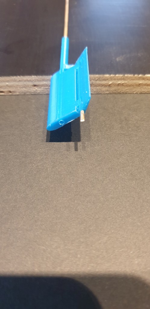

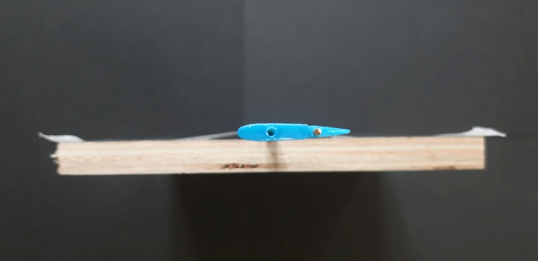

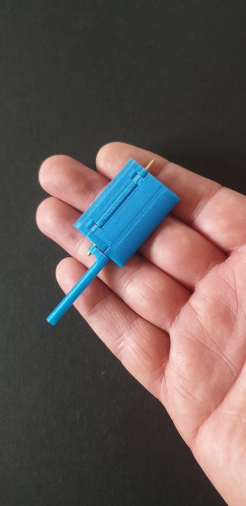

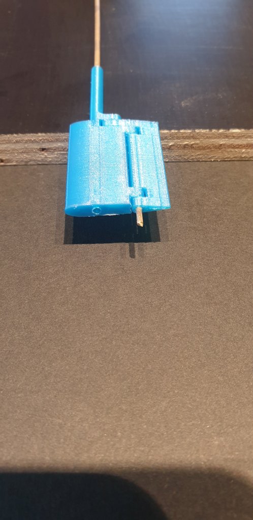

                            Last of the outfittings.
                            Spent most of the yesterday on designing, tweaking of the fwd dive plane until I had a working prototype.
                            The plane is a “flap rudder” type or “multi-section” rudder. The hinged aft section gives the rudder an extra control surface therefore enhances its efficiency.
                            When the helm is applied the angle of attack of the main control surface changes (working of a normal rudder), in addition the angle of attack of the flap also changes.
                            If the main rudder rotates 45° the flap turns an additional 45°. The flap is making a 90° angle to horizontal.
                            Pictures showing both 0° and 40°
ID:	135196Click image for larger version
ID:	135197Click image for larger version
ID:	135198Click image for larger version
ID:	135199Click image for larger version

                              #59
                              Excellent. Simple operation, but a nice detail to add!
