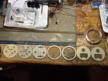

        Working on the tech rack bulkheads. Almost done with them. BDClick image for larger version

        Crapola! I did it again.

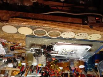

            Here is a photo of the finished tech rack bulkheads.
            This time I checked to make sure it is right side up.
            Hopefully. BDClick image for larger version

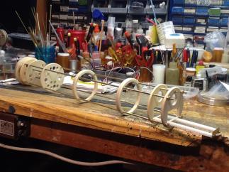

              The tech rack is done. Just needs the components and wiring done. BD

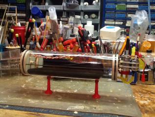

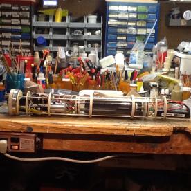

                            Working on the final assembly of the tech rack.
                            Greg informed me the new valve was in.
                            My work is almost done. He ordered some shaft seals tonight.
                            With the pressure buildup inside the cylinder the stuffing boxes would I fear not hold the pressure.
                            So seals will be added. BD

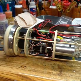

                              I tested the new 6V valve today and it works flawlessly.
                              Everything fits and works.
                              Just a little wiring left to do.
                              The cylinder uses 6 channels.
                              Front and rear planes, rudder, ballast, and two throttles.
                              True to his PITA name Greg wanted two ESC's for separate propeller control.
                              I have to keep the Tallman happy.
                              He is my Mini mechanic. BD
