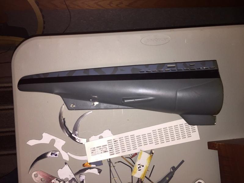

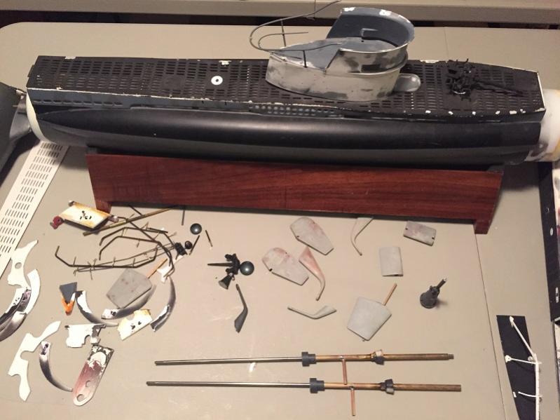

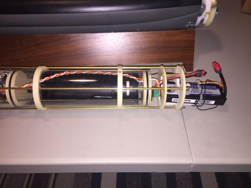

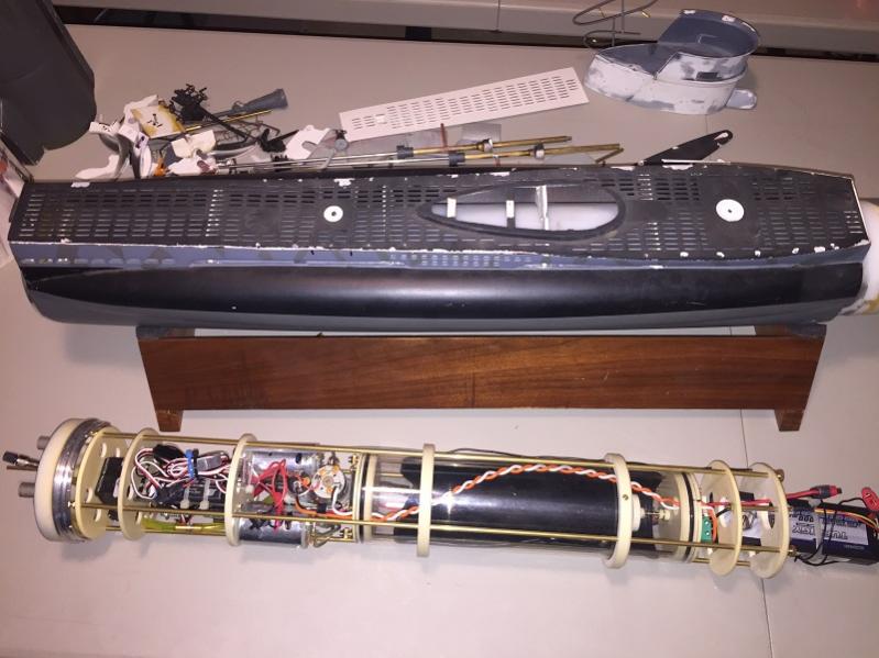

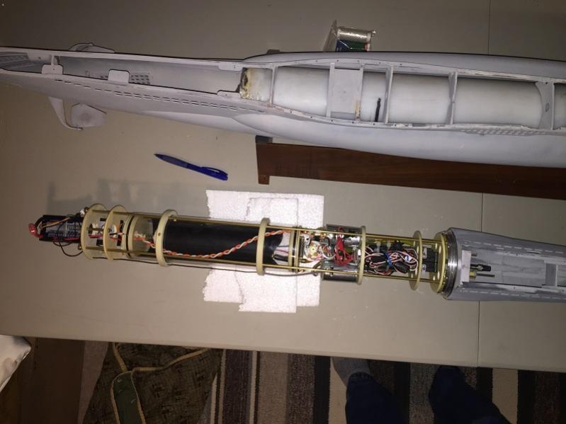

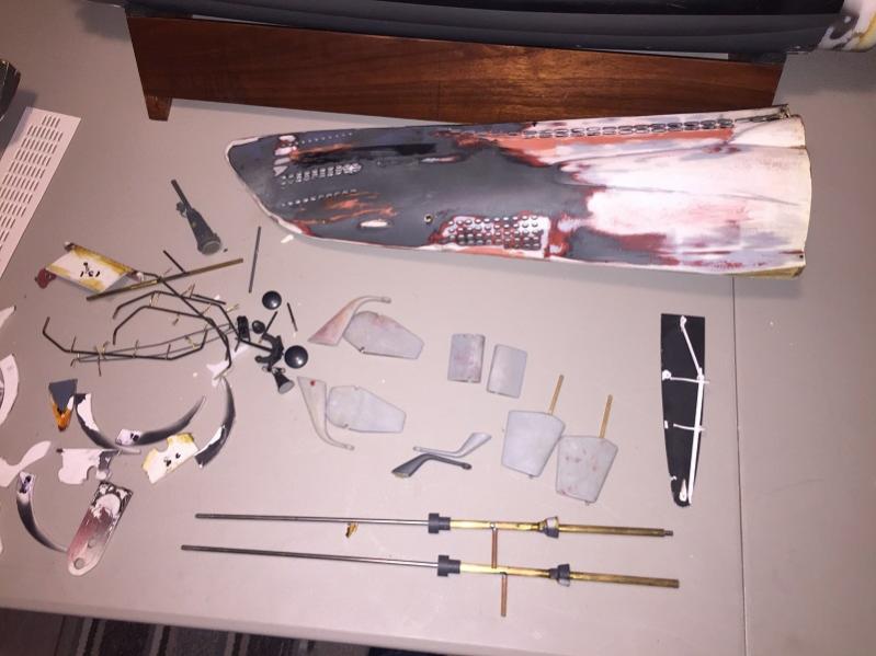

      here are some pictures of what I have . There is also alot of collars and bits and pieces not shown. Thanks again to Jim Smith. I also want to thank Jeff LaRue for donating the missing deck section. It will only cost some SC articles.Also there are a few pictures of the tech rack that BD made. He does awesome work. You just need to know how to butter him up.cookies, chex mix and being a persistant PITA works well. More to come when there is something to show. Greg W aka Mr PITA

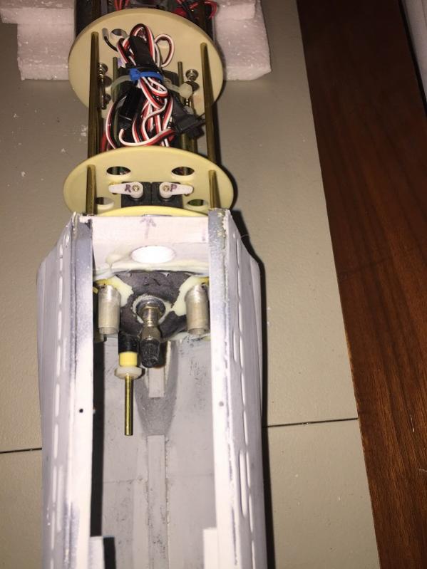

                    Well here is an update. My motivation is starting up again. I am sure BD would want me to continue as he felt the cylinder was some of his best work. I have attached the bow section to the center as well as putting on the bow plane supports.
                    I also fabricated a stern bulkhead out of some 1/2" pvc that I glued to the stern section and then to the rear of the rack. The wtc tube is not glued into the center section yet. I want to wait until after initial ballasting is done so that I can put any extra lead in the very bottom of the hull. Next will be fitting out the stuffing boxes and the rear control supports. I am also looking for any layout info on the conning tower floor. The Robbe tower has no detail to it there and I have seen pictures of photo etch but it isn't availble anymore. Does anyone have a layout pattern for a type VIIB and what size the holes should be. I realize this model is not perfect but I know I can make it better. Greg W
