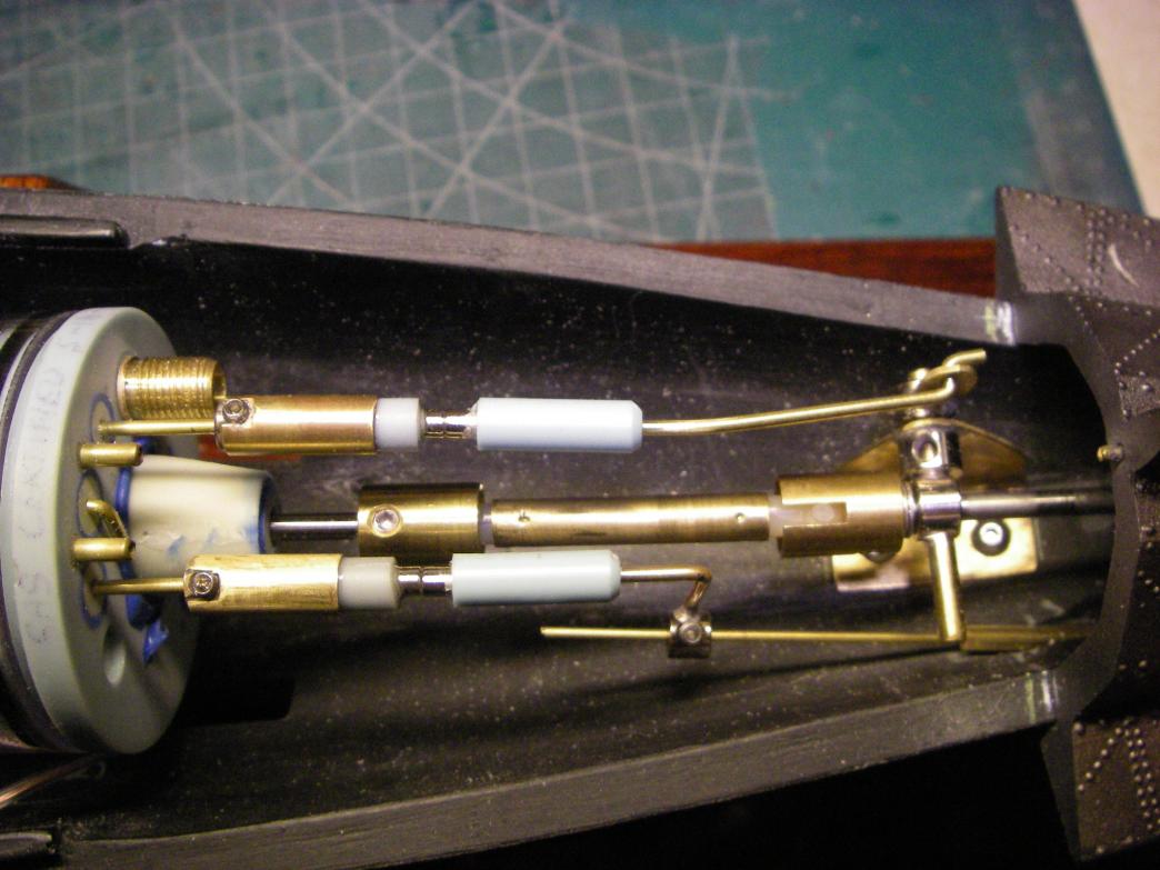

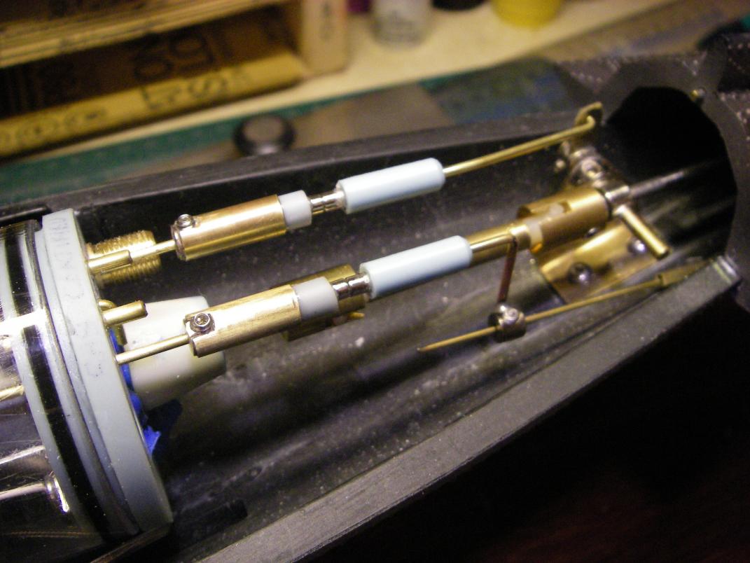

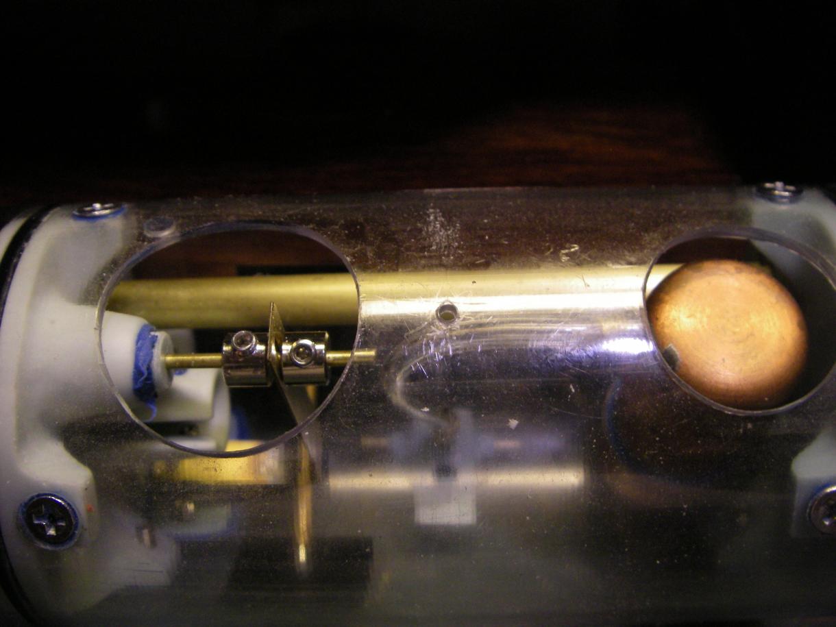

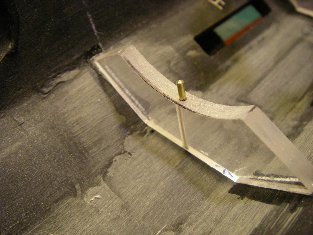

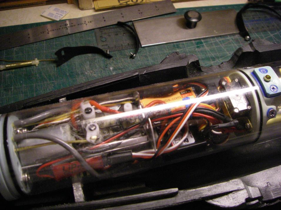

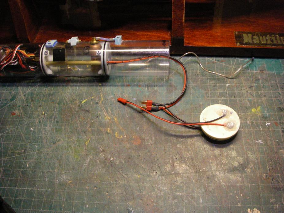

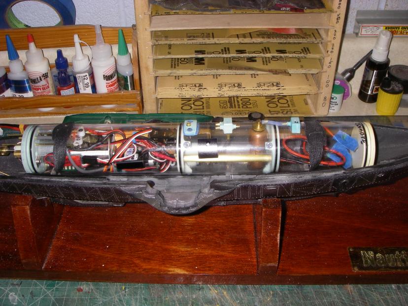

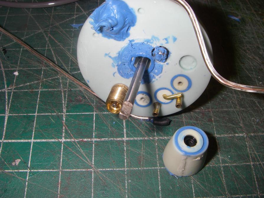

    Installed another saddle with a pin to secure the cylinder in the hull. A matching hole was drilled in the bottom of the cylinder's ballast tank. Modified the magnetic pushrod connectors with brass rod & tube, and wheel collars. Drilled two holes in the forward end cap for 4-40 bolts. The bolts and nuts secure the wires for the lights.

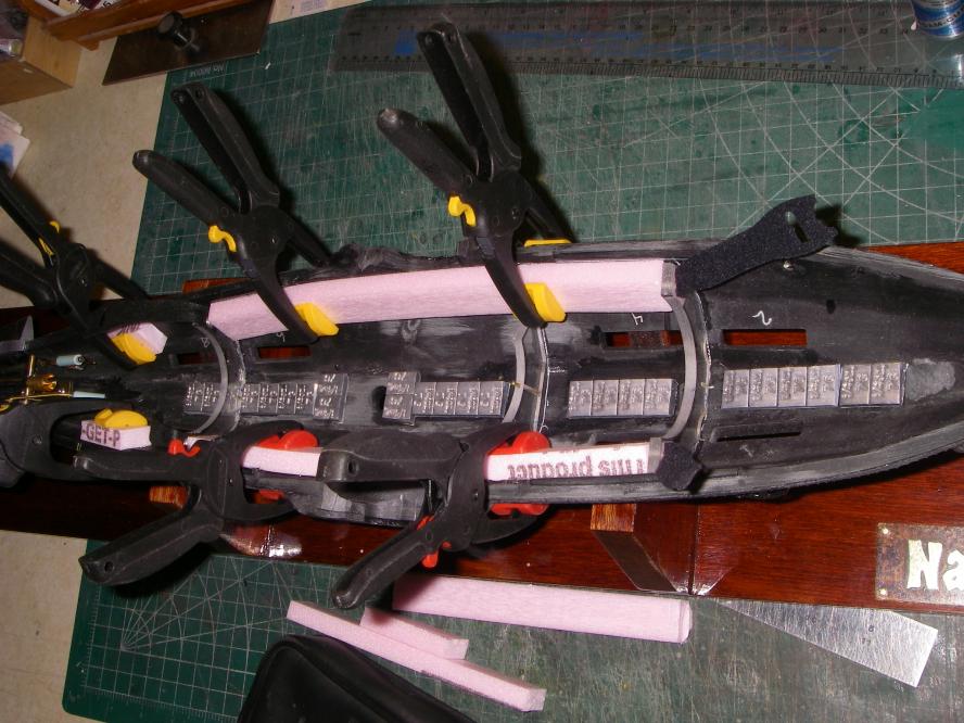

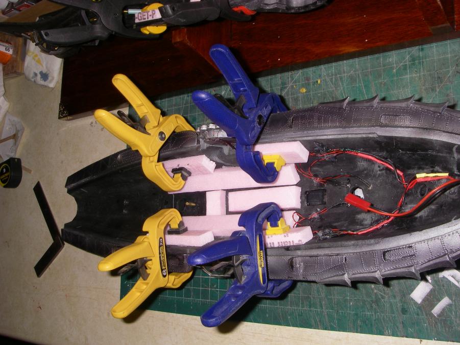

        Initial float testing in the home dry dock shows I need at least 6 ounces of ballast in the bottom and 17.25 cubic inches of foam. I'll refloat again when the foam glue dries.

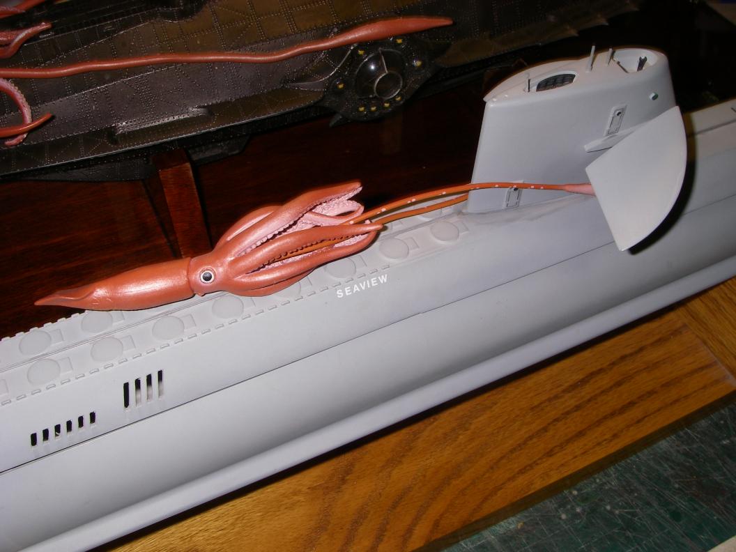

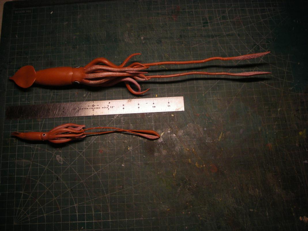

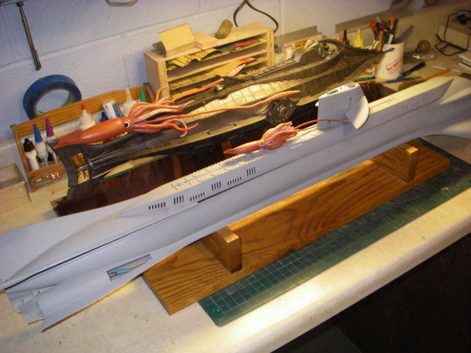

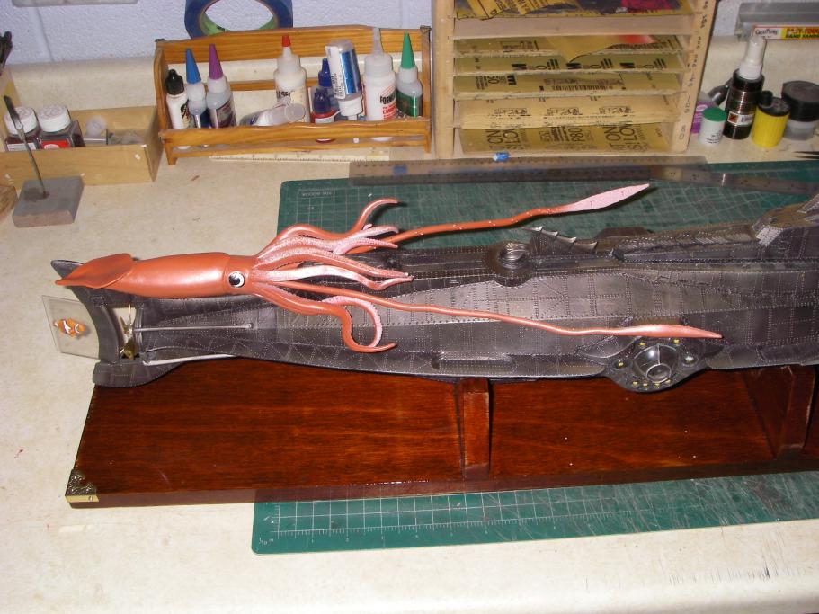

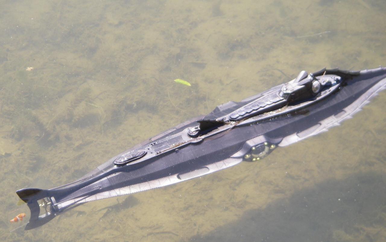

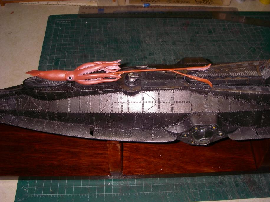

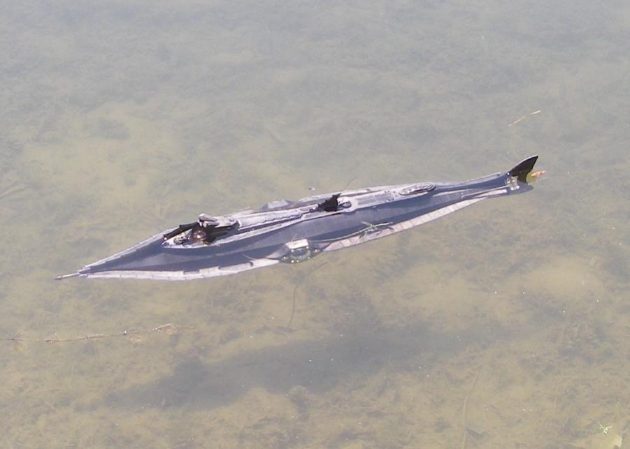

          After a couple of trials in the home dry dock facility, I'm calling the model finished and ready for sea. I plan to do sea trials later this month with the 8-Balls. The mailman delivered some plastic calamari today, for static display with the sub. The larger one is 18" long and the smaller one is 9.75" long. The smaller one is closer toscale size for a giant squid of 60'. The larger scales out to 114'. I like the larger one better. The small looks good on the SEAVIEW.

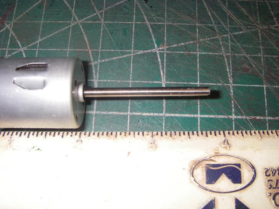

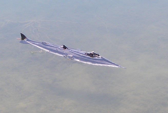

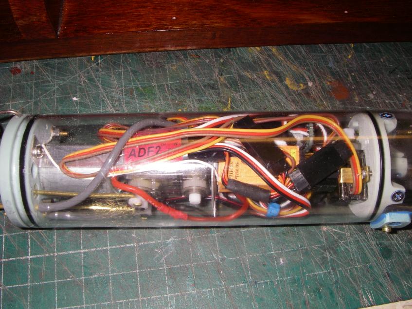

                    It was good to run with you guys this weekend. The NAUTILUS ran fine for about 5 minutes, then the motor died. When I opened up the cylinder there was no scent of magic smoke. After We got home, I opened up the cylinder and removed the motor. The ESC checked out okay with a different motor. I connected the original motor to a couple of different batteries, and had no rotation. Fortunately I have another 280 size motor - but the mounting screw spacing is a little different.

                        No gearbox. The cylinder was originally designed for the Trumpeter 1:144th scale ISS SEAWOLF. The same unit is recommended for the NAUTILUS and has been used in several builds.

                            There isn't enough space in the cylinder for a 500 size brushed motor. The available space for the motor is about 1" wide and 1.25" long.

                                Space is really tight in the cylinder. I have a Mtroniks Viper 10 ESC in there now, and the equipment deck barely slides in. A new motor has been installed.
