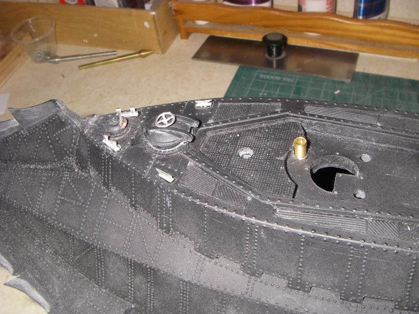

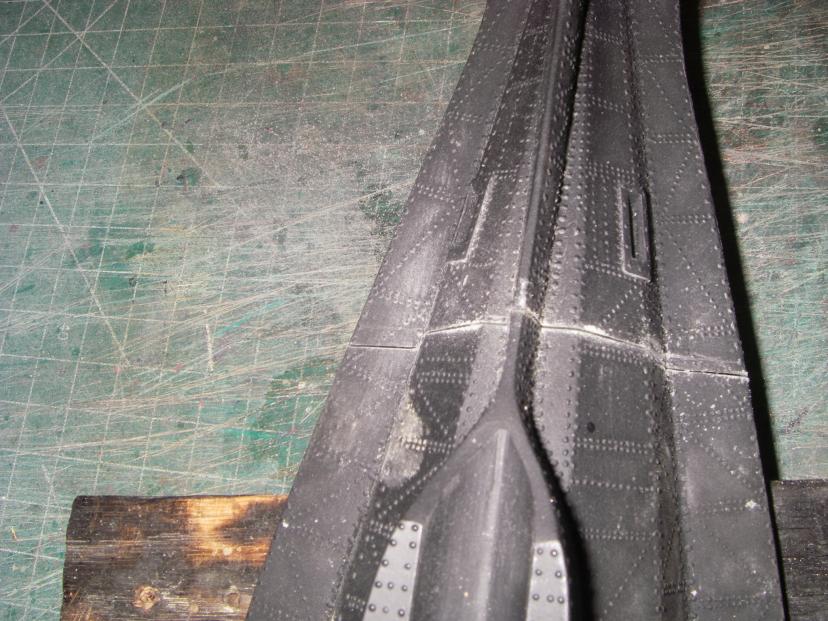

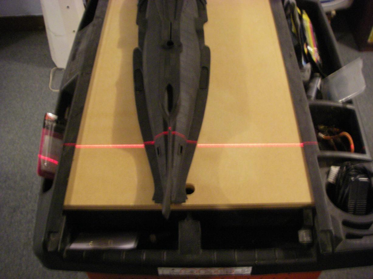

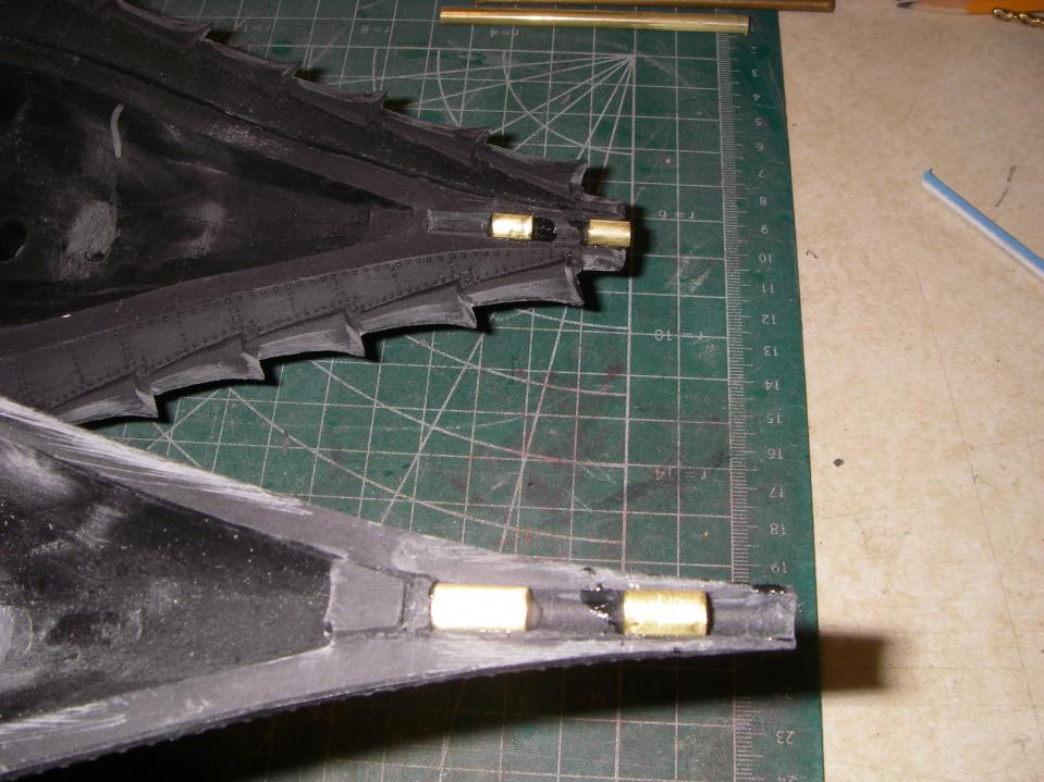

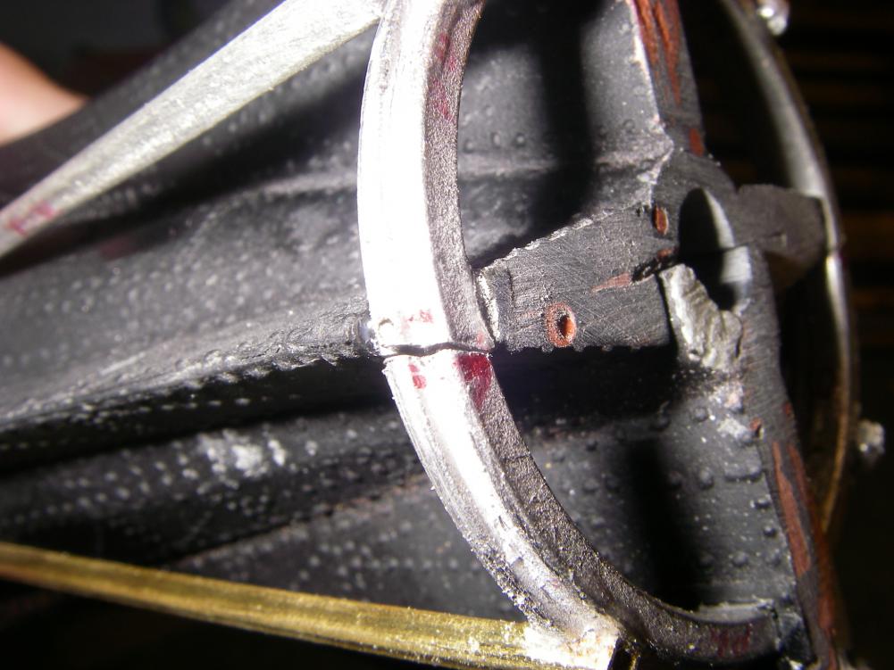

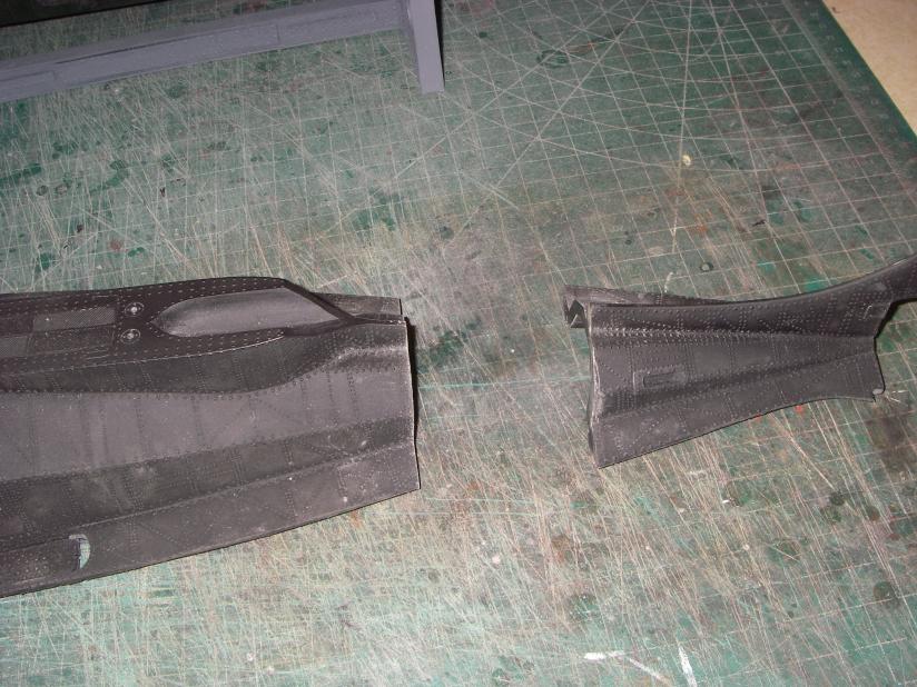

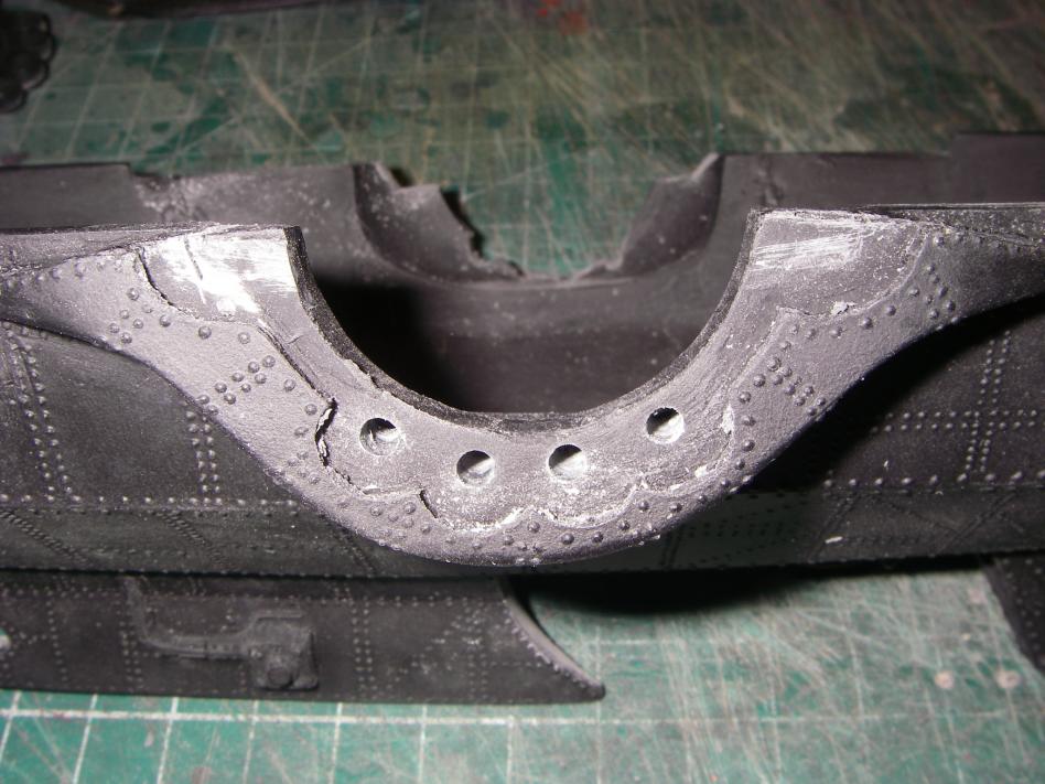

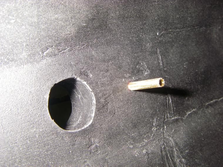

    My wonderful wife got me the 31" NAUTILUS as a Christmas gift in 2012. After seeing bob the builder's latest thread, I decided it was time to open the box and begin assembly. I started by gluing some brass tube in the nose. I drilled holes for LED lights. The lower depth tube bracket broke, so I replaced it with some brass tube. I used a laser level to mark the upper stern for cutting.
    Great idea on using the level.
    Should be a fun build. BD

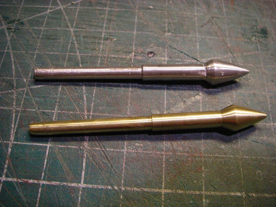

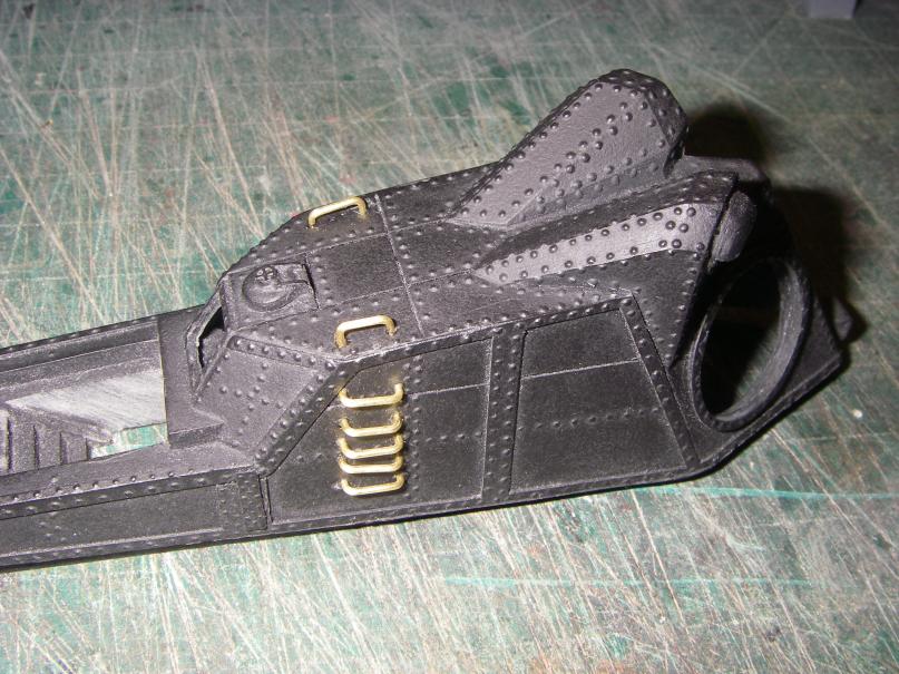

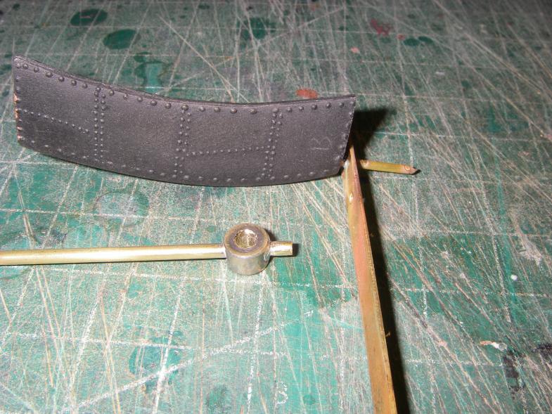

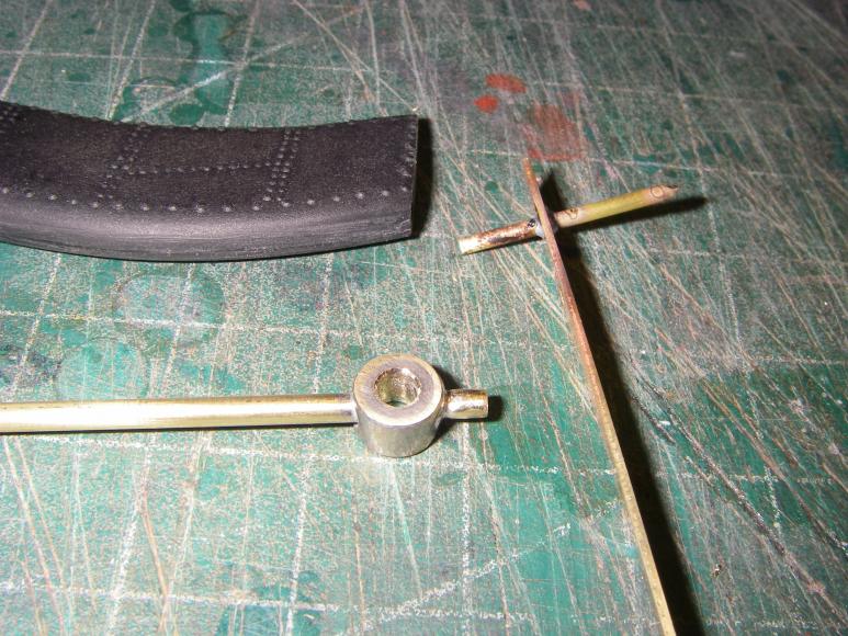

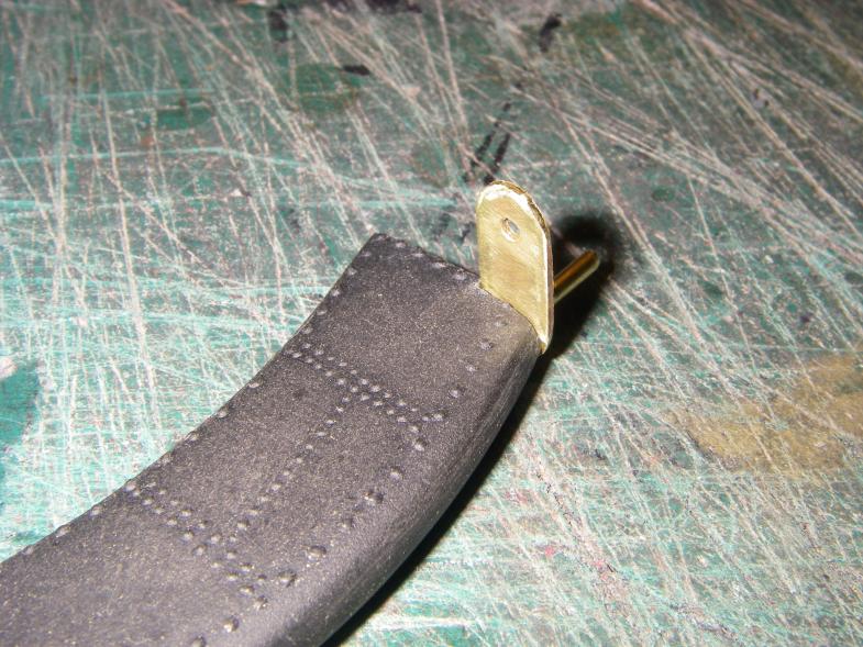

      A little more work is done. Ladder rungs on the pilothouse were installed. I turned a new ram from brass stock. Made up the pivot block for a gimbaled prop and the rudder arm.

                    Originally posted by sub culture View Post
                    You'll be popular with that metal prod on the front of your boat!
                    The stock ram is cast white metal, and certainly up to the task of looking good on a display model, or securing the hull halves on an operating one. I decided to make a spare while I had an intact original on the bench.

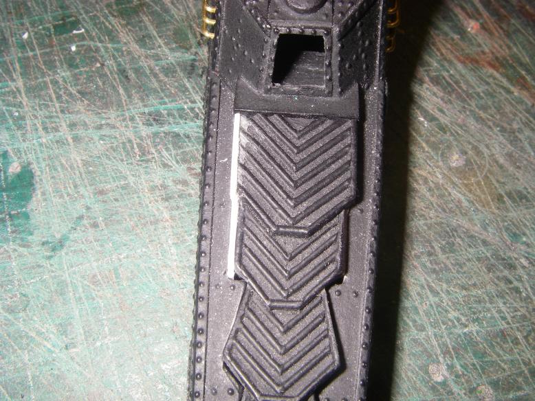

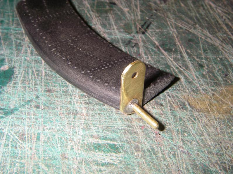

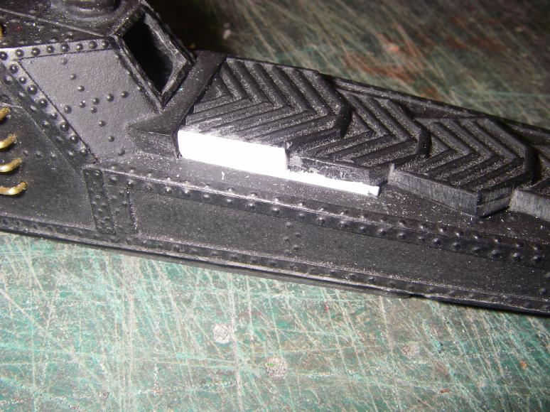

                      Added some sheet styrene shims to the deck aft of the pilothouse. Installed the prop ring and support struts. Replaced the lower left struct wit square brass tube after opening up the strut mount on the hull. The rudder push rod will run through the tube.

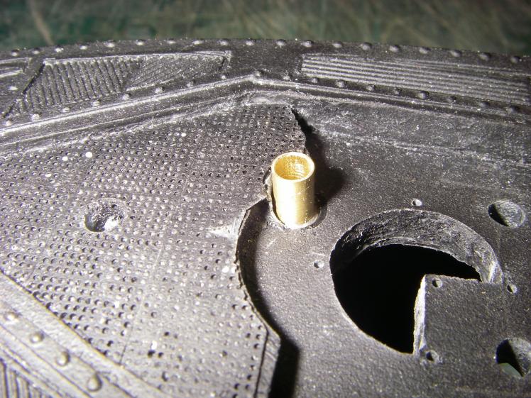

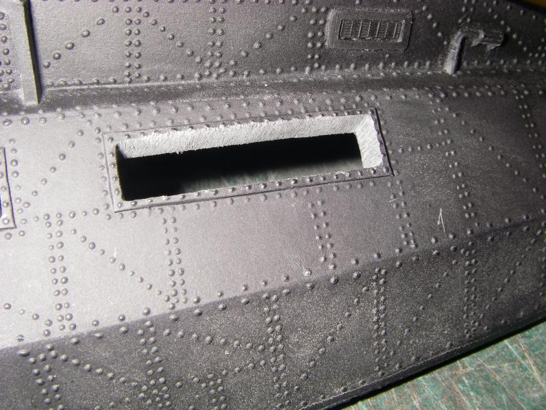

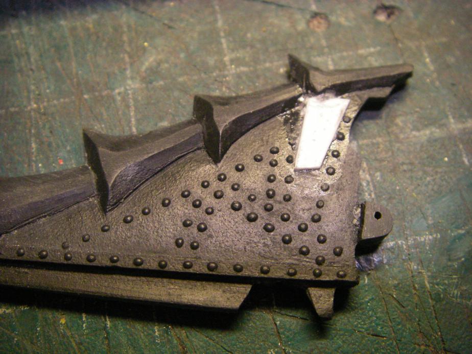

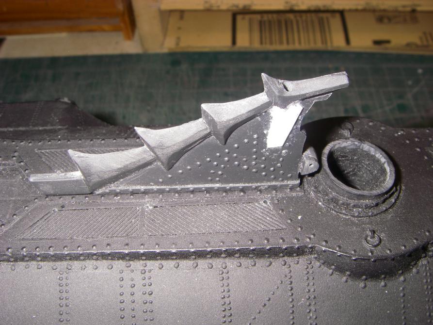

                        Work on the dorsal fin consisted of drilling a vent hole near the after end. I tried drilling from the top, and my drill bit wandered to the port side, opening a small split in the port side of the fin. I elected to glue a small piece of styrene over the split.. Then I continued drilling from the bottom and installed a brass tube. The V shaped notch in on the bottom of the dorsal fin provided clearance for the pin vise chuck. Added the cast bitts and cleats.

                          You could glue a similar shape styrene sheet on the starboard side and add some rivets- sort of representation of a reinforcement plate.
