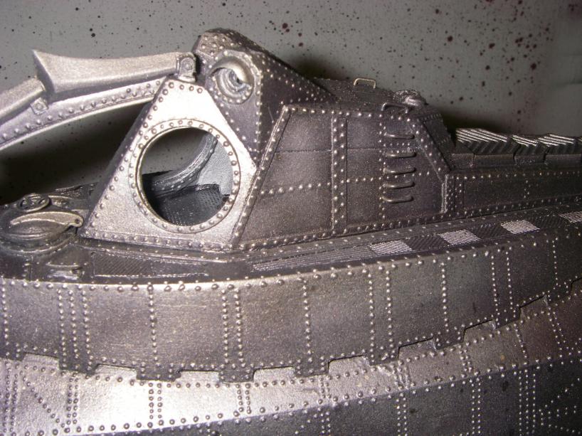

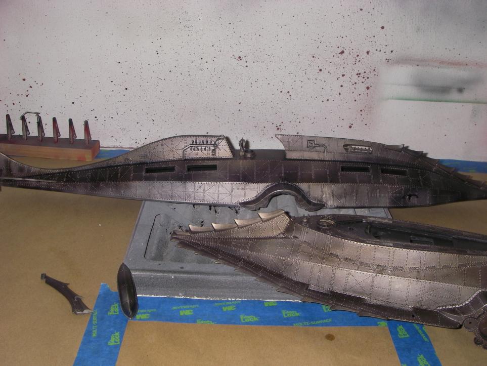

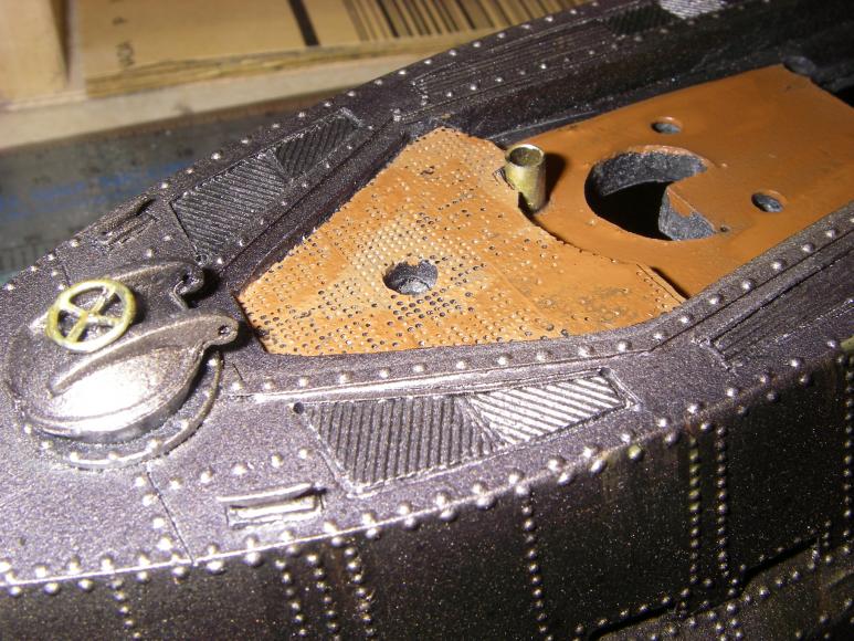

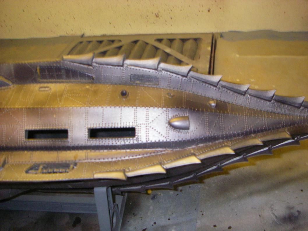

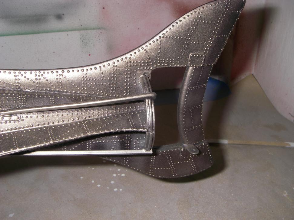

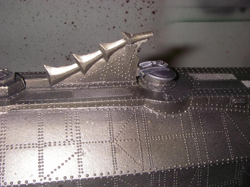

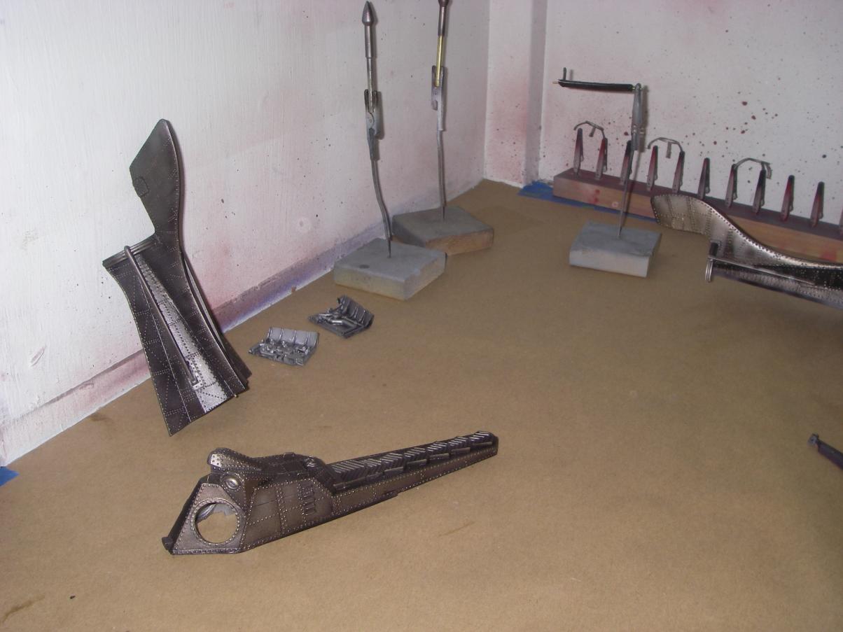

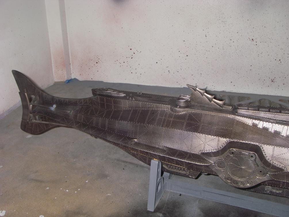

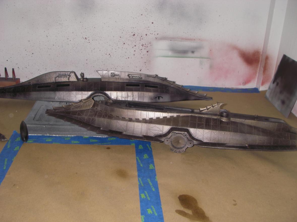

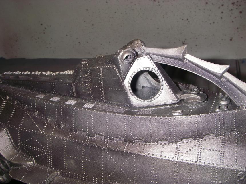

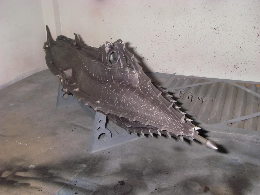

    Spent some time in the paint shop yesterday and today. Using Alclad II lacquers. First was the Black Primer Micro Filler (ALC-309), followed by a base coat Dull Aluminum (ALC-117) airbrushed over the whole model. Followed up with random spraying of Steel (ALC--112), Burnt Iron (ALC-121), Exhaust Manifold (ALC-123), and Pale Burnt Metal (ALC-104). I'll follow up with a few coats of the Aqua Gloss Clear (ALC-600) in a few days.

      I built the same prop set up for my 66 inch Nautilus and it works great for pitch. Love the paint job!
      www.steveneillsgarage.com
        Yes, very nice finish Bob.

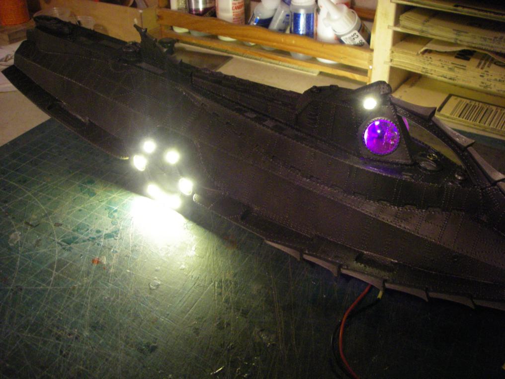

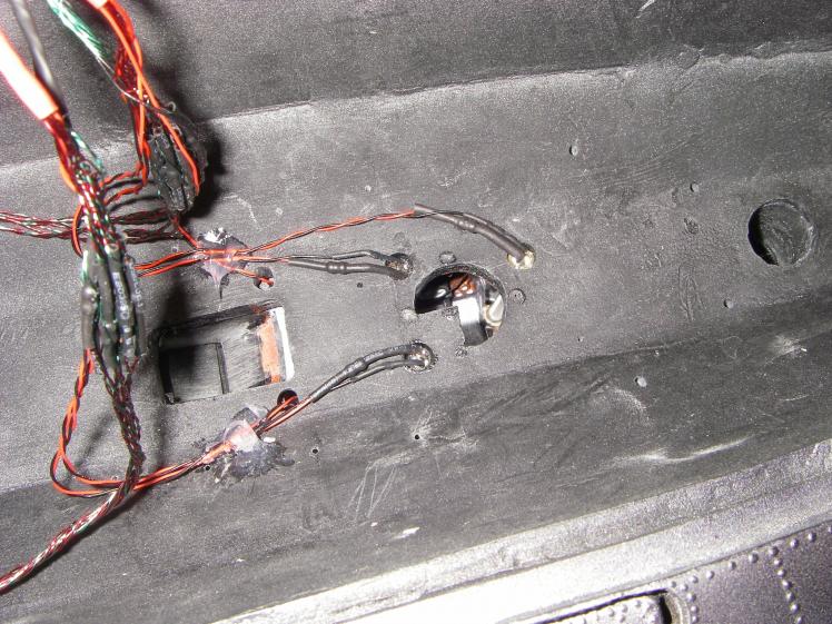

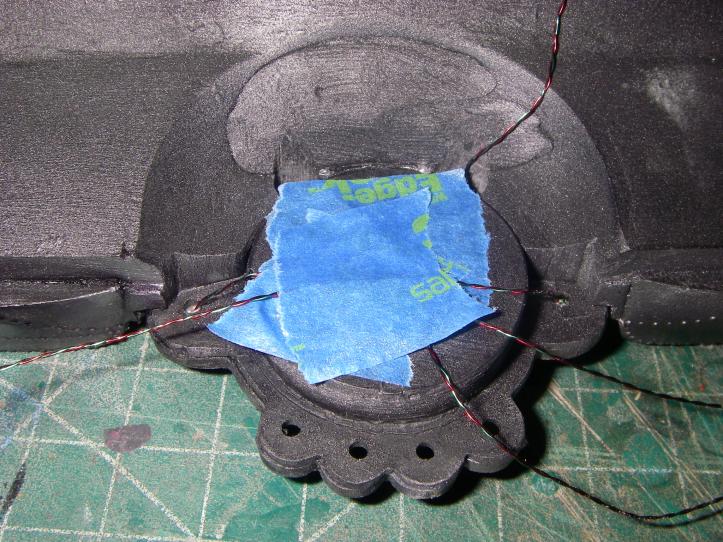

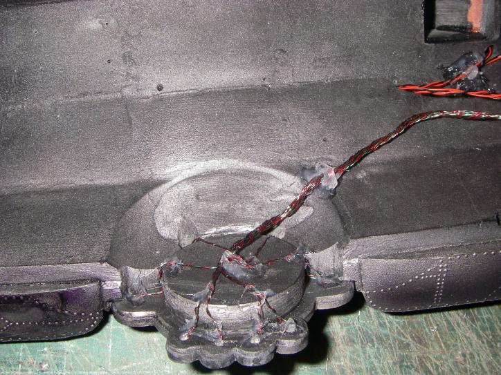

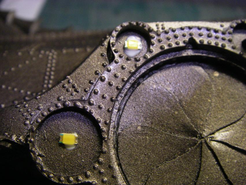

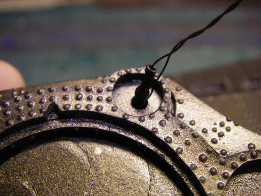

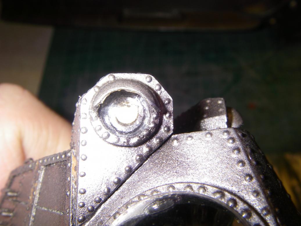

                  Lighting going in. 3 mm warm white LED's in the Croc eyes; 3 mm blue LED for the depth tube; and 3 mm red LED's for the pilothouse. Warm white chip LED's around the salon windows. I'm using some canopy glue to secure the chip LED's.
                  • chips
                    • 497

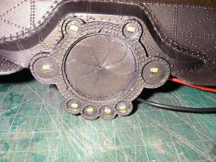

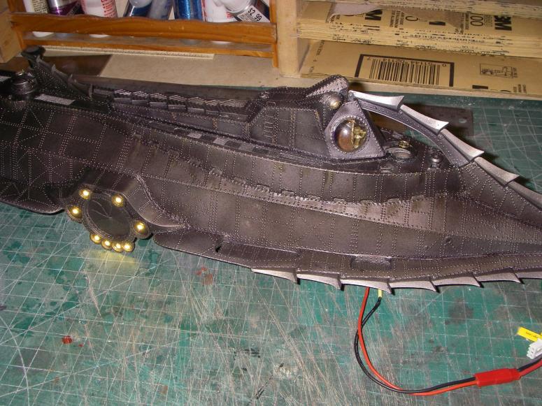

                    More lights installed and tested.

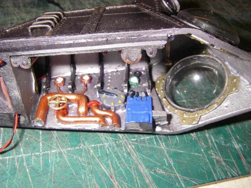

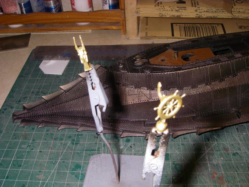

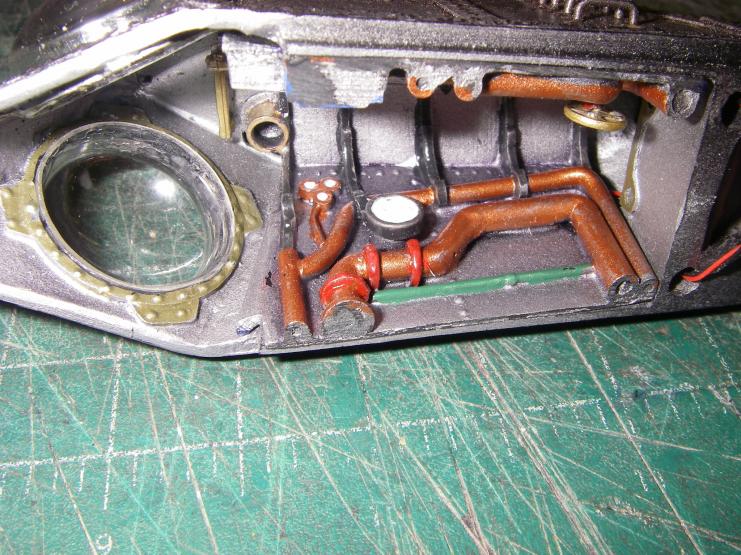

                      Painted the details inside the pilothouse.

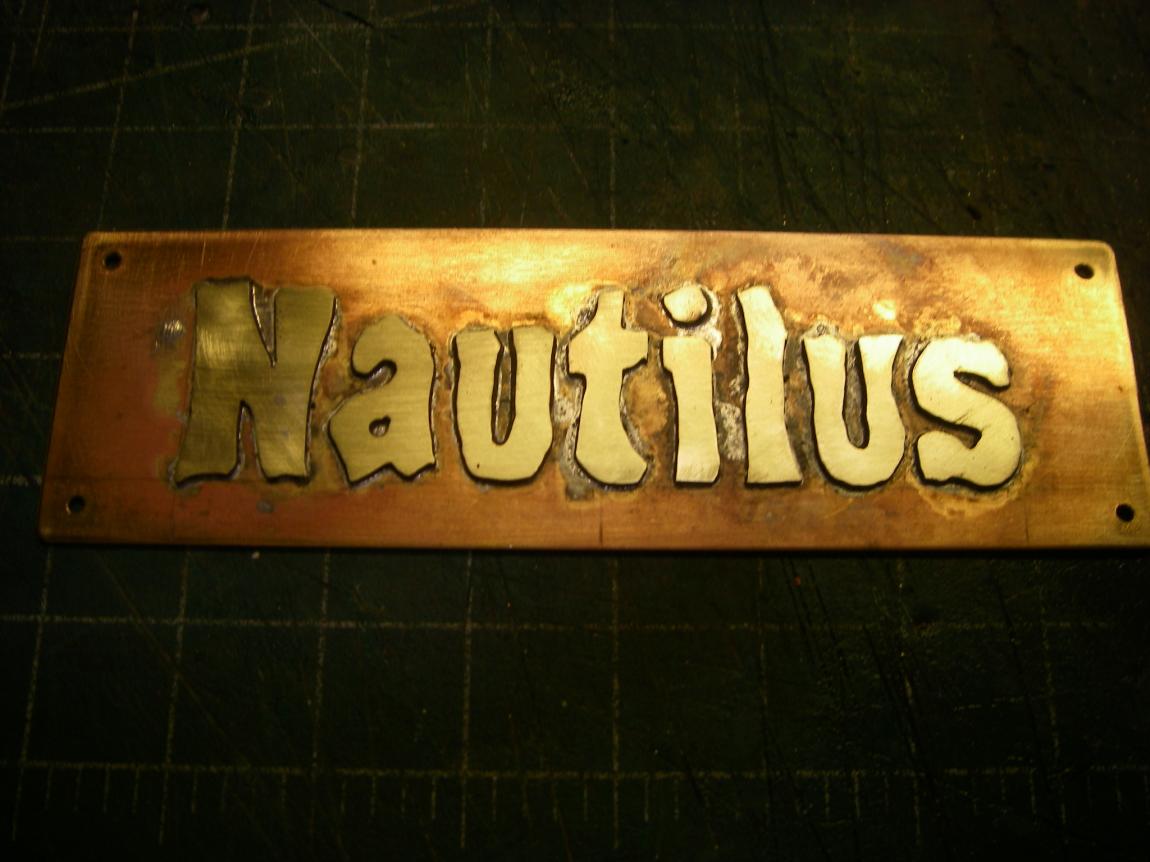

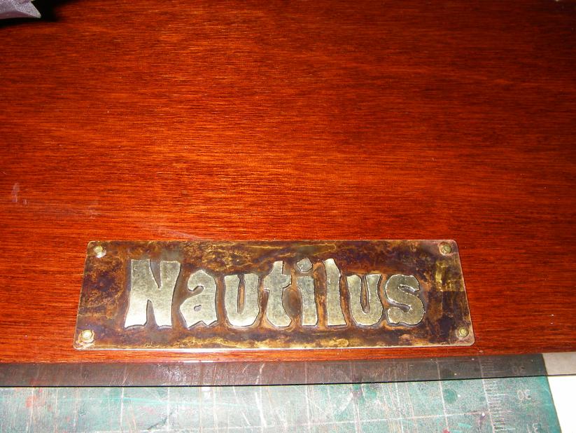

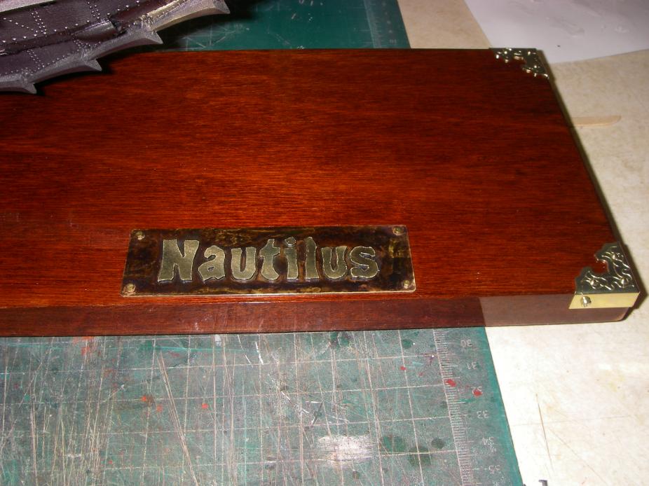

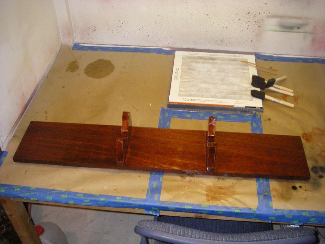

                          I made a display stand from a piece of mahogany veneered plywood. The name plate was made from brass stock. The letters were cut out with a jeweler's saw and soldered to the brass plate. The plate was aged with some heat from a butane torch and a soak in some ammonia soaked paper towels. The lettering was then polished and the plate was clear coated.
                            That looks great Bob.
                            Interesting process. That is a lot of cutting with a jewelers saw.
                            I have two of them and can never seem to keep the blades from loosening.
                            What thickness did you use for the letters? BD

                              Your name plate came out really nice. It is an extra touch to your base that makes it stand out. I am inspired to try this some day.

                                #30
                                I used .032 brass sheet. It took about 2 hours and 3 blades to cut the letters. In the past I've used ferric chloride (PC board etching solution) to etch the name plate. My first attempt for the NAUTILUS used ferric chloride, but the bottle I had was about 5 years old, and didn't give me the depth I wanted. Cut and solder brass was my second option.
