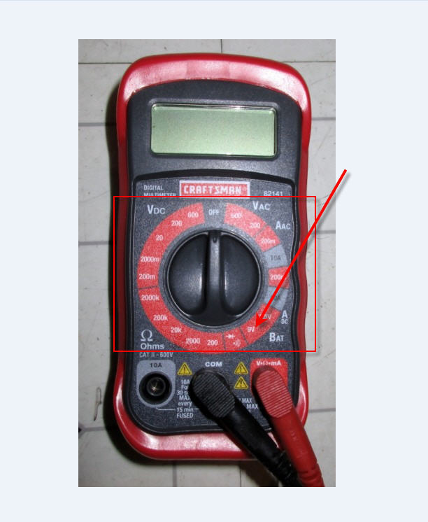

                I got me also last night this tester for 10 bucks at Sears. I'm using the battery 9V setting (pic) to test batteries - Is this correct or should I use a different setting for more accuracy?
                Also, what the proper range would be for a fully charge Lipo 11.1V - 5500mah (3S)?
                My Gel Cell 12V - 5 amp/hr rated fully charged at 13.14 on the battery 9V setting in the multimeter, is this correct? Thanks.
                    [ATTACH=CONFIG]387[/ATTACH]
                    If I understand correctly, you will want to set the meter setting to be a higher voltage than what you will be testing. What's the next setting higher than that 9-volt setting?

                      If you look closely at the pic where the arrow points out at - it only gives you two settings: 9V and 1.5V BATTERY (BAT) setting. I suspect I could also use other settings on it.
                      Not sure.

                        I just checked this multimeter specs.
                        It has only two settings for VDC.
                        1.5V and 9V.
                        The meter is made to test individual cells of 1.5v and 9v batteries.
                        I looked at other meters on the sears site.
                        These meters go up to 600VDC.
                        Model # 82146 $17.99
                        Model # 82007 $19.96
                        When I posted the meter links above, I should have looked at the specs on the meters.
                        I would have realized that the $9.99 one would not work for you 12v gel cell.
                        That meter would be fine for 9v of less batteries.
                        Can you return the meter and upgrade to the next meter up?
                        Sorry, I gave incorrect information for your needs.

                            I tried looking at the photo on my iPad...but it didn't allow me to enlarge the photo. Now that I'm my PC, I see what it says. I would have used the Vdc side of the dial. I think I see a 20-volt setting?
                              -Jef
                              Agree - Use 20VDC setting for 12V gel cell and 3S LiPo alike. Volts are volts, I'm not sure what's "special" about the battery test setting on this meter.

                                Looking a the specs on the SEARS site, I think the 20 is in the DC amp section.
                                The specs only show two setting for testing batteries on this meter.
                                1.5v and 9v. DC
