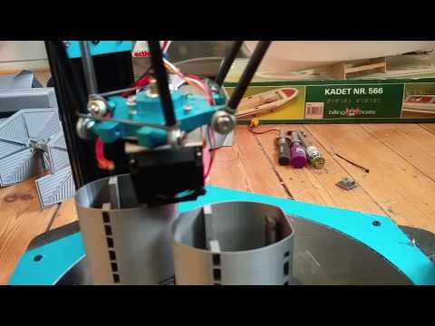

      Just fast printing ad 0.32 layer height, 60mm/s print, 200mm/s move 205/55 degrees .

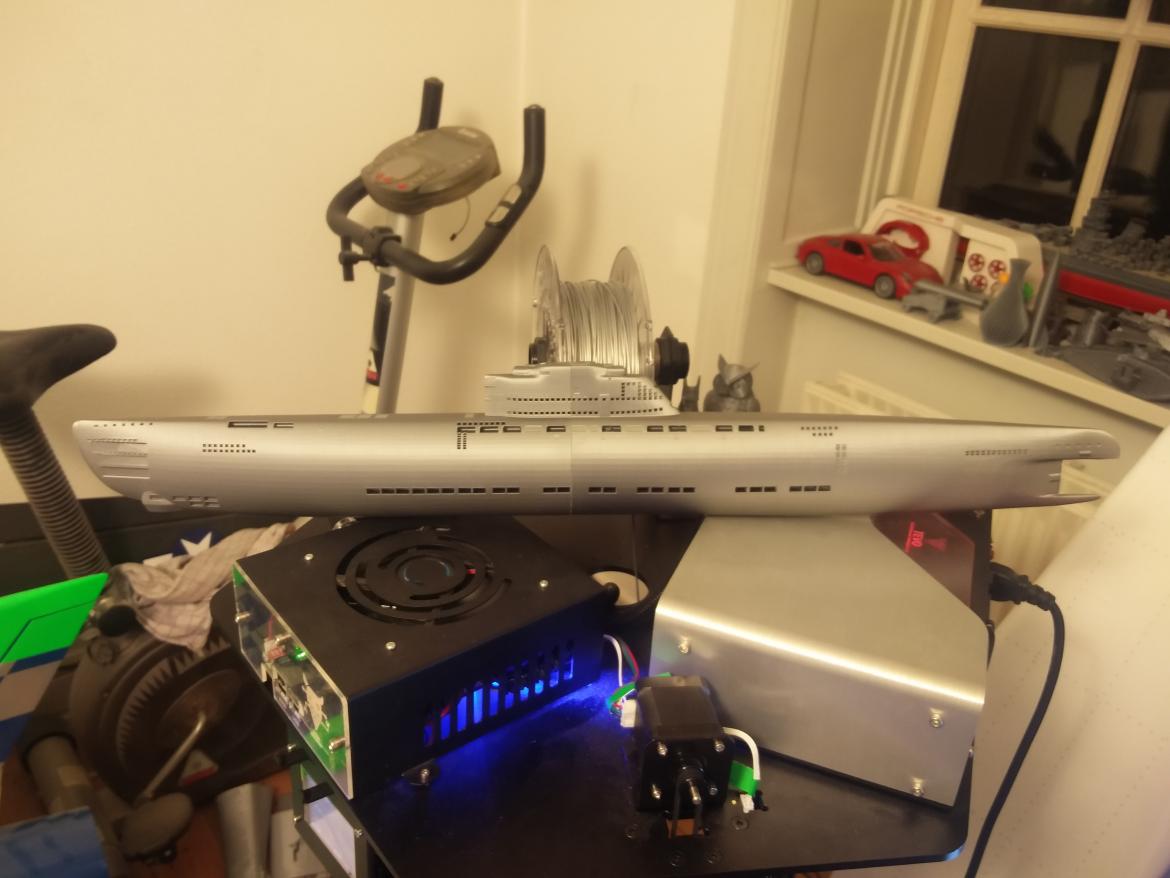

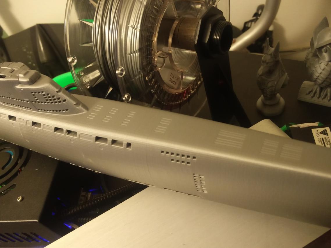

        a small test of the XXI german sub :-)
        I really want a large version of this one......a shame that the Robbe kit is gone :-( Cant find one for sale anyware.

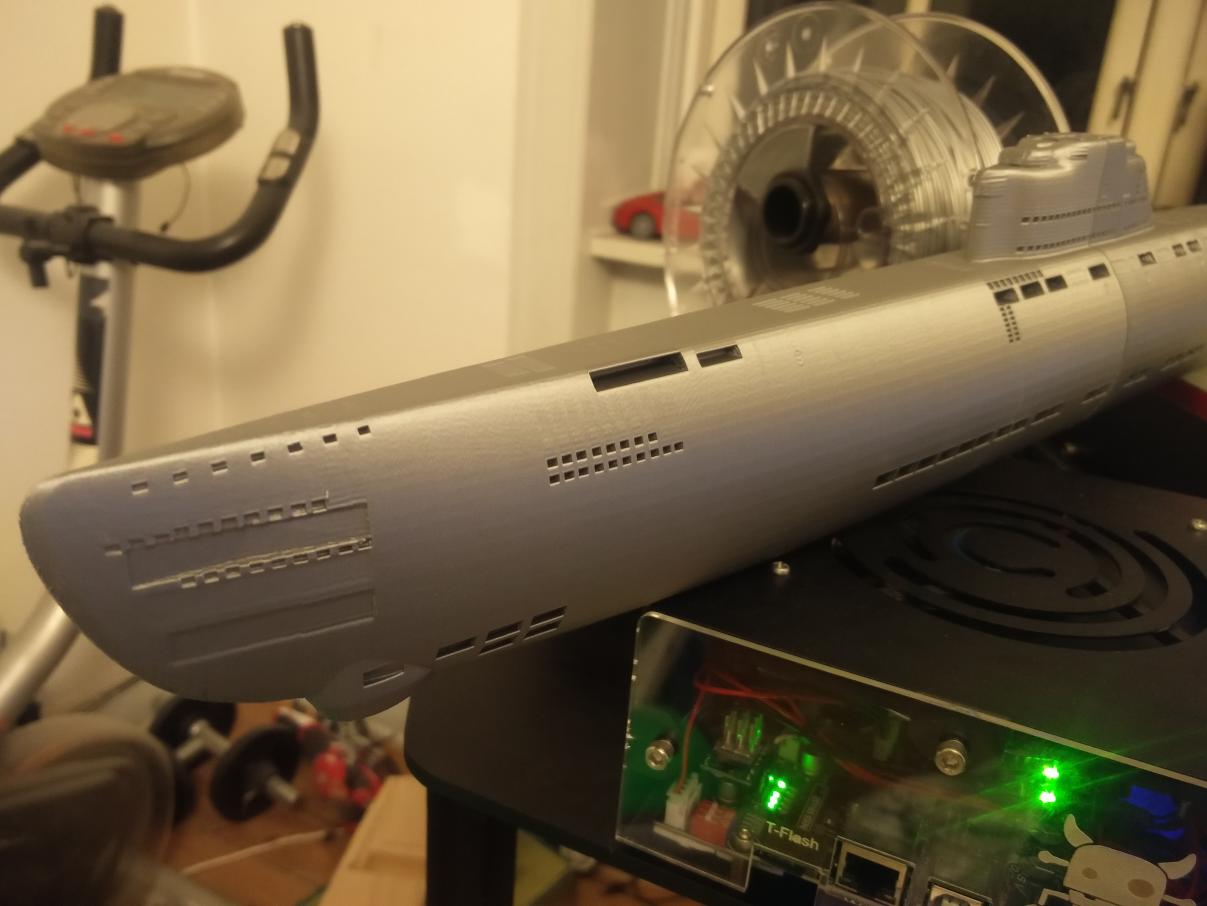

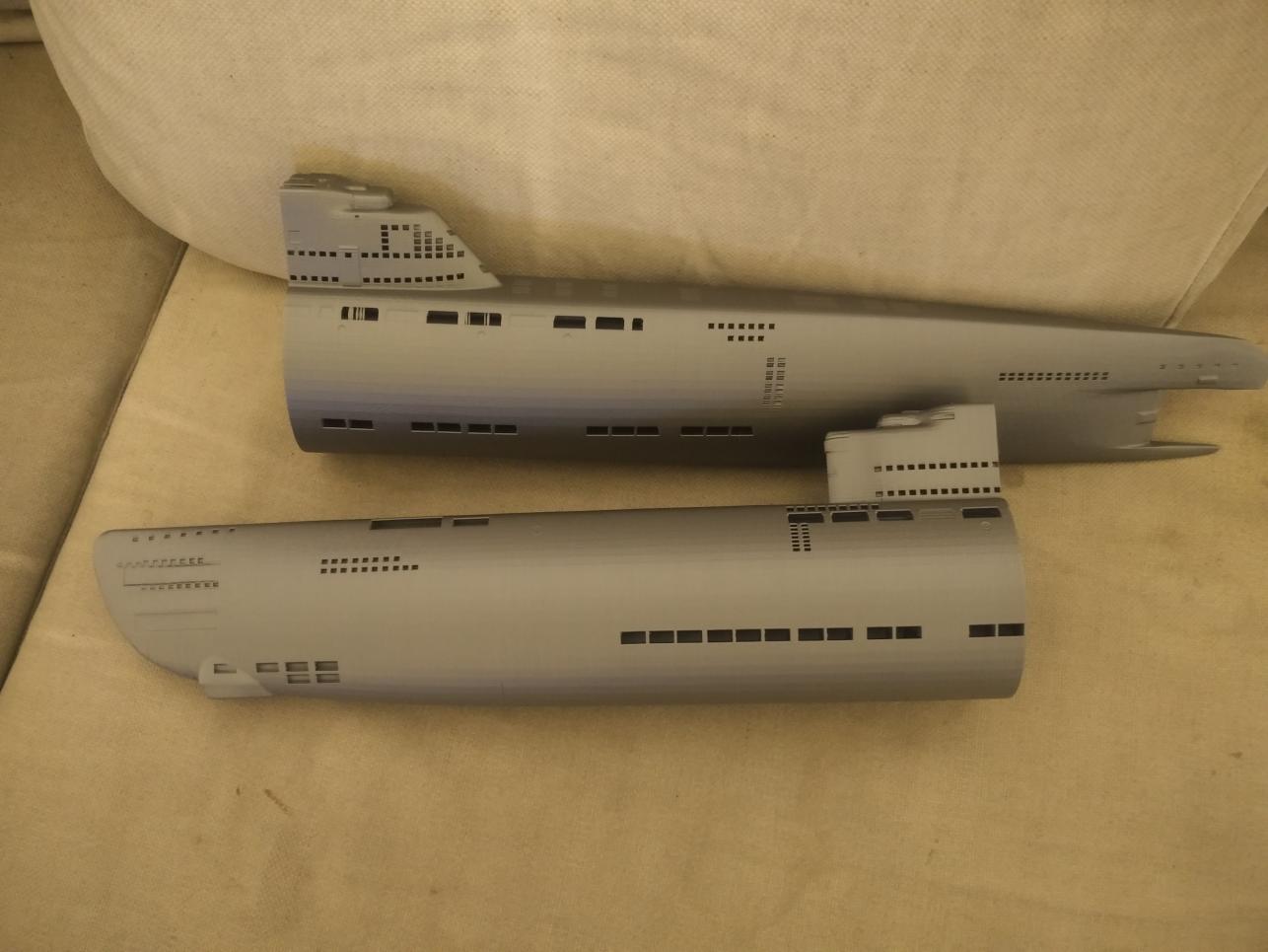

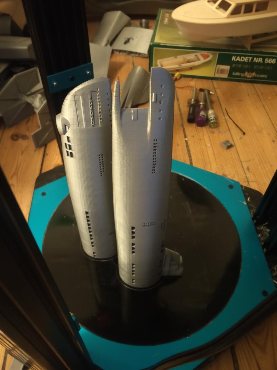

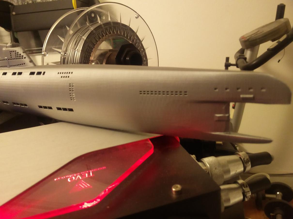

                  Turned out ok. I printed it only in one perimeter to print it quick, which makes it a bit fradgile. But it could be scaled up, and finished realy nicely i think
                  just need to print the small bits , rudder, guns, dive planes, props...:-)
                  The 3d STL file is not perfect. This sub was made out of a 3d drawing....not menat to be printed.....so it messes up a little during the conversion......cant get around that.....at least with my limited knowlege of how to make 3d models :-)
