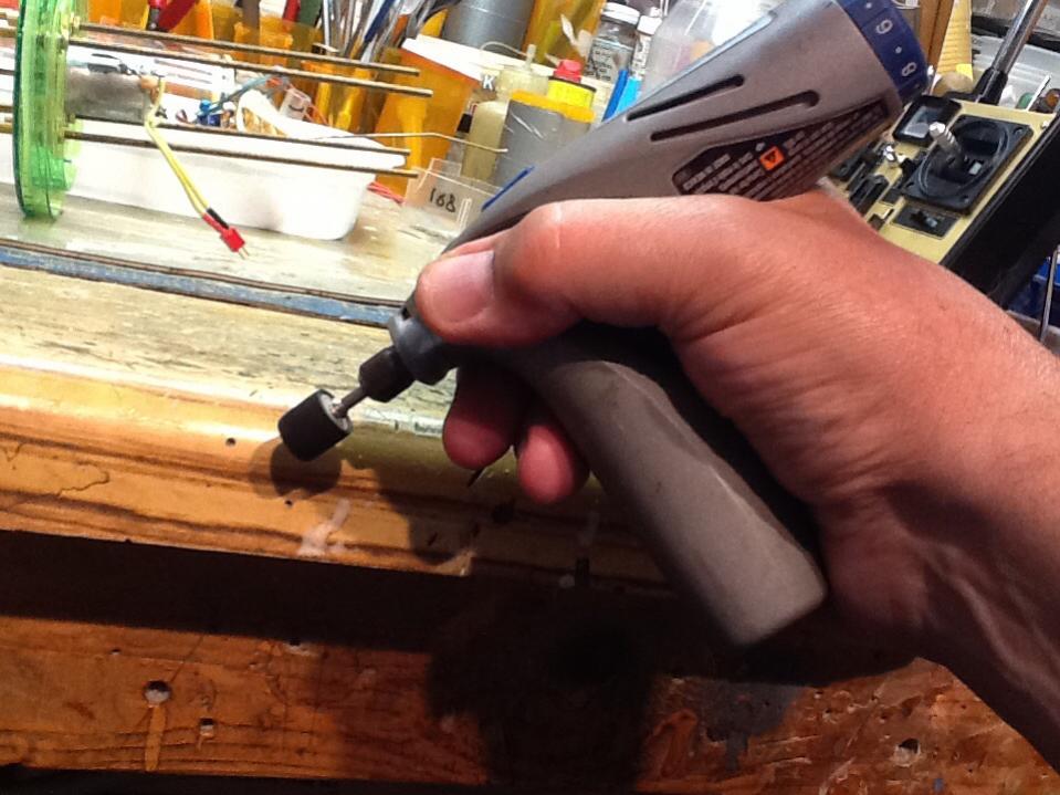

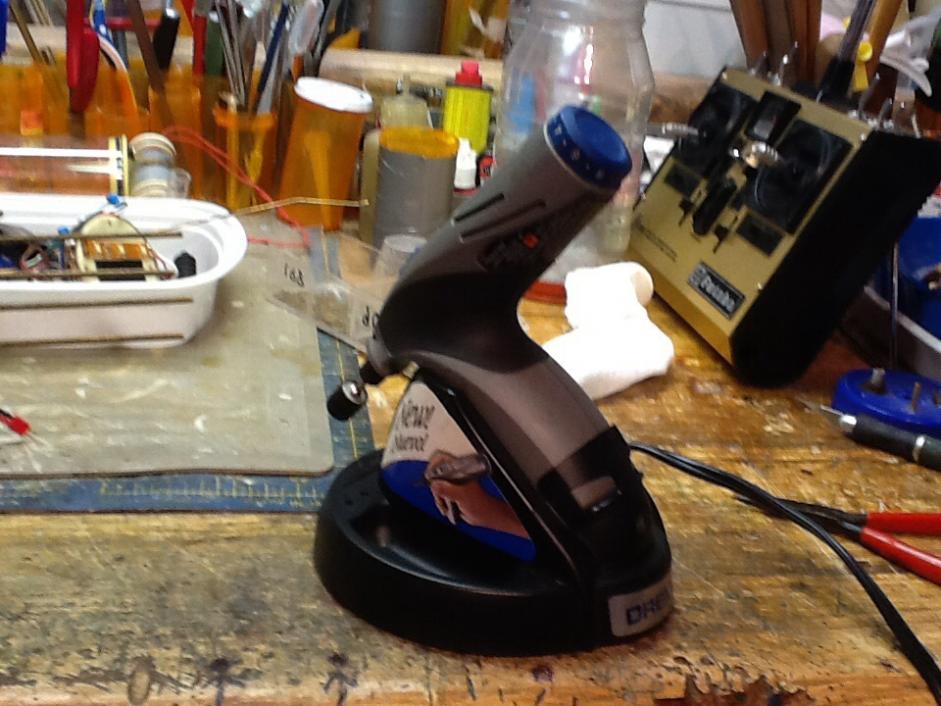

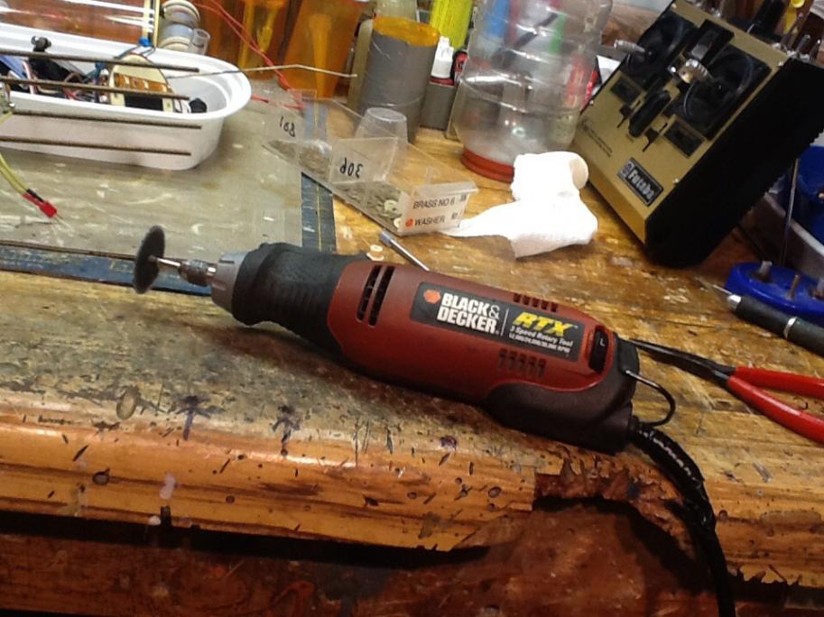

                Here are my Stylus, and my RTX. BD[Click image for larger version
ID:	128119Click image for larger version
