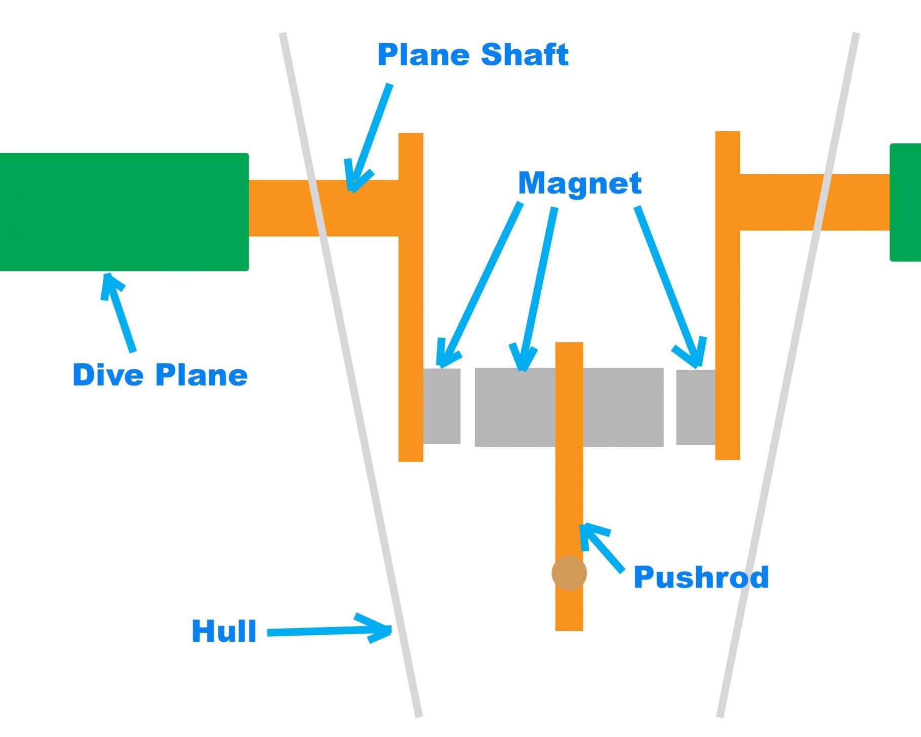

    Then I went to Fusion360 and drew out my idea.
Name:	Magnetic Plane Connector 00.jpg

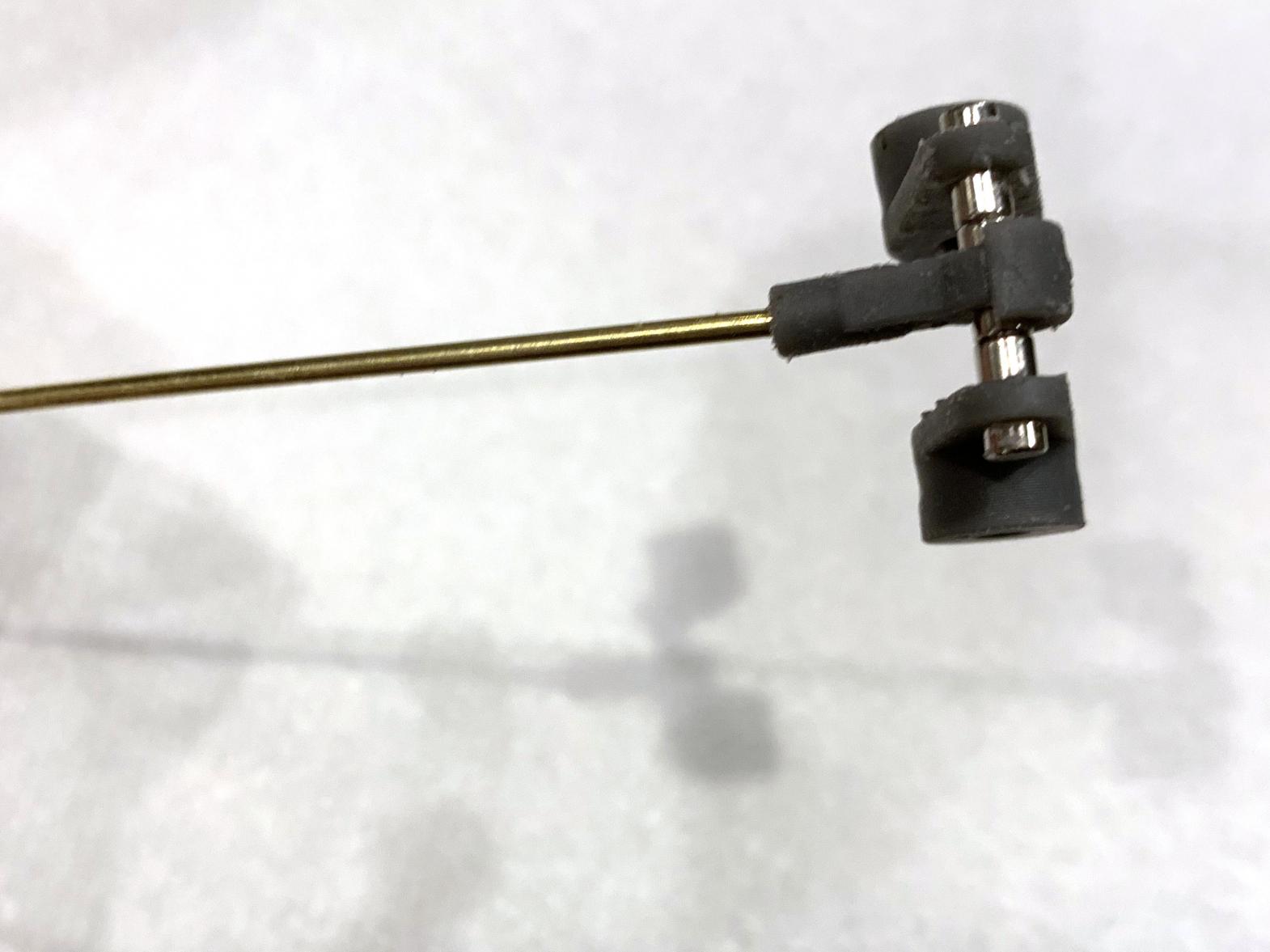

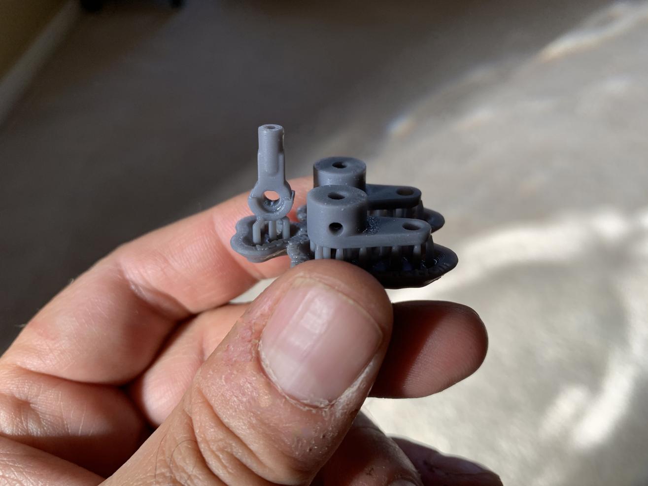

    Then printed it to test.
Name:	Magnetic Plane Connector 05.jpg

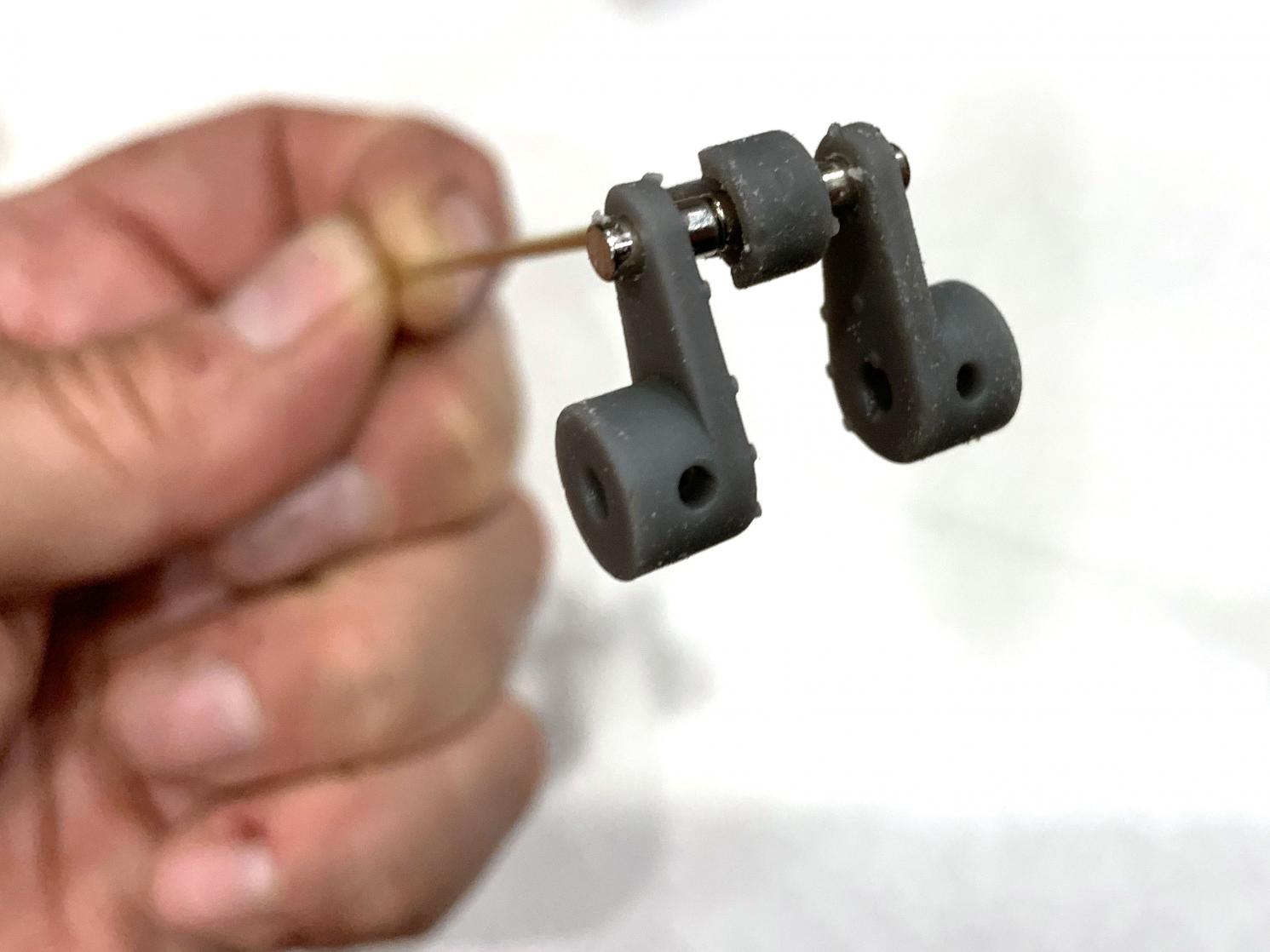

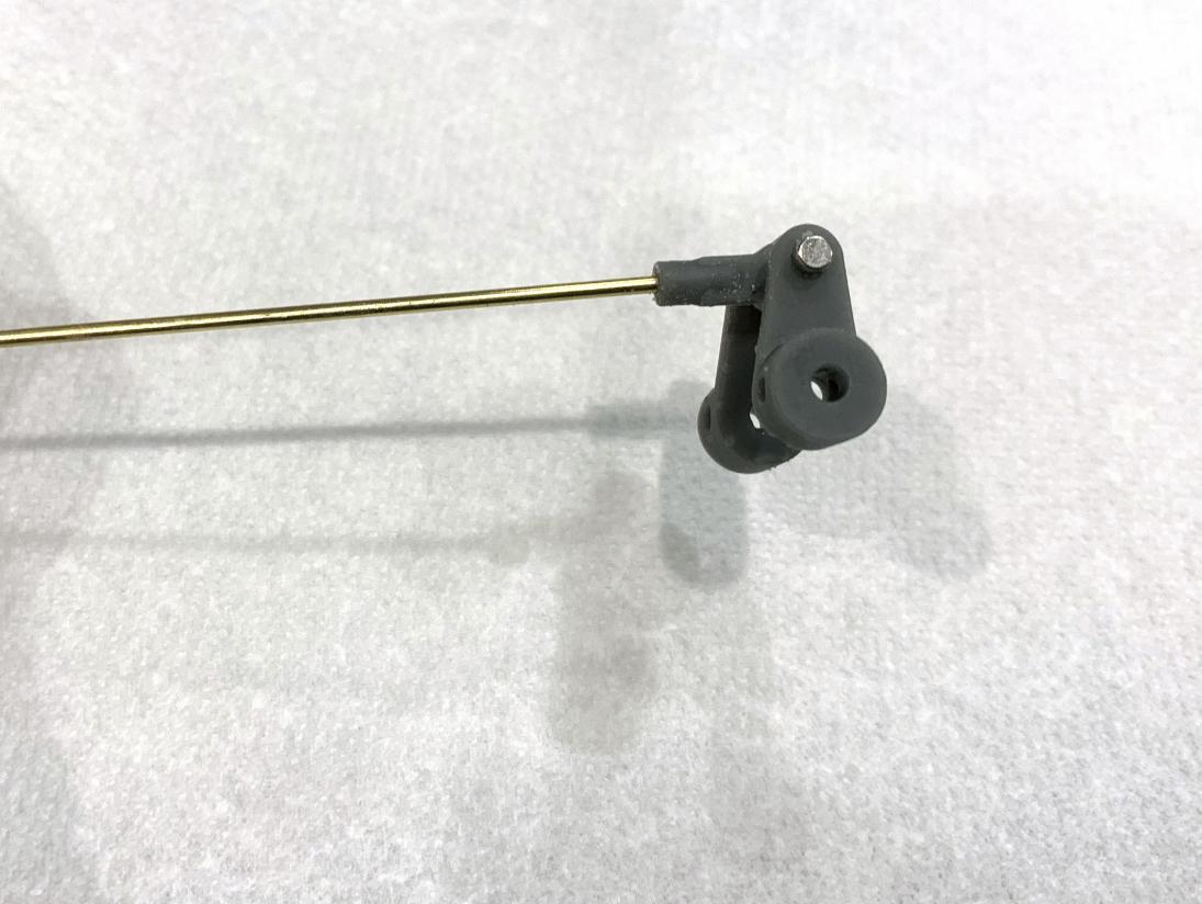

    And assembled
Name:	Magnetic Plane Connector 01.jpg
Name:	Magnetic Plane Connector 02.jpg
ID:	138043Click image for larger version
Name:	Magnetic Plane Connector 03.jpg
    I like this enough to try it on a boat. The hold is better than I thought, however as I was drawing this out I put in a semi circle lip on the push rod connector, that I think would minimize slippage. In this prototype it is too small to be effective, but I can expand it if needed.

      What resin are you using? The DLP resin I use is really fragile and wouldn't take the load. You must be using some pretty tough stuff!?
        Thanks Jim! Testing it and the hold is strong, so it may work really well.
        Matt, it is Formlabs grey. Pretty strong stuff. It is durable, I have some gears that I have been playing with that are holding up fine. I have soaked it in water and STP oil and no reactions that I can see. It can be brittle is impacted. Drilling is doable, but may chip near the edges of the holes.
