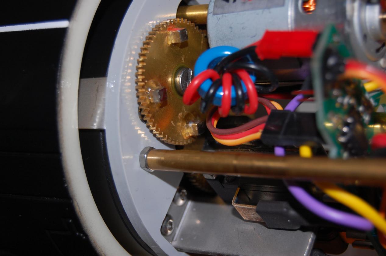

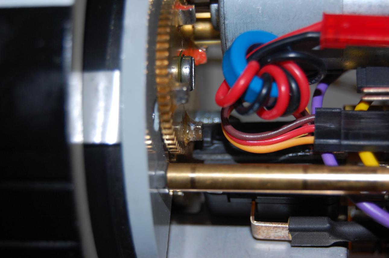

            #35
            Okay....so assuming that you were able to successfully complete the initial set-up, the yellow LED in the 'on' state usually means that it is detecting one of the magnets. Is there a magnet next to the Hall effect sensor? What happens if you manually turn the gear so that magnet is not near the sensor?
            Oh, how many magnets did you glue to the gear and did you verify that you have the correct alternating north-south-etc configuration? (it's easy to get wrong, we've done it at least once!)
            Do you see any change in operation (or lack thereof) if you change the channel used on your receiver?
            Can you provide a photo of the area of the piston showing the gear w/magnets and the sensor?

              Yes, one of the magnets is near the Hall sensor.
              Yes, I used a magnetic pole detector to alternate N and S (North is marked with orange paint).
              Attached photos
              Yes, I tried a new receiver on a different channel.
              Update: After I left it turned off for about an hour and then plugged the battery back in, the piston cycles normally...very baffling?
