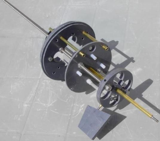

    I could use some options on the best method of doing the x tail linkages for the Walrus sub. I have tried a couple ideas, but I need something more proven. Please include photos. If you can't upload them here, please send them to dhampton@ameritech.net. Thanks

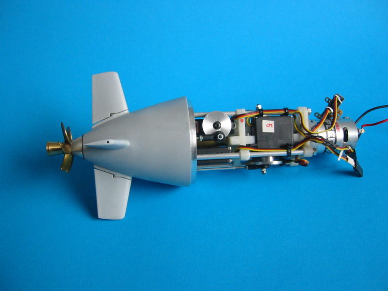

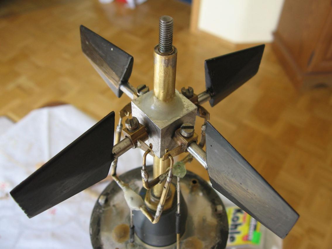

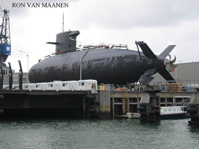

      Dave,
      ....not sure what aspect of an X-tail you are looking for. See if this helps...it's an image of the interior of an Engel Type 212a. It's not really different from a standard cruciform tail, just rotated 45 degrees.

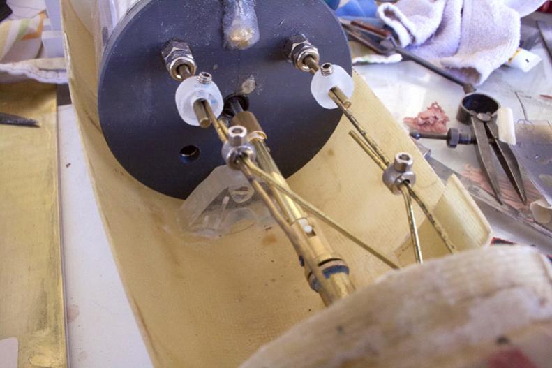

        What Jeff showed you is one way and a great way. What I did on mine was mimic a builder who I call the Architect. It is tough to say "best way" is. If it works for you, that is the best way.

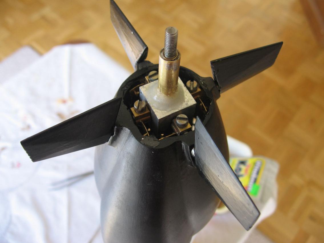

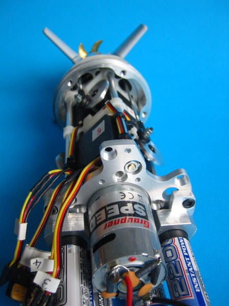

        Here is Will Oudmayer's Walrus setup.

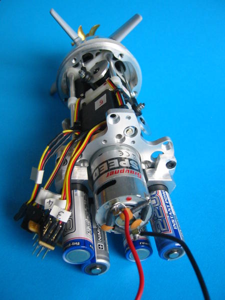

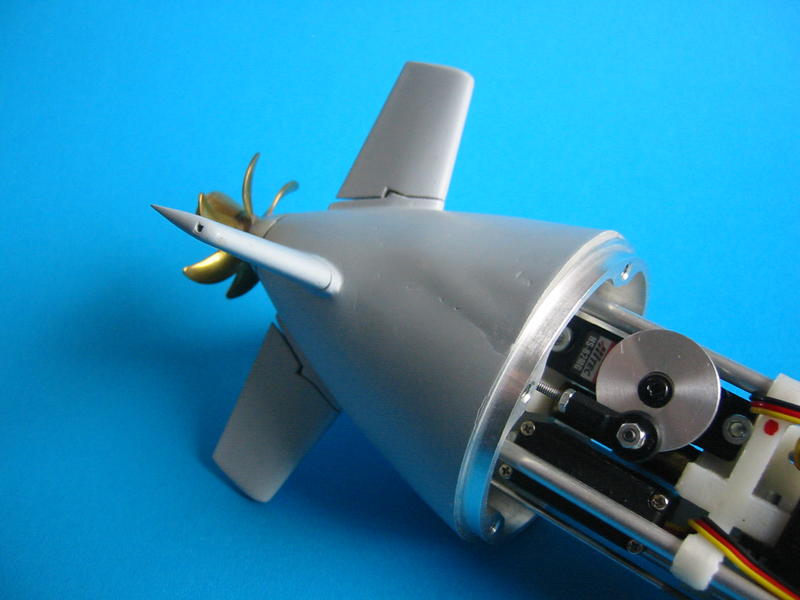

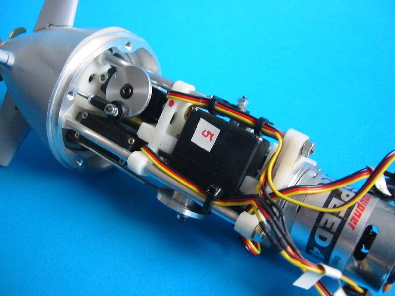

        Here is mine,

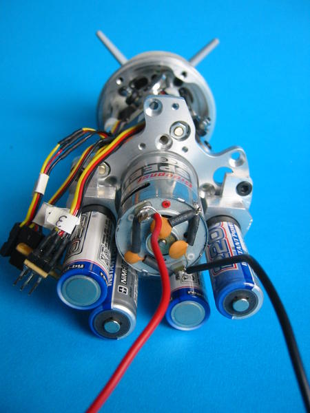

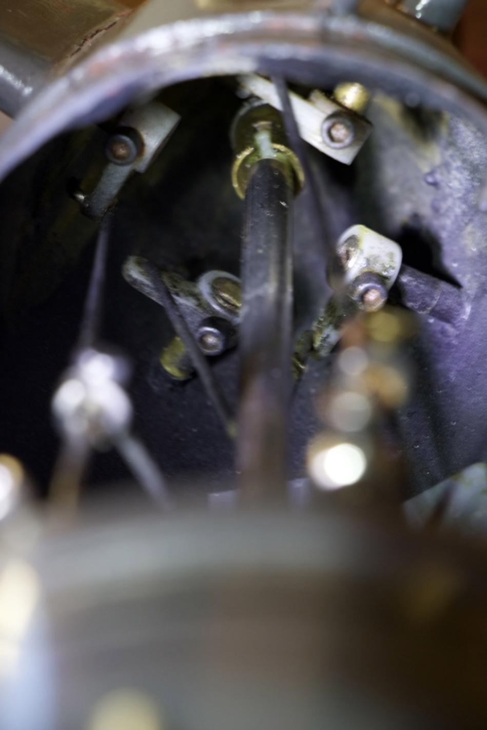

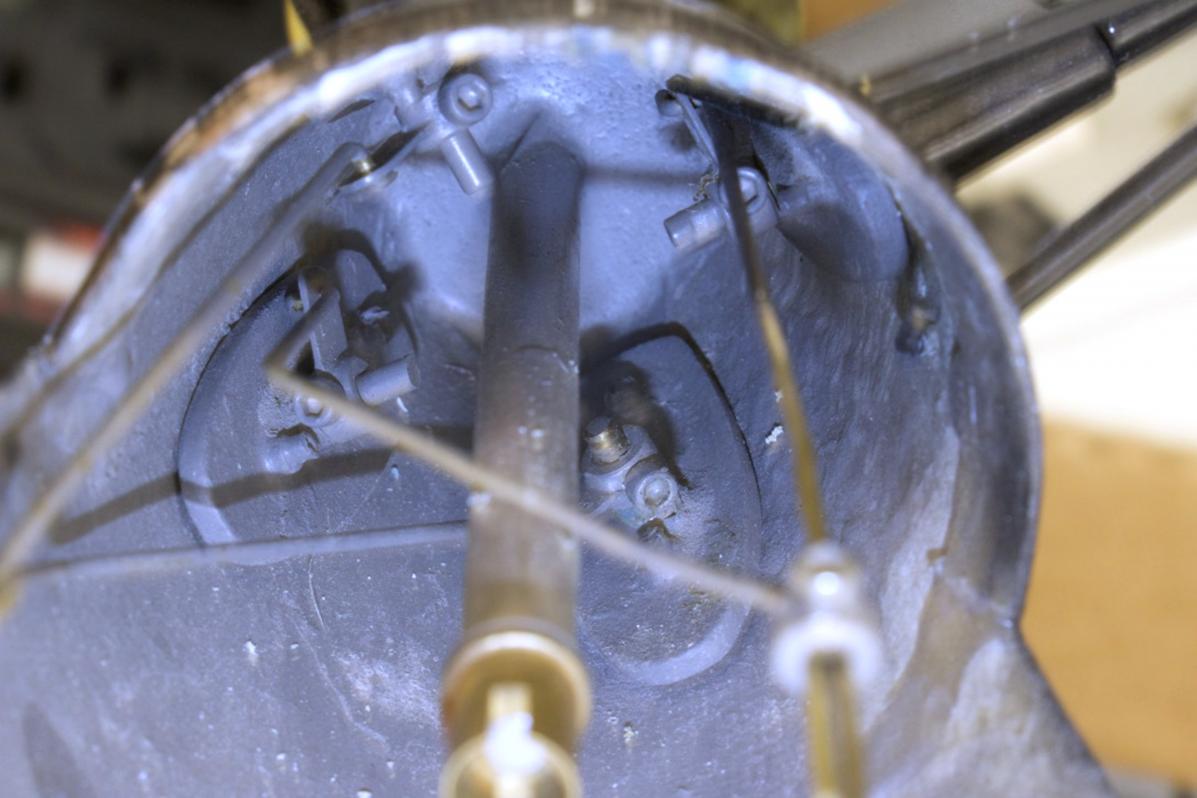

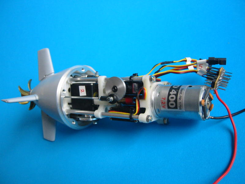

        These go to the push rods from the WTC
        Look carefully, the horns of the opposite side go in the same direction.
        I hope this helps.

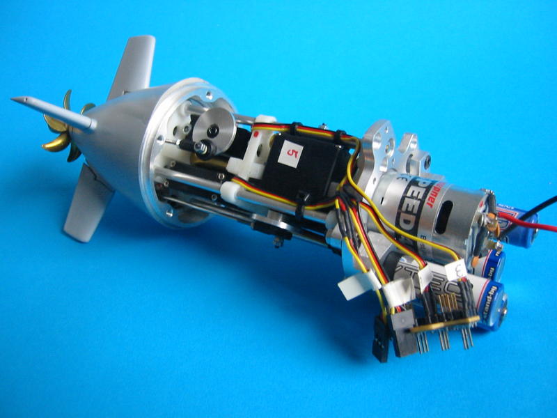

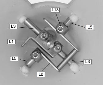

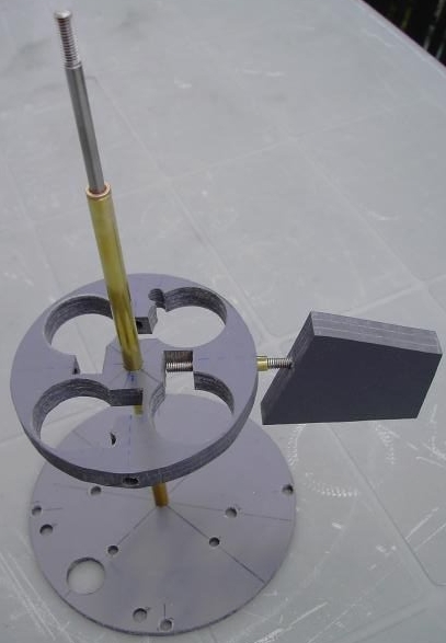

          This also may help to show how the tail feathers move as it's not always obvious to someone who is building an X-tail for the first time.
          btw: links = left, rechts = right, hoch = high (up), runner = down
            My 2 X-tails, a Albacore and a Sea Dragon are hooked up like standard subs and then I use a mixer, think both came from Mikes Sub Works. There are other mixers around, Bob Martin may still have one left from his sale items. Think a throttle mixer will work as well.
