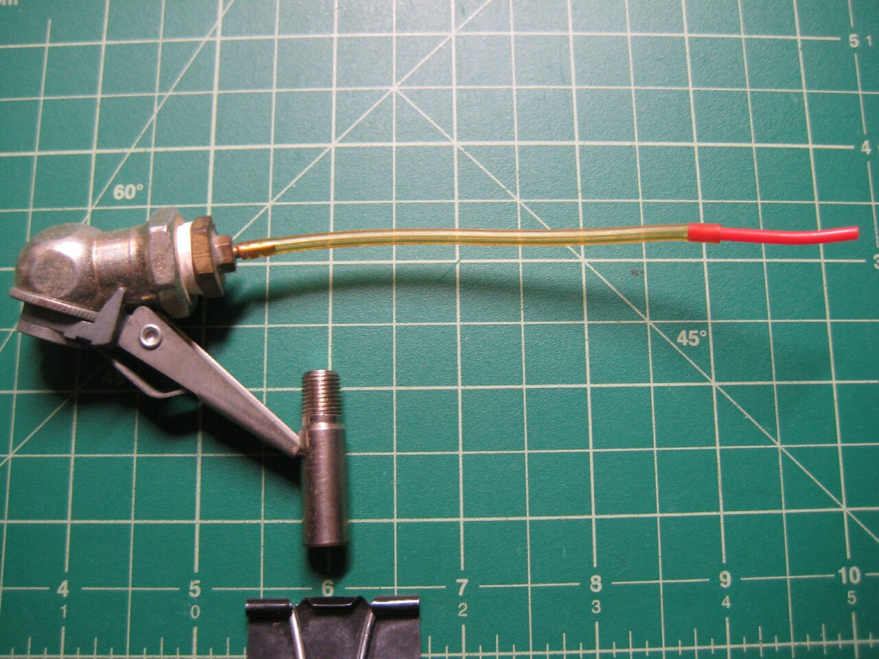

          Here is my (RedNeckGineering) solution for the cheap warehouse club non-threaded trigger style canned air:
          A clamp-on tire chuck, brass fittings down to 1/16 tubing down to the standard nozzle tubing, with a valve extender (loose piece).
          NOT pretty. Jam it all together, invert the can and squeeze the trigger, cycle your WTC valve. Almost takes three hands.

            Something don't make sense to me.
              Good luck!
              So you just jam the tube of the trigger-style duster into the tube with the red heat-shrink on it? It holds pressure okay as you're filling? I am actually excited about this...
              Bob
              • m. munger
                • 72
                The red portion is a cut-down piece of the tube that came with the can(s). But yes, "jam" that bugger in I did. I was going for Functional (read: dangerous, "own-risk" kinda thing) versus Elegant. To no surprise, it did shoot off once in an interesting (dangerous might be a better adjective) fashion when inverted. Anyone remember the "Propel" tent at the Regattas? As I recall, we're only talking 15-20psi with the canned air products (just enough to warrant a "Don't do this. You'll put your eye out kid").

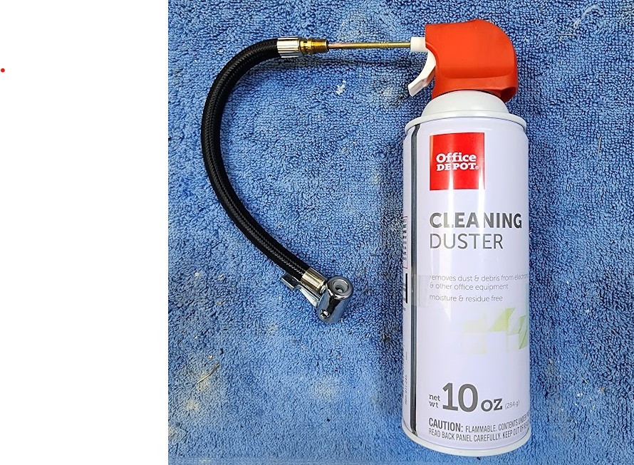

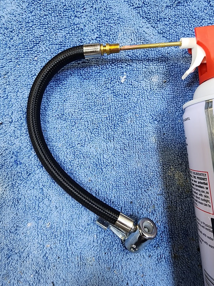

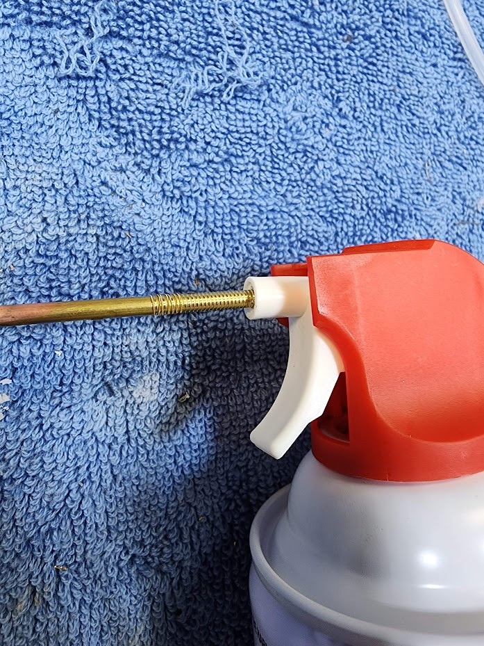

                  Matt, you inspired me!
                  Looking to simplify things and make them a bit more robust, I sourced a pre-made air hose with clamping nozzle and fabricated an end that actually screws directly into the duster can itself. Threaded, it won't blow out and it seals perfectly.
                  This solution was designed for use with the Office Depot duster cans, but might work with others.
                  Now available here for people not wanting to fabricate their own.
