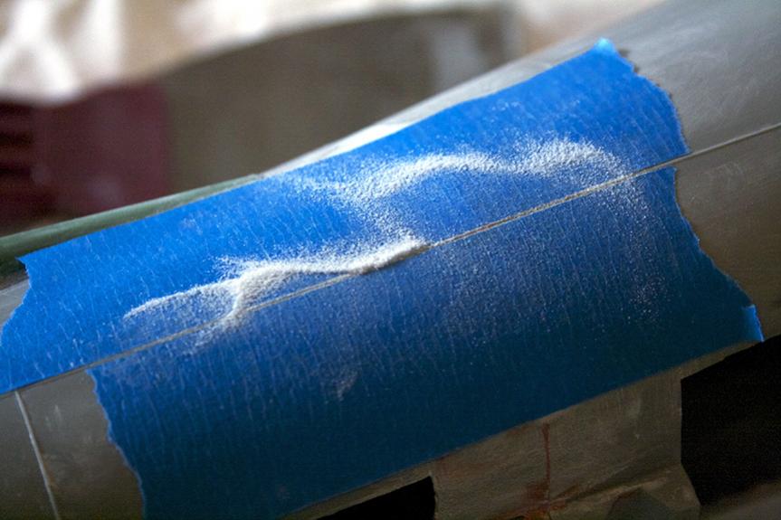

                    Broke out the rattle cans for some gray to check the finish out. Everything looks great... except for the wild seams on the extension... too prominent. Guess I will sand them off and try something else. I thought I read a method around hear somewhere for doing seams with baking powder or something...time to try to find it.
                    Cheers,
                    Dave
                      • 2349

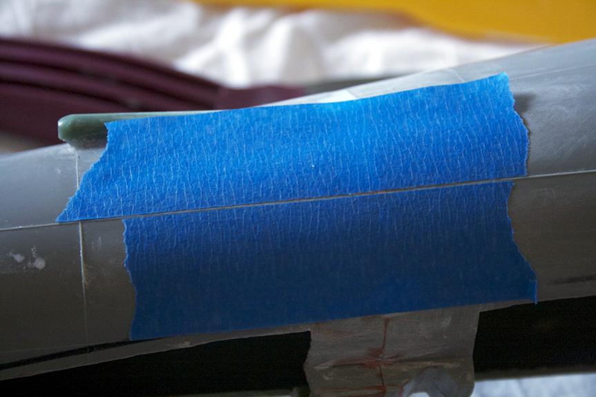

                      #70
                      Get your tape to the width of the seam you want (I found on my Gato, the narrower the better)
                      Spread baking soda into the gap, pushing it into fill the area well.

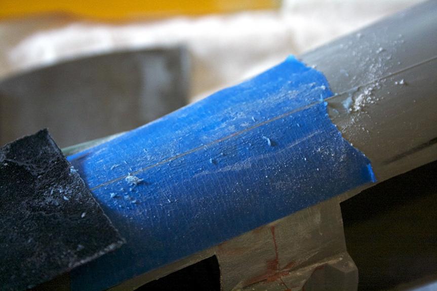

                      Apply CA along the seam

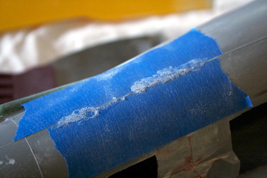

                      Sand the CA off the seam relatively quickly so that it does not get too hard. Sand it as low as you need to. For the Gato the tape thickness worked well.

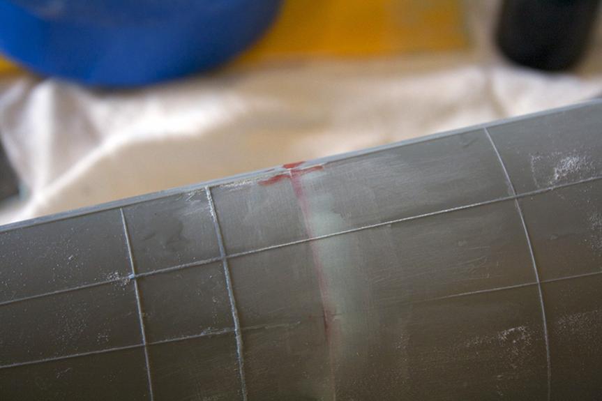

                      The final result
