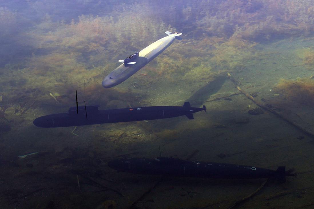

    If I understood Ralph correctly, that a piston is run either fully empty or fully filled, I have a different view with regards to a piston tank (although there are some systems that is done - most are proportional now). If I misunderstood (and that happens to me) ignore my statement LOL. My Walrus, it uses a piston tank, does not run fully filled when submerged (currently at 55% it it just barely buoyant). At fully filled I am at the bottom of the lake (which is cool in shallow and clear water) The goal is to get where last 25% is used to get to various degrees of buoyancy submerged (I am being taught) at 75% the sail should be kissing the surface of the water. This gives you plenty of positive buoyancy if you need it for emergency and enough to adjust your depth. I adjust the piston to get my sub to run at a particular depth. The piston set to full empty and the sub will sit at waterline. I bring it to 56% filled and the sub will just start to dip below the surface. Fill it completely and I am at the bottom of the pond. It is a true static diving system. The Walrus ran for 3 hours and still had power left when we called it quits that day (it was a maiden run). The Akula II will have the same control if you set it up that way. Two people I have utmost respect for and decades of knowledge and experience, both have the Akula II and it runs amazingly well. They can sit still and the scope will be out of the water just sitting there.
    Here is a photo of my Walrus (not painted) with two other piston subs each sitting at their own depth.

          Tom, you are correct about having more piston than needed to surface and submerge.
          The Akula II has a piston that is right at the minimum limit.
          To have the boat submerge and be just a little negative so it will go down to the bottom leaves little to get the boat up to full surface waterline.
          In trimming to get my boat to be slightly negative in submerge trim, I had to give up full waterline by about 3/16'.
          This is fine because in the water, unless you know this, all looks good.
          I would have like a little bigger tank.
          I do have the proportional control over the ballast tank.
          I run with the decks awash as I prepare to dive.
          I then run at periscope depth.
          I stop forward motion and play with sitting on the bottom at about 3 feet. (same place your photo shows your boat with the other two)
