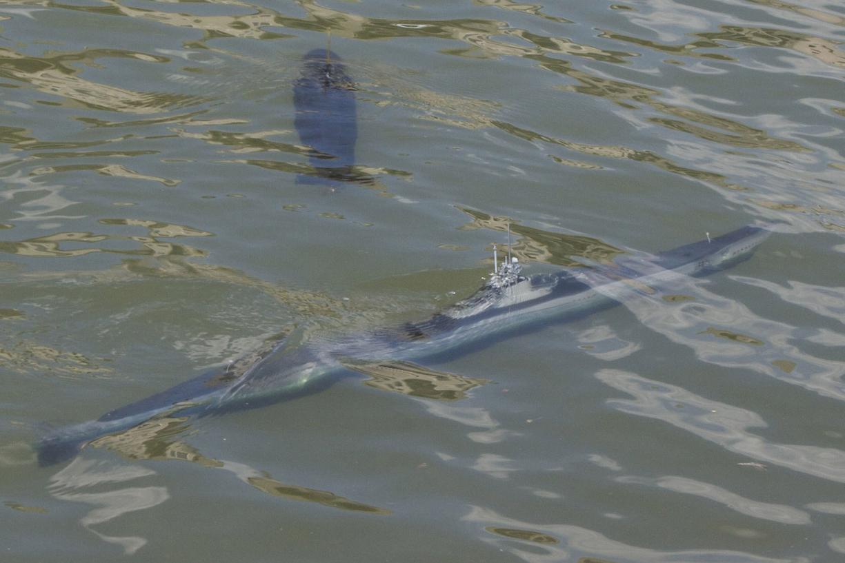

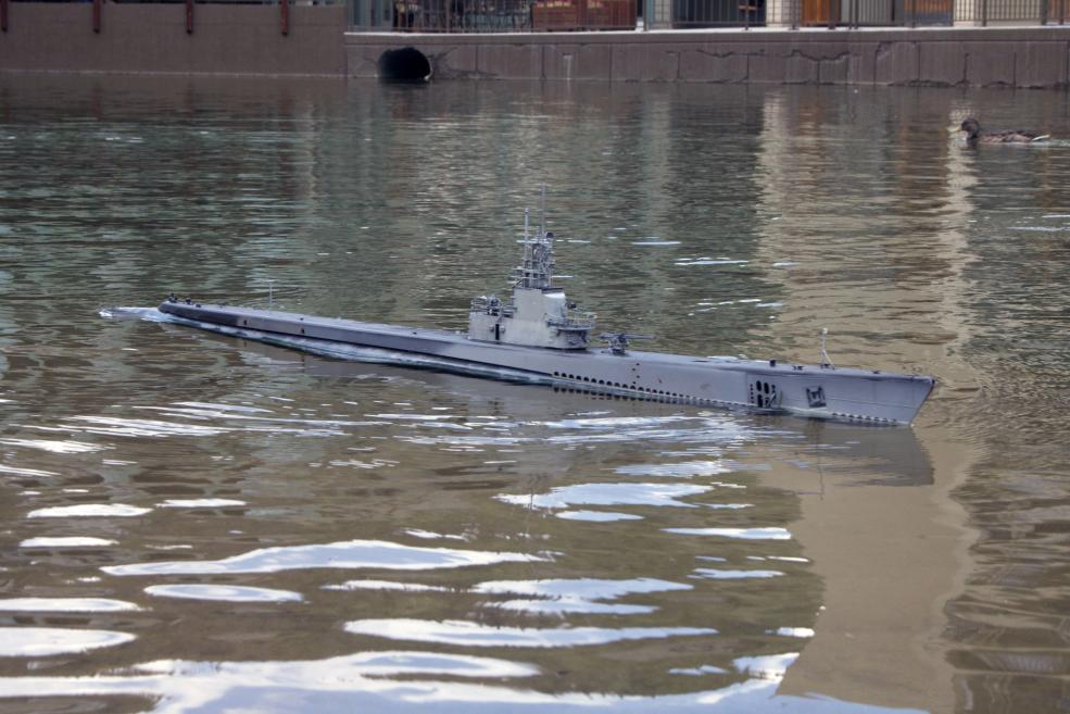

                Only to add to what Bob said, the Gato and guts that he sells was my first sub I built.
                It took longer than a couple of months, but I did more than I needed too and had other life things happen during the build. I love my Gato.
