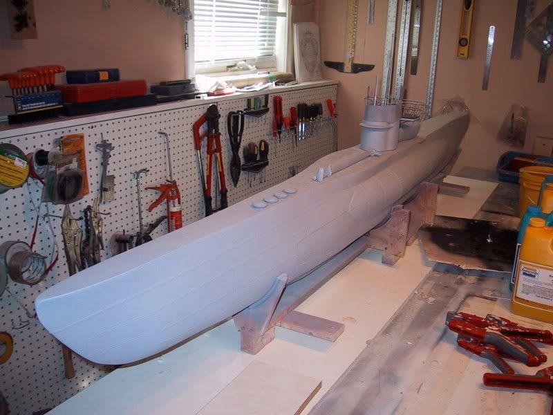

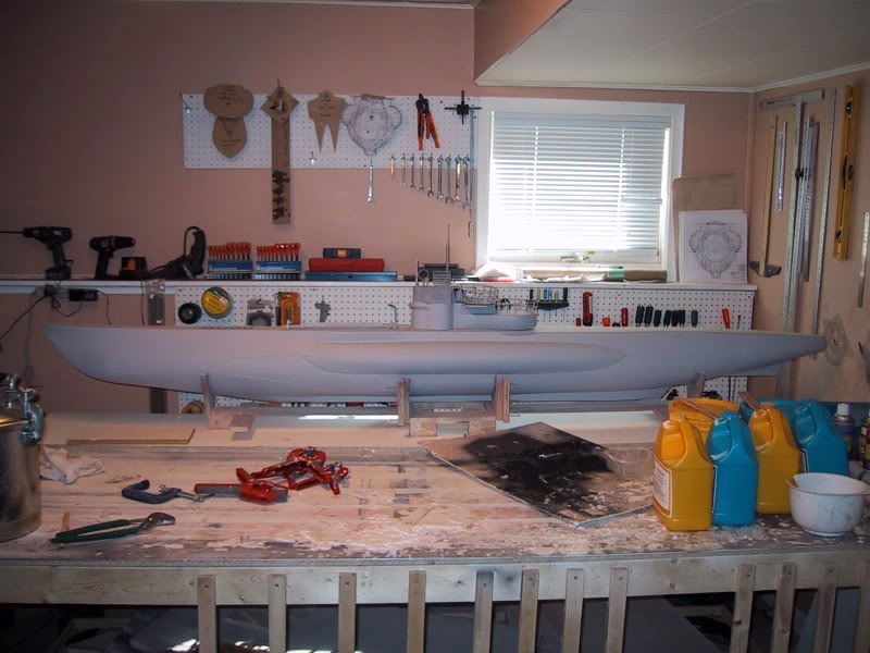

              Yes, you could say I'm making a large boat. It's a Type VIIc/41 U-boat in 1:25 scale, making it 8'9" long with a beam in the 10" range or so. I've got a build thread going on it in the builder's forum. (Three different parts). I've still got my sights set on Christmas for having the model complete....then....comes the WTC.
              That's a 4' "T" square on top of the drawings, to give you an idea of scale and right about where the long arm of that square is situated, is where my WTC is going to go inside the hull.
              Mylo
