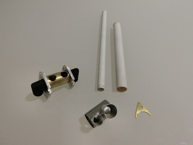

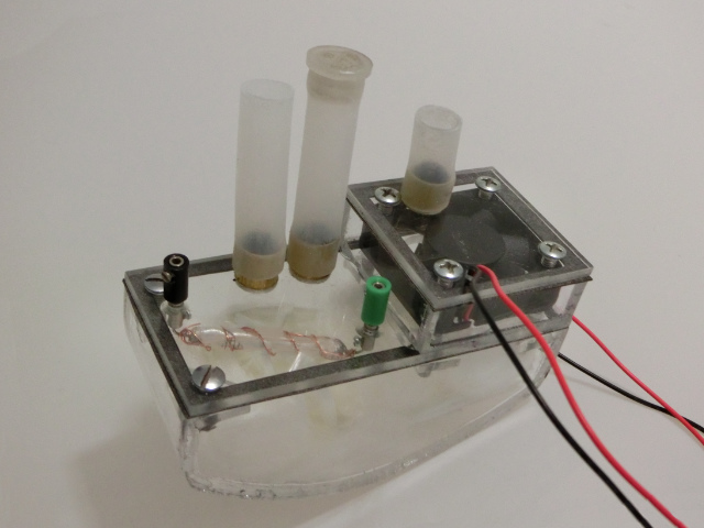

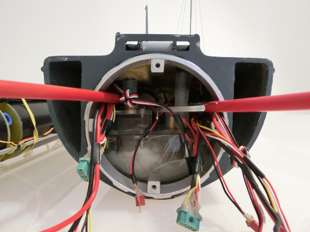

                  If possible could you post a picture of the smoke stack up and down and the mechanism?
ID:	135043Click image for larger version
ID:	135044Click image for larger version
                    Here you can see the chimneys with the tap, the smoke generator and its position in the boat.
