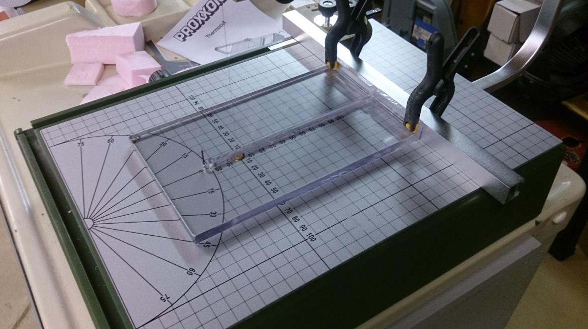

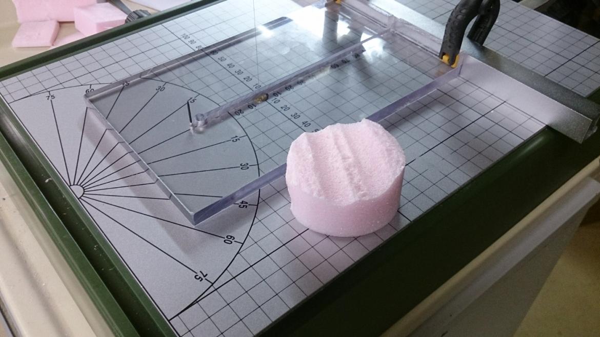

        I ordered one and it's a nice unit well though for simplicity. Foam can be cut in just about all shapes except circles but I made a jig out of some of my polycarbonate sheet I have and fixed the problem. With this cutter I can shave .010 off a block of foam.

                I used a piceof 1/4" poly carb sheet 6"x8" then cut a slit to the centerwith my dewalt cutoff saw
                Then at the center i drilled a hole just big enough to fit a finnishing nail through to hold the
                Foam in place and presto circles.

                      couple of photos of Tom's circle jig
                      as it sits, it will cut circles from 1/2" to 12", and can be adjusted with the block of foam still attached to the jig, allowing you to make donuts.
