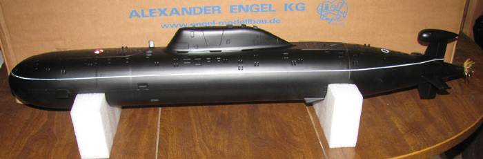

    Engel's Akula II - 1/125 scale
    Rudder modification
    November 2017, I ordered and received this boat from Engel. It took me 21 days to assemble it ready for water trimming. I work no more than 2 hours per day on this kit. It is not a build. It is an assembly or parts pre made and almost pre fitted except some small parts.

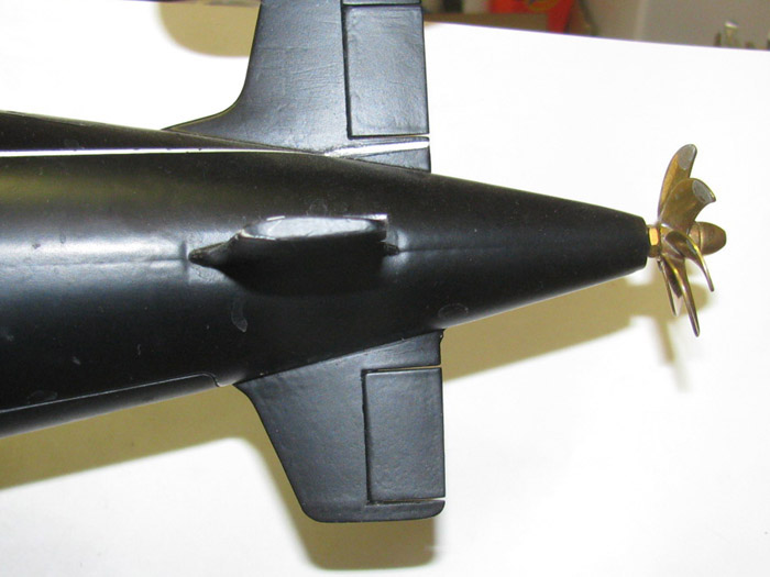

    Here is the original rudders on the Akula II.
    (I am not going to show the first modification. It was not very effective)
    Here is the planned modification.

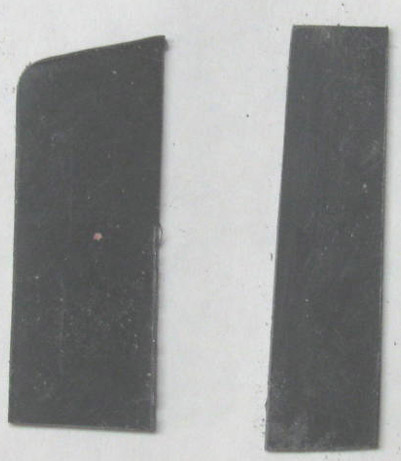

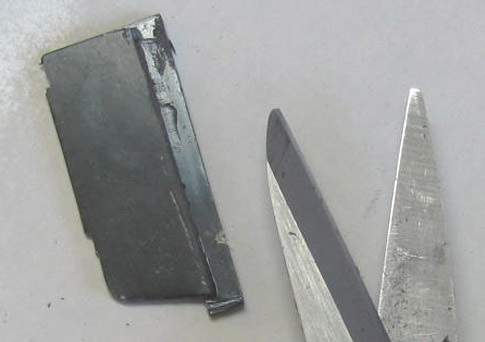

    I cut a piece of plastic in to the shape I wanted to extend my rudder by.
    Rounded off the top to fit the hull curve.
    The other piece of plastic was cut in half to make the fishtail parts.

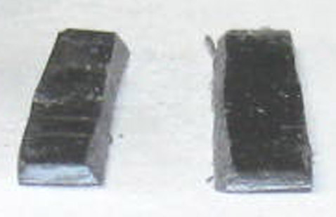

    I started beveling the two fishtail strips.
    Once the bevel was straight and 45 degrees, the strips were cemented to the rudder piece.
    I put a few drops of cement on the part edge and smoothed with a damp finger.
    After it all cured, I trimmed the parts with scissors to shape.
    After trimming to shape, I used a very small round file to shape the fishtail edges.

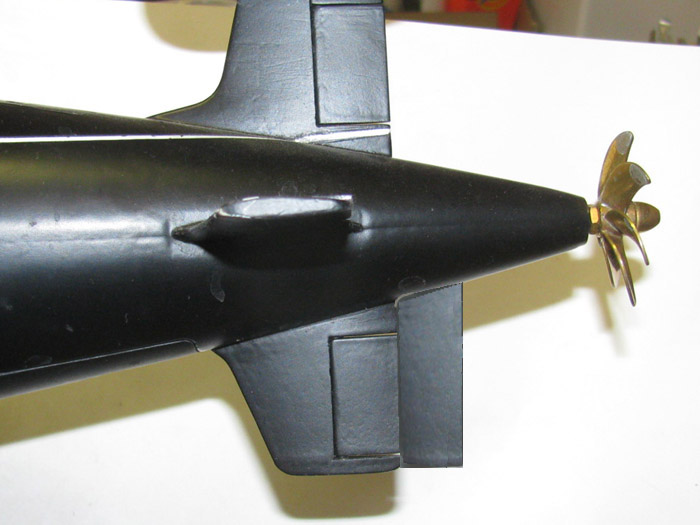

    I used .028" piano wire to drill two holes in the new rudder and matching placement in the original rudder.
    I had thought I would make the rudder extension removable. After looking at it, I decided to mount it permanently. If I wanted to remove it, a razor saw would take a few seconds. Besides, most people looking at the boat do not know the extension is not original to the boat or they do not notice it. No one noticed the 1/4" extension to the rudder.

    First test was running on the surface. Before, to make turns the boat had to be desks awash or the turn was wider.
    Okay, I think something is wrong. I stop the boat to look and see if I have collected weeds on the stern planes.
    Why the boat turned to the right making a 7' radius turn.
    No weeds. Okay, Continue the test. Turn to the left. Same 7' turning radius.
    Stop the boat and trim it at periscope depth. Continue the slow run. The boat turned a 6' to 7' circle. Now turn in the other direction. Same thing again.
    I spent the next 2 hours making small circles in front my chair. Surfaced, submerged at various depths.
    I can not believe how well the fishtail rudder extension works. Something that took me all of about 2 hour to make including glue curing time and painting repair.
    My Skipjack turns a little quicker but not by much.
    Now the Akula II spends more time at the lake. It is a pleasure to run. . . NOW.
    This fishtail rudder extension turns a 35' radius in to a 7' radius.

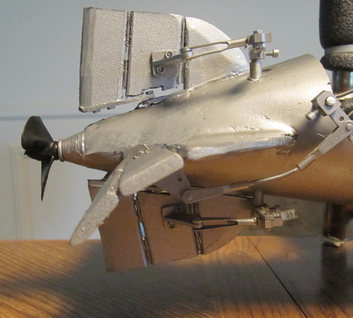

    I had a similar issue with my larger Delphin sub, and tried out an articulated rudder, another invention decades ago on tugboats. On this one, they added a hinge to the rear panel and a simple linkage to make the panel turn farther than the inner portion of the rudder, which gave it more push without stalling the water flow. Here is a picture of my prototype:

    I did a writeup for the SCR on this setup last year, not sure if it is still in the queue, or if it got lost in the shuffle when we lost Jeff. It works out quite well, reducing the space needed for turning by quite a bit - I put it on both the stern dive planes and the rudder.

        The articulated rudder is driven by a single normal rod, and has no extra linkages inside, just an extra linkage on the outside. The amount of extra angle is determined by the position of the pivot in the extra link.

            I see an arm under the rear section going to the center section.
            Is this the linkage that moves the rear section?
            More input on center section causes more pressure on the rear section arm?

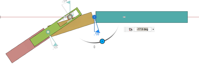

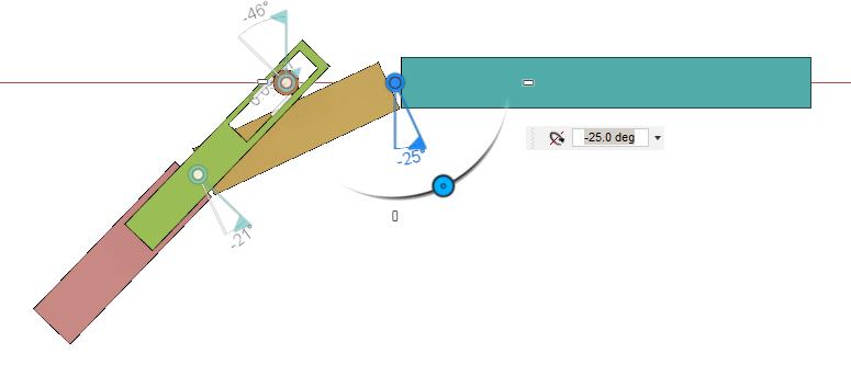

              Here are some CAD drawings I did to work out the dimensions on mine, hope they help. There is a fixed pin under the inner rudder. The position of that pin, front and back, determines how much more the outer panel moves. On my model, I mounted that pin on a little arm so I could vary the distance for experimenting - it could just as well have been fitted to the hull directly. So, here is a view from the side showing all the parts:
              The fixed pin is NOT attached to the middle fin, it is just underneath it. The middle fin is the one moved by the servo pushrod. There are hinges between each fin. Looking from underneath with the rudder centered:
              Now, with the rudder slightly to one side, the outer fin moves slightly more than the middle fin:
              Moving the rudder more, then outer fin starts moving farther than the middle one:
              And hard over, the outer fin moves a lot farther.
              If the fixed pin is moved farther aft, the effect is more extreme. If it is moved farther forward, the effect is less - if it is under the hinge point of the middle fin, it would move the same as the middle fin.
              I did not invent ANY of this, they have been experimenting with this on full size boats for a VERY long time!
              Hope that helps, it is pretty simple to make, and works quite well. It does change the look of the rudder, since there is a hinge seam down the middle of it, but if you nested them it would not show as much as on my crude prototype. I used nylon airplane hinges, glued into slots.
