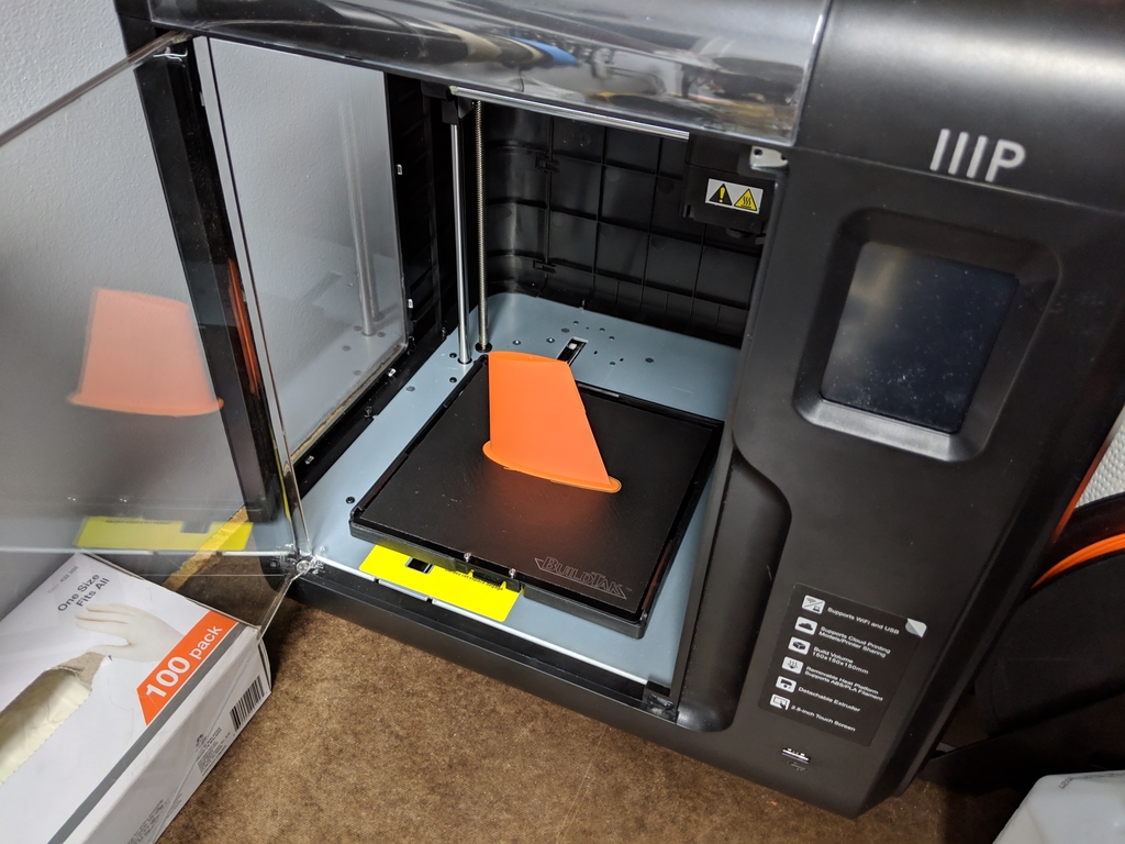

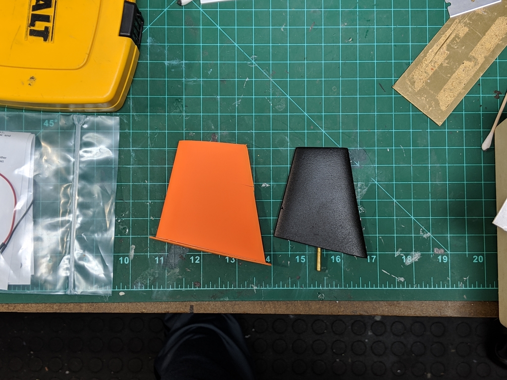

    The attached file was designed to replace the "stock" Dorsal and Ventral Rudders on the 1:48 Scale DeBoer SKIPJACK Class Submarine. It is to scale, based off the G. SHARPE Plans and can be used for either the upper (dorsal) or lower (ventral) rudder. A 1/8" diameter thru hole is provided for the rudder stock. You can use that to feed wires through for lighting.
    It was Designed using TinkerCad online 3D Modeling Tool. I had successful printing in ABS on the Monoprice Voxel 3D printer (rebranded FlashForge Adventurer III).
    It was then cleaned up and used to make a Master.
