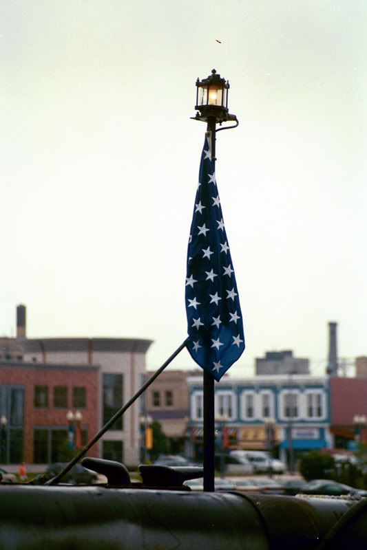

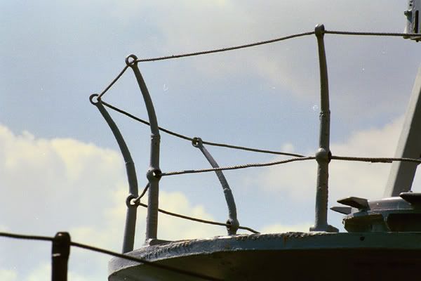

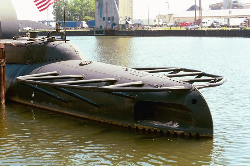

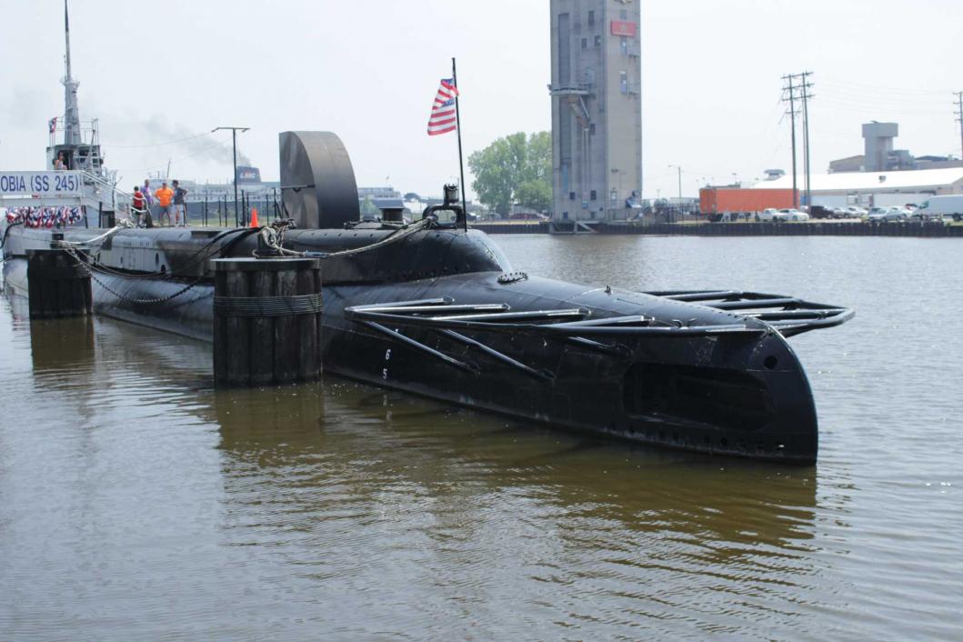

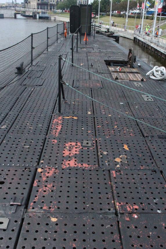

    Hi Guys - several years ago, I made a couple of visits to the USS Cobia - the US fleet submarine that is on display in Manitowoc Wisconsin at the maritime museum there. A number of US fleetboats were built there during WWII and shipped on barges down the Mississippi to the Gulf of Mexico.
    Once the new SC website is up and running, I will post a ton of photos I shot in those visits - here is a sample! If you need a full set of the photos for an impending build, email me (president@subcommittee.com) and I'll give you the info on how to get the full set in high resolution.

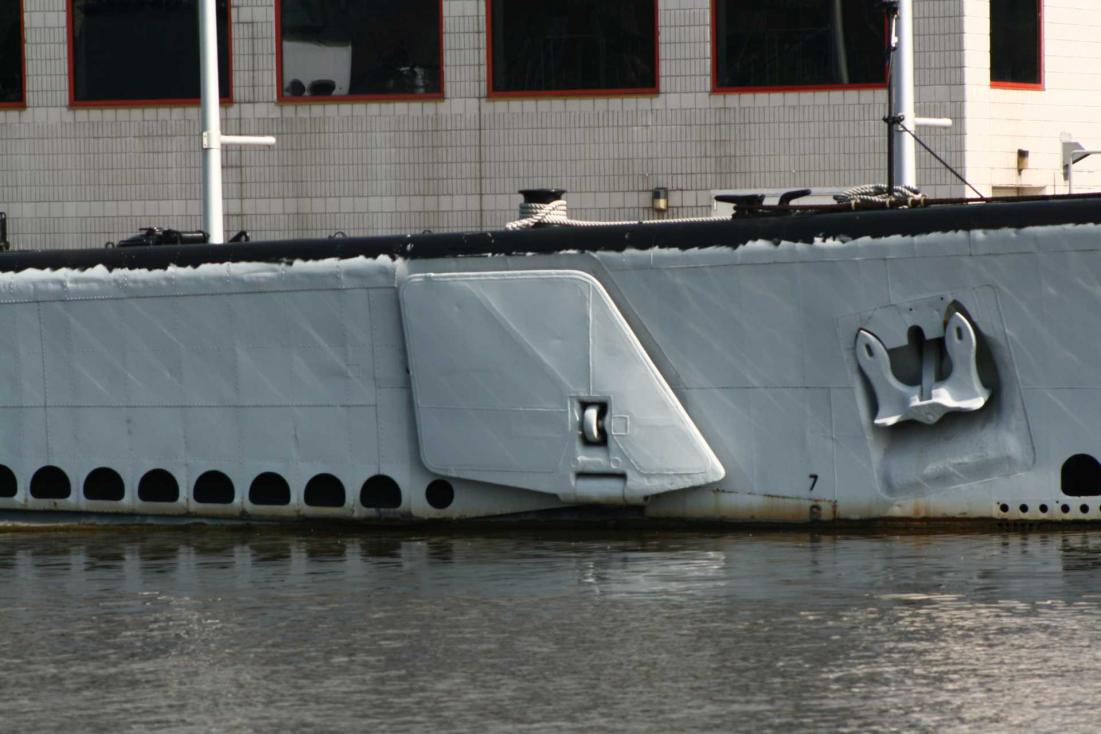

      Tim, Were you ever able to find out any info on the flood /drain port locations on the Gato. I thought it was you who may have been inquiring from BD as to whether it would be better to open the drain holes first prior to cementing the hull halves. Speaking of BD haven't herd from him for a while regarding the Revell Gato build. Regards, Al

          That would be great Tim, I suspect opening the flood holes up prior to cementing the Hull haves together would seem to make the task less difficult. What say ye. Best, Al

              My flood inlets are being
              My flood inlets are being cut with the hull together. I found it easier to mark out their position with both half’s as one. Plus I was concentrating more on the cylinder installation than doing this job. But it has to be done. BD.

                Guys
                The drawing that you need is a Docking Plan, this shows all of the hull openings that are below the surfaced waterline of the subs,
                The Floating Drydock sells this drawing in 1:48 scale at a very resonable price.

                  Ballast tank floods
                  I just got a test shot of a vinyl overlay from Nautilus Models that has the correct placement and shape of the ballast tank floods for the 1/144 Trumpeter Gato. A set for the Revell 1/72 Gato is not far behind. This template would be placed on the actual model and used as to open the flood ports. It also has the correct openings for manhole covers, etc. Also come in Balao & Tench flavors, Will be out soon.

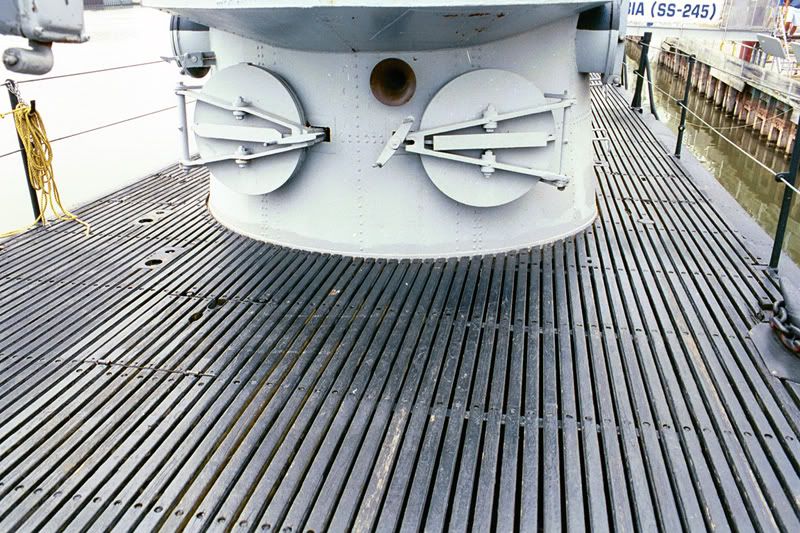

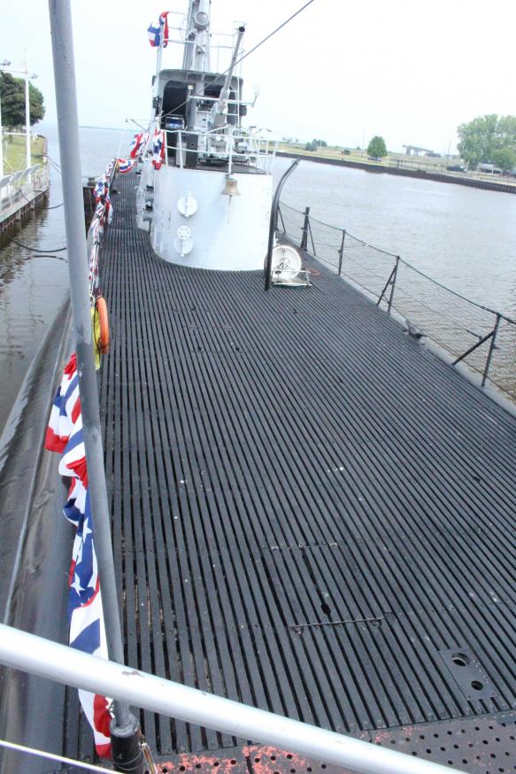

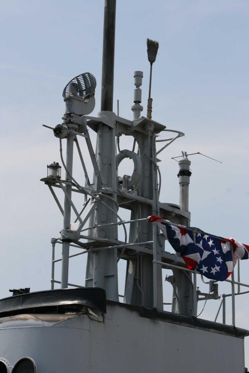

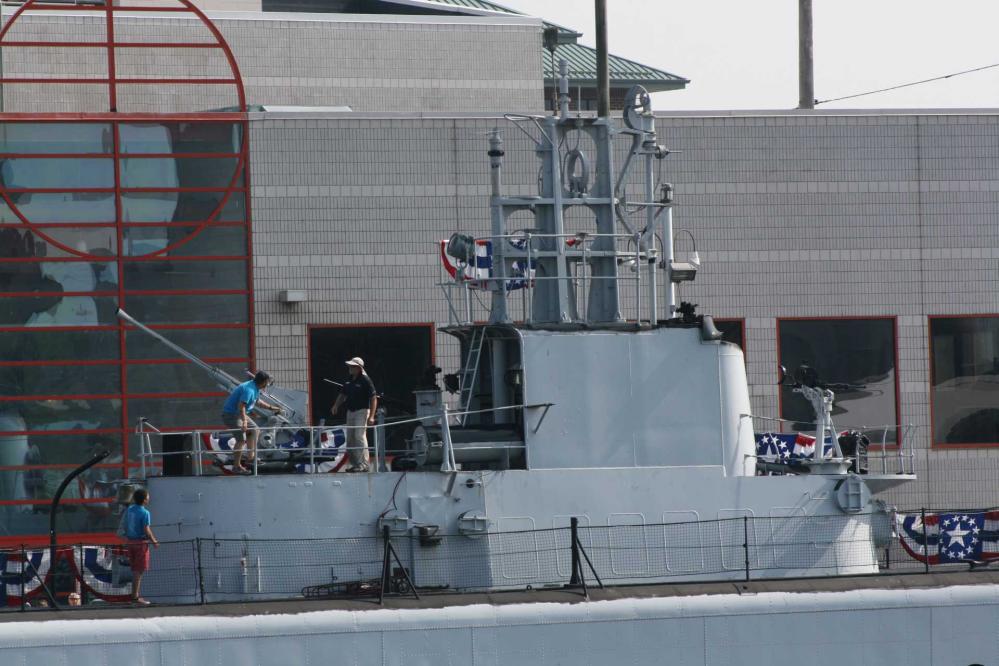

                    Uss cobia, 2015
                    A few more shots of the USS COBIA, ready to go for next years SUBFEST!
